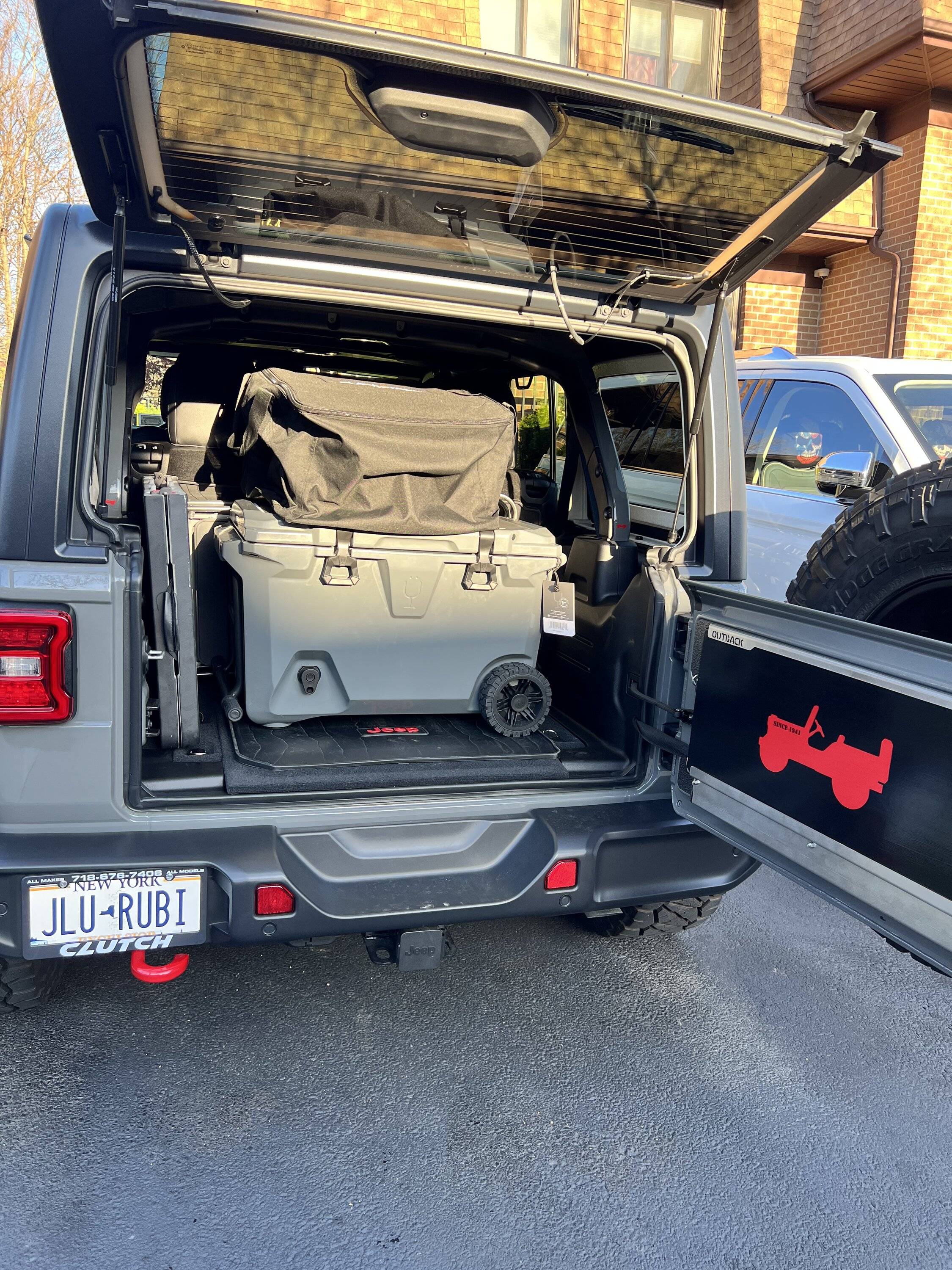

I have this as well. Fits perfectly.
I'll agree on the Rtic 45. I have a 65 qt. and after filling up Friday there's still ice and plenty cold when I get home Sunday afternoon. I impinge a 45 qt. would fair even better with less space to cool.
