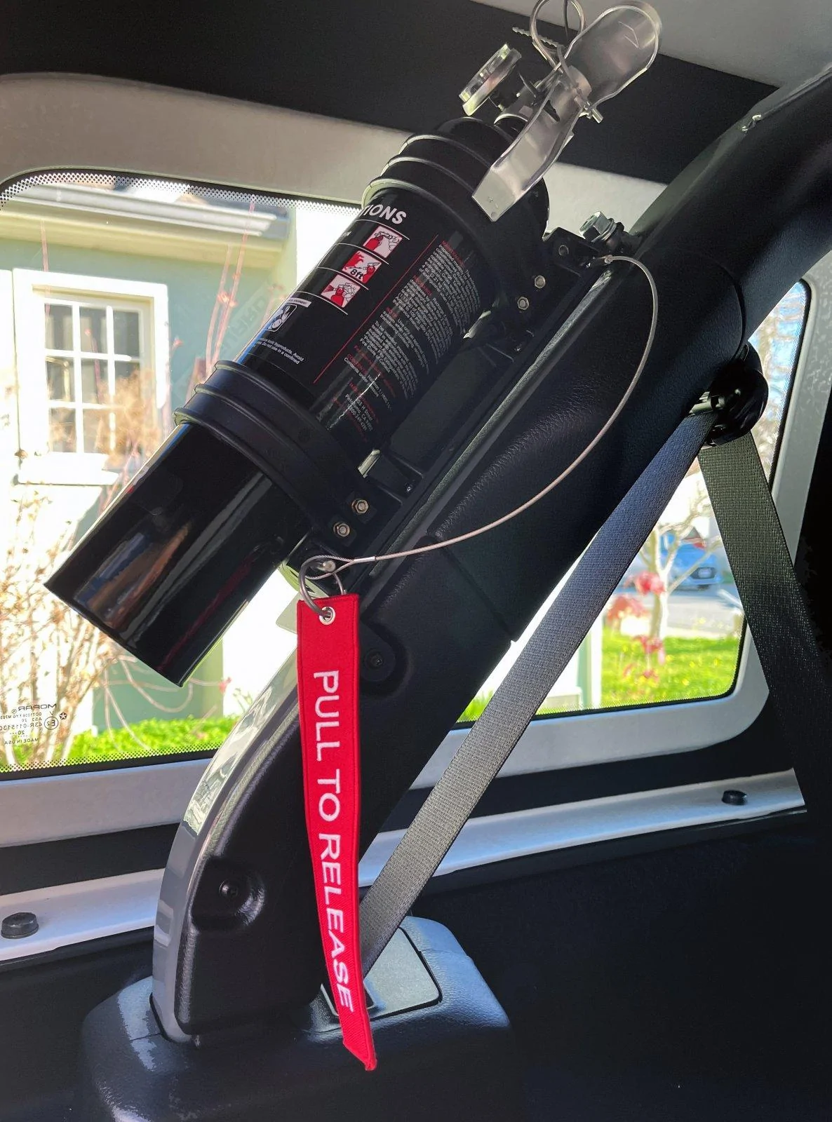

I purchased one for Father’s Day. A few things. The cool tech bracket is just a metal plate that creates a flat surface for the NB300 mount. It attaches via a bolt but you do have to create threads with a tap. So you still need to buy a tap and some cutting fluid.
Once it’s in it is very solid (Unlike Velcro) and rattle free (unlike the metal brackets like drake).
H3R recommended the Cool Tech bracket, which was bundled with the NB300 mount, at a good price. Had to go out and buy the tap, and watch a YouTube video on how to do it. Used a few sprays of WD40 and had no trouble. Very clean, and as you suggest, VERY solid. H3R and Cool Tech were a great match.

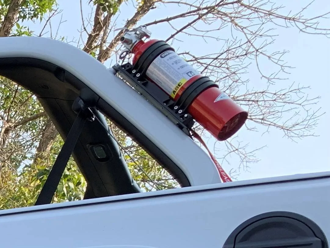

i've been trying to talk myself out of buying the black version because i love how they look, but am probably going to cave and get the red one because that's what most people would be looking for.
that black one sure looks great though!
