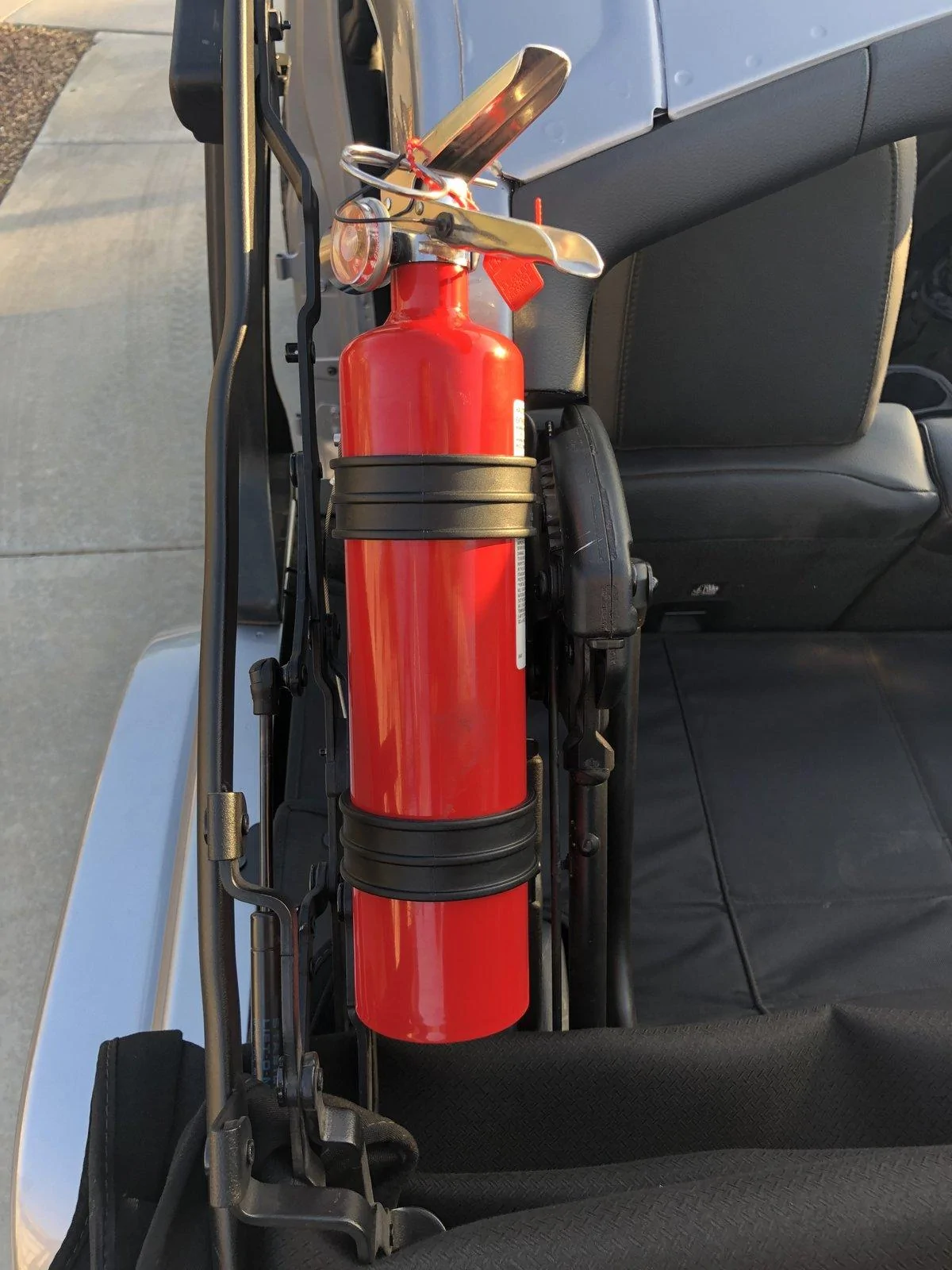

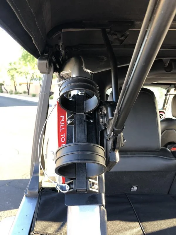

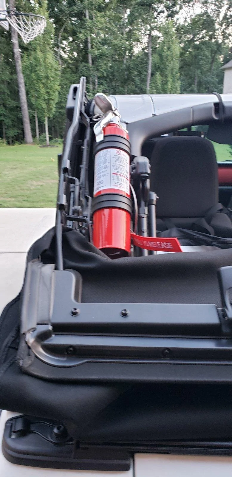

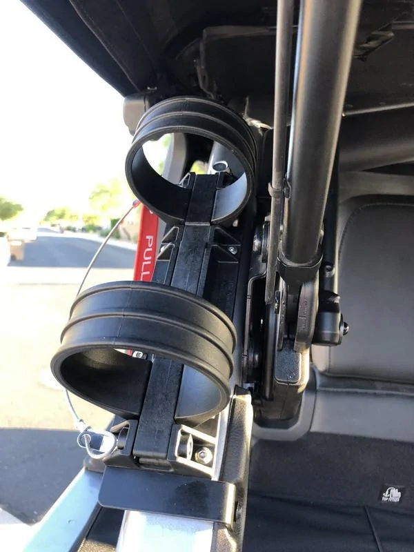

Thanks to Brew211, we now have confirmation that our mount will work for both Hardtop and Soft tops. When the Soft top is in the up position, there is plenty of clearance. When the soft top is down there is still clearance but you can make contact due to side to side flexibility of the top. It shouldn't be an issue at all as the mount is very rigid.
Attached are a couple of pics Brew211 sent us.

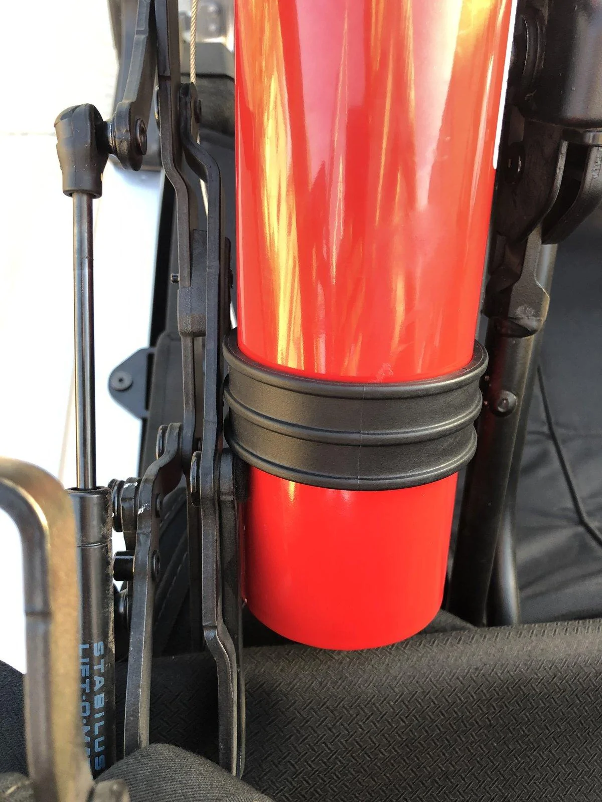

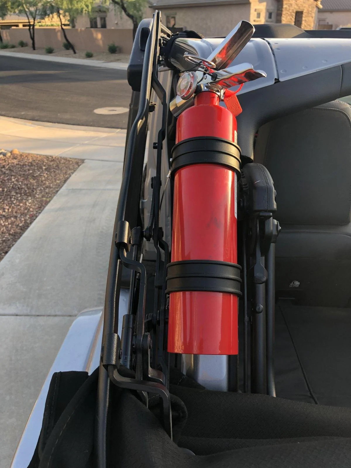

@CoolTech , thanks for the shout-out!
I installed a 3lb extinguisher on your mount and it works perfect on both my soft top and hardtop. The extinguisher needs to be rotated about 45 deg in the mount so the soft top braces won't hit the extinguisher lever when retracting the top to the down position. Once in the down position the bracing does rub and slide on the lower part of the extinguisher (below the bottom extinguisher mount as seen in the photo below) but it does NOT harm the bracing as there plenty of 'play' in the soft top. The soft top lockout lever still works and the top does not have any movement when locked out. I am 100% confident the little contact the extinguisher has with the soft top bracing will not be a problem. I would recommend this product to my friends.

Is that just a standard 3lb or one of the h3r ones? Was curious if only the h3r extinguishers fit

I put in a non-H3R extinguisher and fits great. I believe its any 2" extinguisher.
Non H3R halotron extinguisher. Any one will work, it just has to be 3" in diameter.
