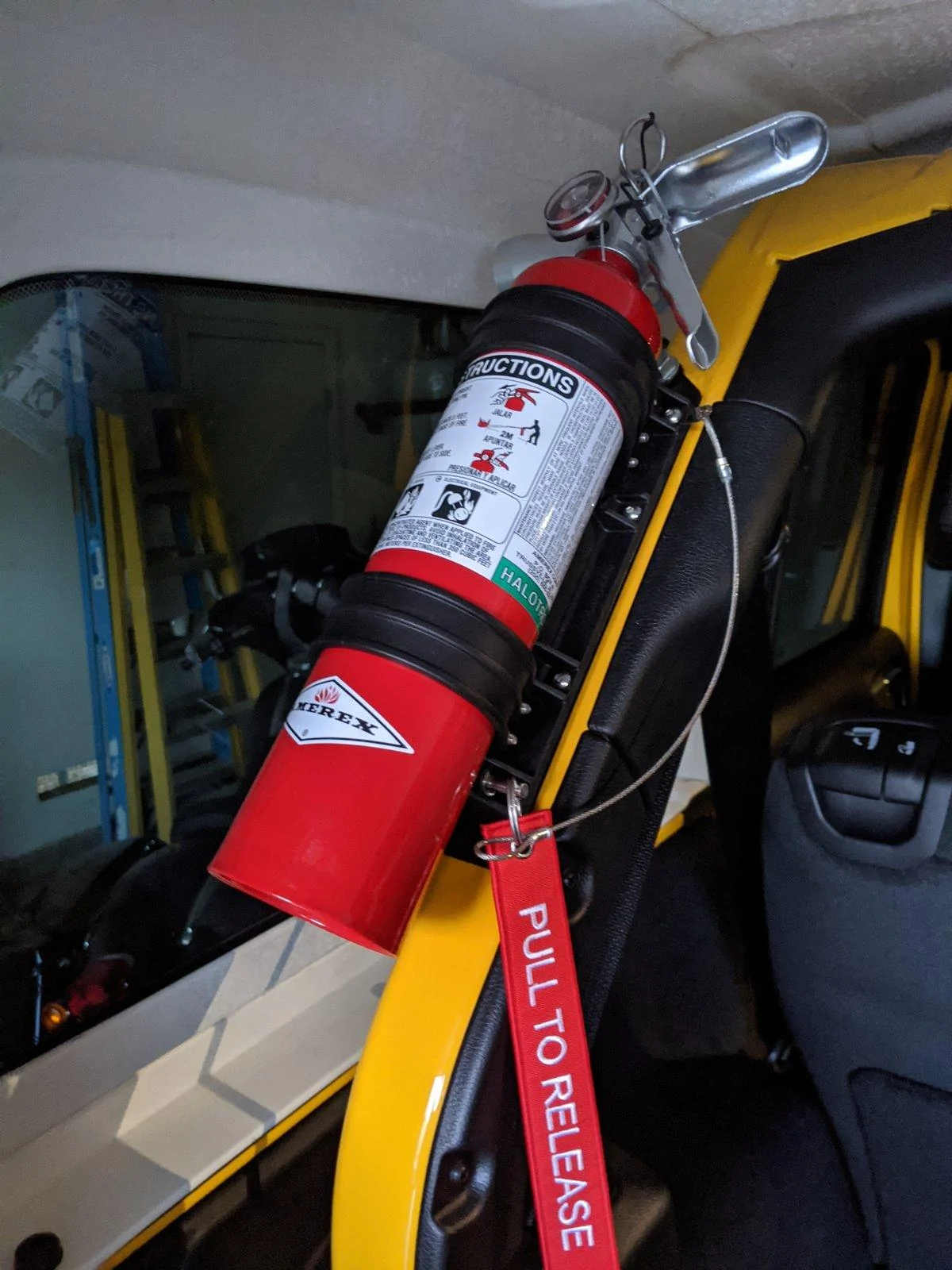

I purchased one for Father’s Day. A few things. The cool tech bracket is just a metal plate that creates a flat surface for the NB300 mount. It attaches via a bolt but you do have to create threads with a tap. So you still need to buy a tap and some cutting fluid.
Some tips. I would encourage folks since there is only one screw supporting the weight of this thing to use blue threadlocker on it. Don’t want that puppy flying loose in a crash.
Second note very carefully the screws to affix the bracket to the plate screw into the plate. If you go from plate to bracket it looks like they are holding the bracket on but that thing will pop right off. Not that I totally made that seriously stupid mistake and had my extinguisher fall into my trunk. Totally didn’t happen. Not at all. (Yes it did). So just make sure screw goes through plastic bracket and then into the plate. Not the other way around.
Getting the mount into the extinguisher requires a lot of muscle so have fun with that
Once it’s in it is very solid (Unlike Velcro) and rattle free (unlike the metal brackets like drake).
Could cool tech improve it. Yes. Include the tap, packet of cutting fluid, and a vial of blue thread locker.
