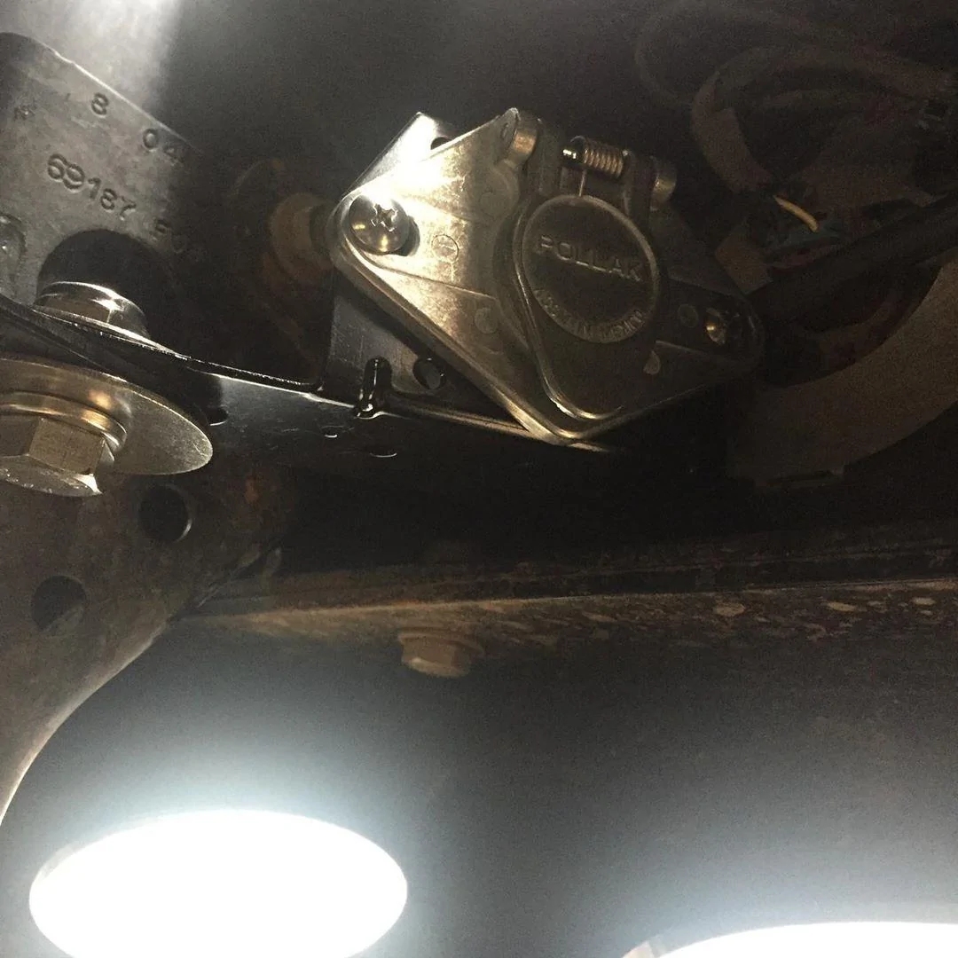

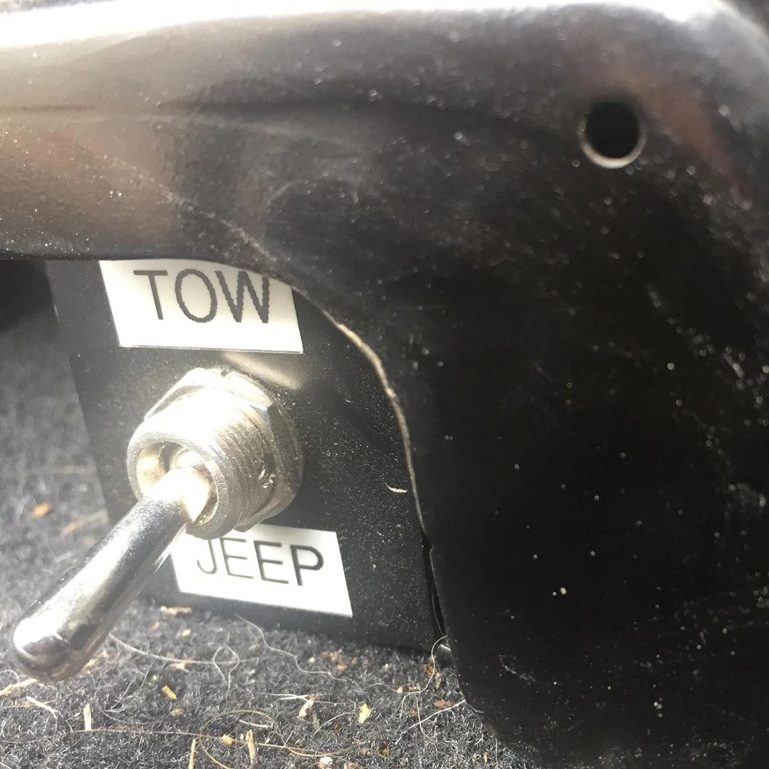

Finished all of the wiring and install of the @CoolTech Towing Harness Kit. Nice easy, clean install. So if you want to tow your Jeep behind of an RV, here is a great solution!!!
I decided to tuck the 6 pin socket behind my Poison Spyder bumper to keep it safe and hidden from rocks and obstacles. Just need to run the connection cable through the skid plate holes and plug it in. Flip the switch, good to go!!!
