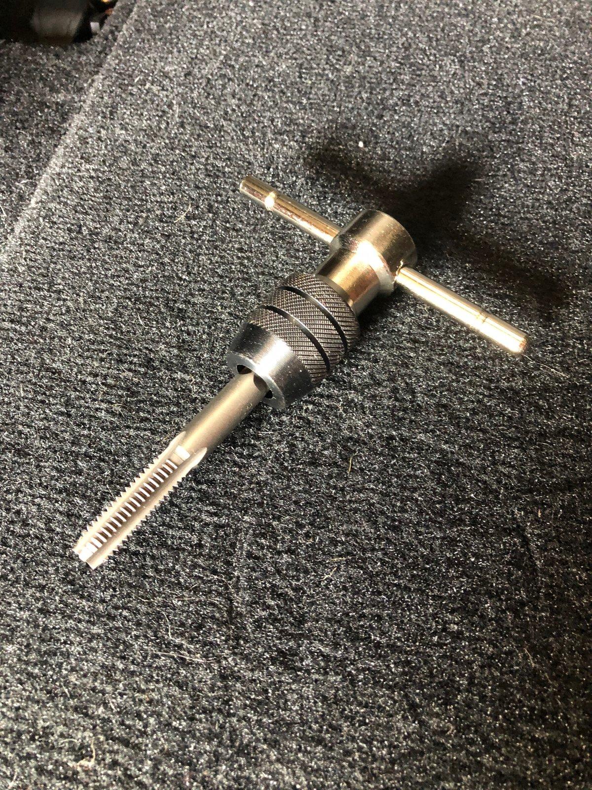

Just received my kit yesterday and will be installing over the weekend. The bracket looks great! Will update with pics once installed.
Not sure if I should get a tap for the top bolt or just try to ratchet the self-tapping bolt in. Your instructions mentioned an impact driver to put the bolt into the unthreaded boss on the roll bar, but all I have are hand tools. A tap is around $5 so I'll probably go that route.

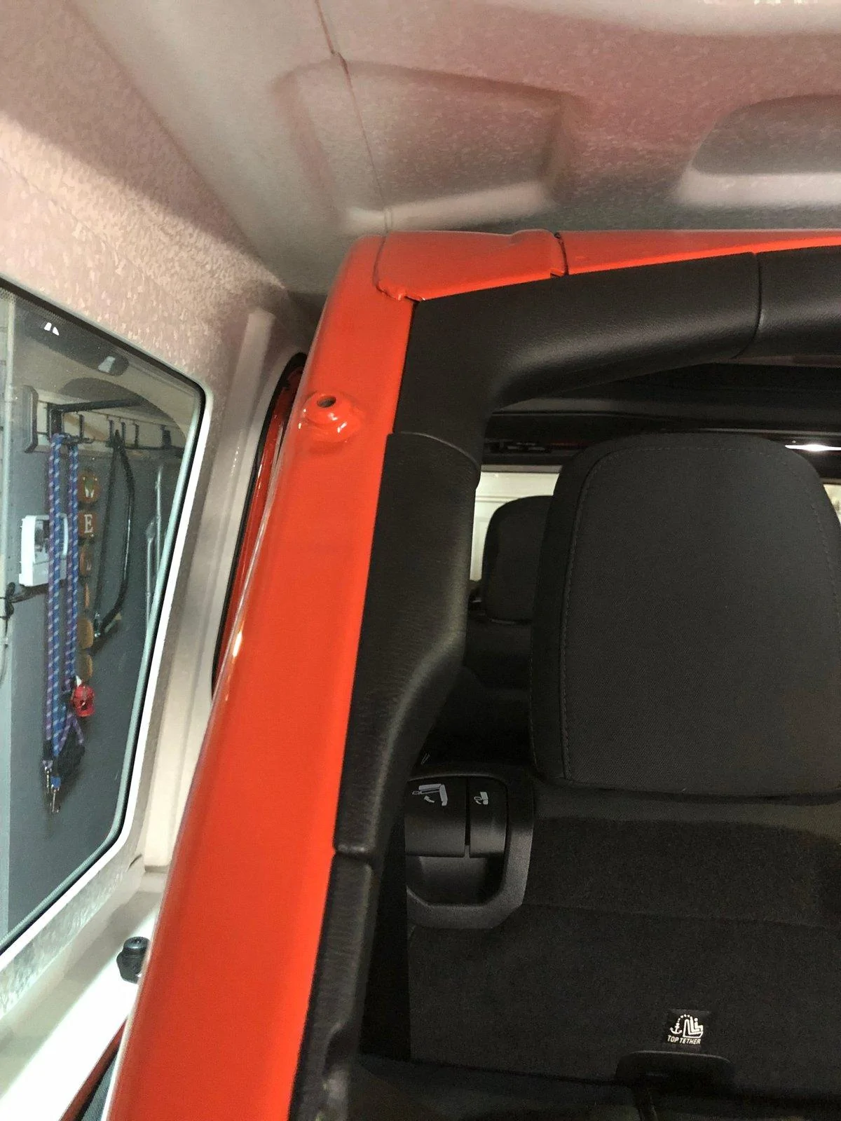

Yeah, good ol' fashioned tap is what we used. 3/8-16 is the size. It is very common - readily available at Home Depot or other hardware stores. You just need a few turns, nothing hard. No pre-drilling is necessary. The ID of that boss is 5/16" which is the drill size for 3/8 -16. Note that if you ever decide to remove the mount - that boss will just be threaded - no big deal.

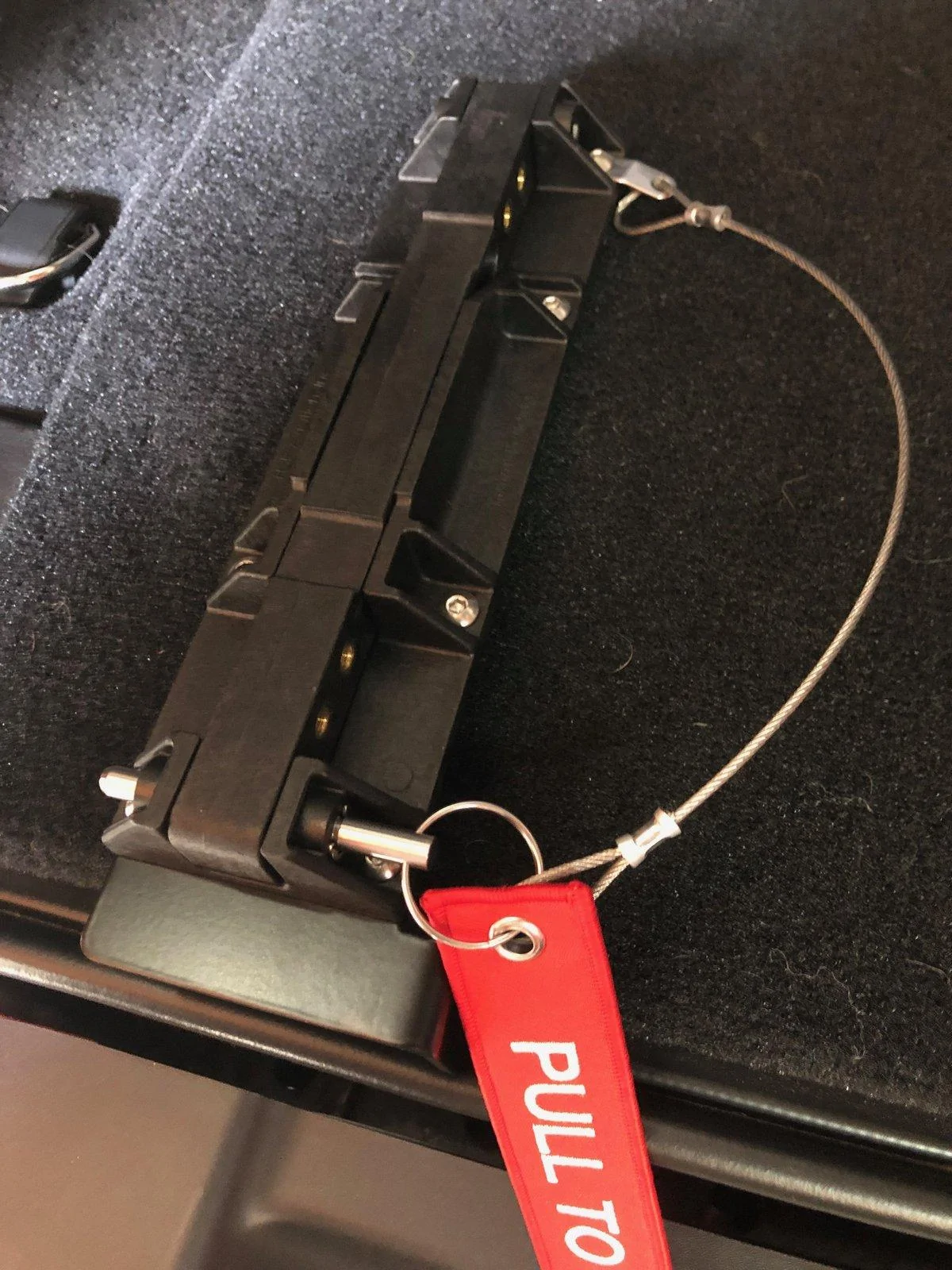

The bracket itself is elevated above the roll bar and uses a small rubber bump stop near the bottom to supply additional support. The trim screw in the ear of the bracket simply keeps the bracket from twisting and, because of the bump stop, is not carrying a load.

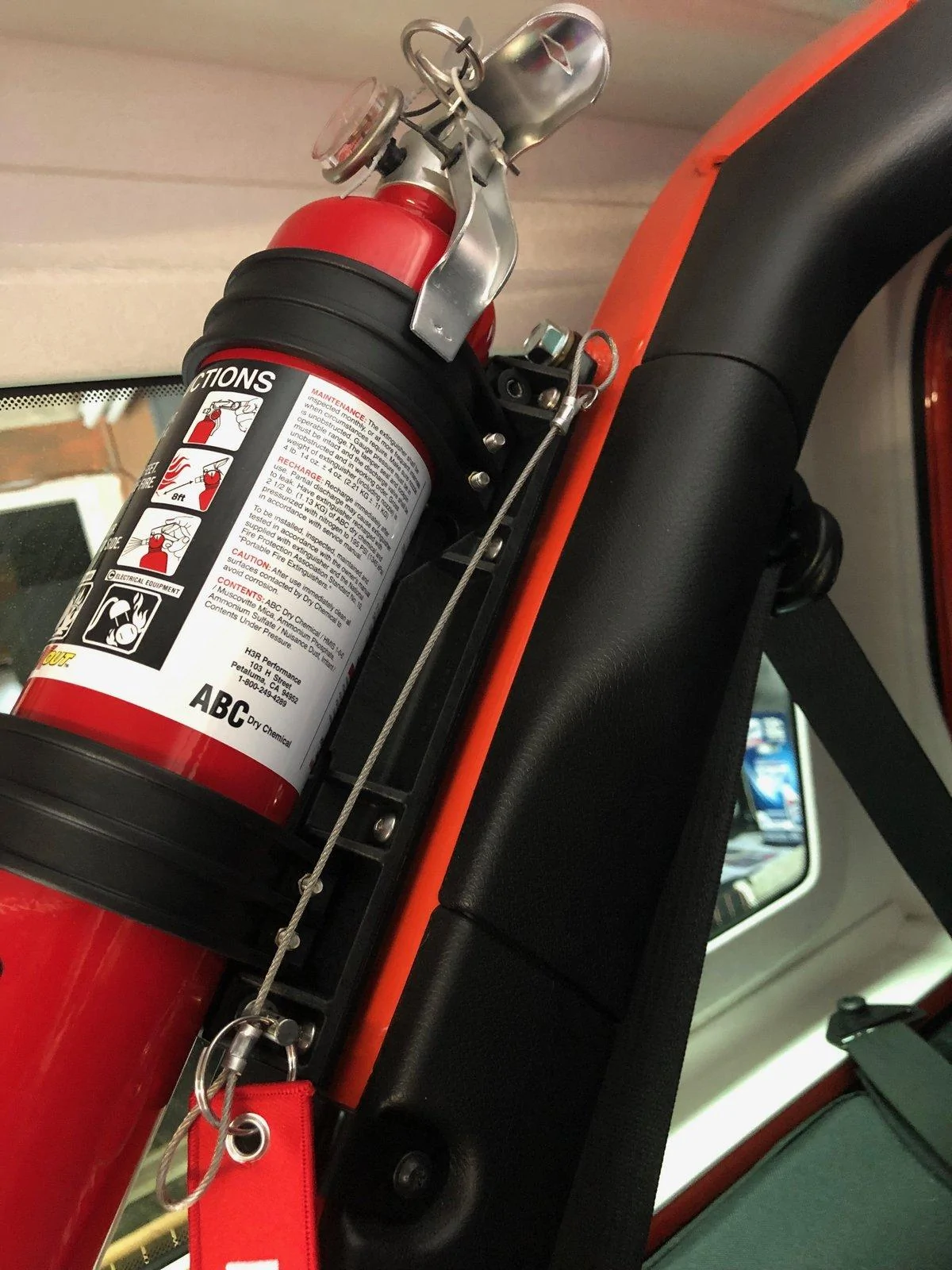

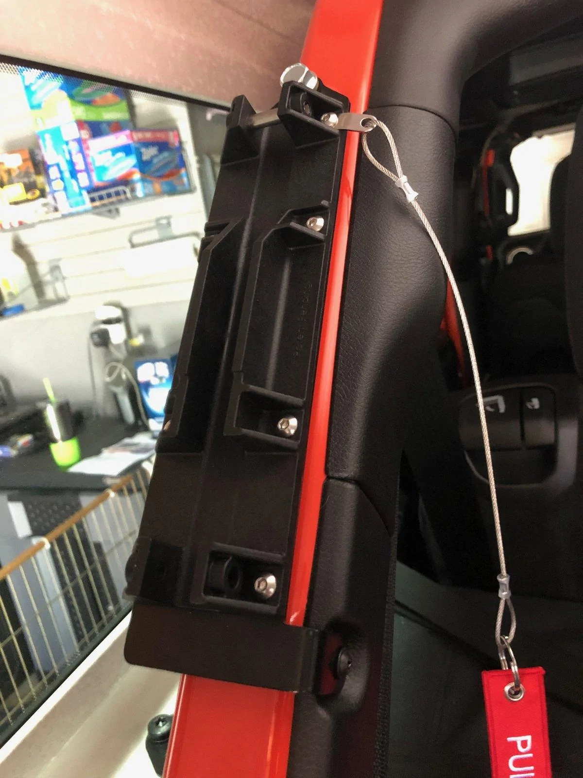

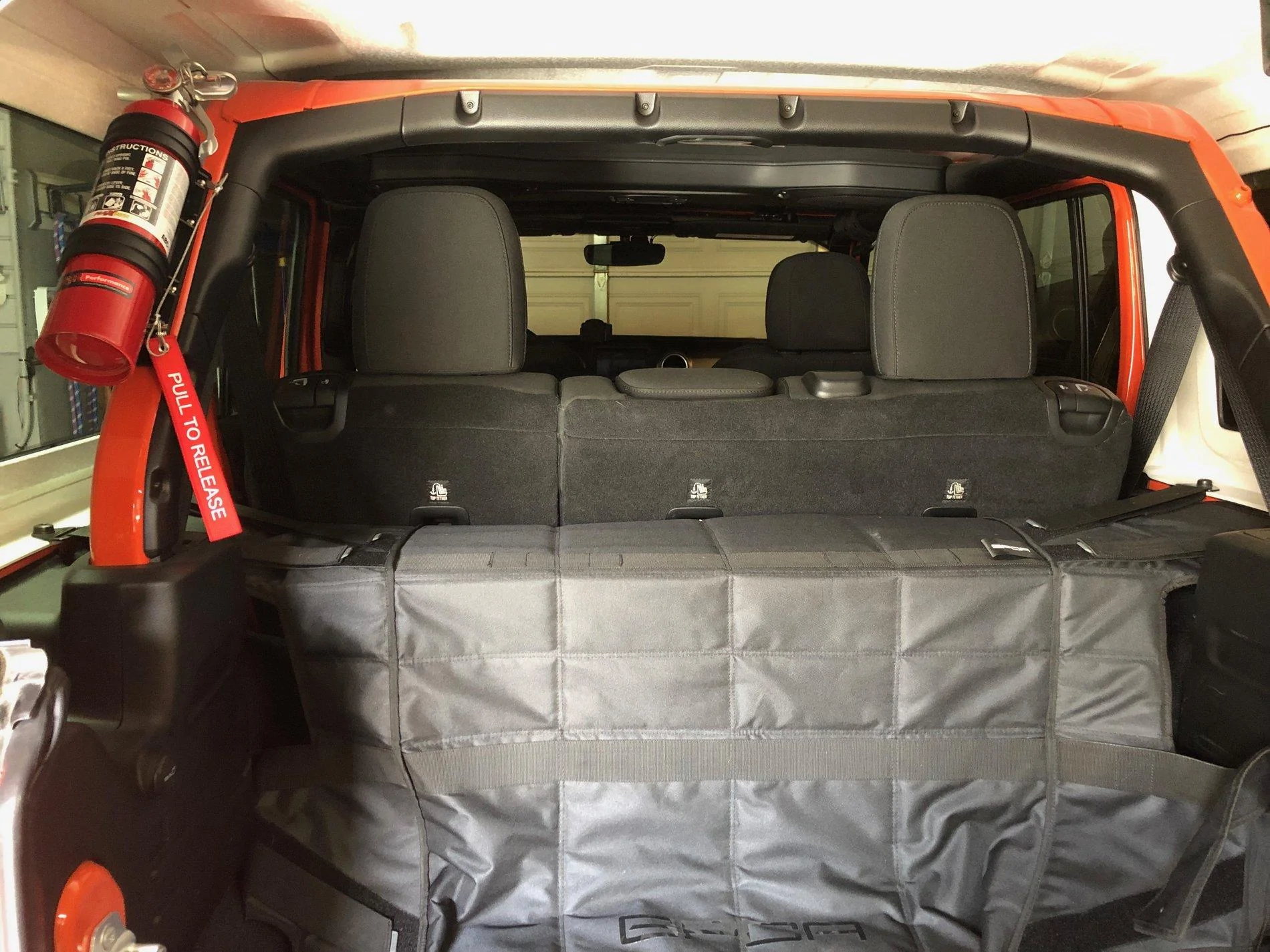

Installation complete. Very straight forward. I did get a 3/8-16 tap to thread for the top bolt but that was super simple. Very clean design. The roll bar bracket fits perfectly, both to the H3R mount and to the roll bar. The mount is very secure. The lower bracket that secures the bottom is there only to anchor it, the weight is supported by the rubber cushion on the bottom.
I haven't driven it yet, but don't see how this can cause any noise or rattling.
Highly recommended.
(Sorry, hard top here, can't address fitment with soft top.)

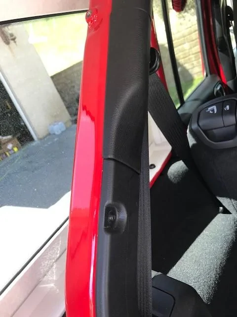

MandKM - have a look at the picture below depicting the two mount points on the 4-door. Take a rough dimension of the line between the center of the boss and that trim screw. If the dimension is ~11.25", then it is the same as the 4-door. If it doesn't fit/work, we'd give you a return label and a full refund.

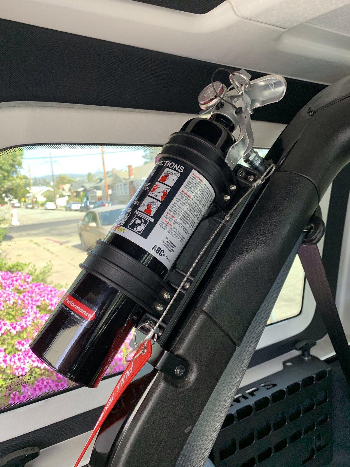

I got mine installed today. A word of warning to folks: don't bother with the self-tapping bolt. It destroyed itself trying to tap the mounting point, so I used my own tap to cut the threads. If you don't have taps, get one before you try and install this mount.
I had to add a bunch of washers to mine as the bolt I had was too long. I'll probably come back at some point with a shorter bolt, but with the blue loctite, I don't expect it to go anywhere.

mikej - Thanks for your feedback and install pic. We also recommend the 3/8-16 tap - readily available from Lowe's, Home Depot, etc. The "boss" that you will tap does not require any pre-drilling. Trying to get the supplied "self tapping" bolt to go by hand will not work, however, we have seen shops install with a drill hammer/driver. Our preference is the tried and true tapping method although it takes a few more minutes.

Y'all might want to remove the self-tapping bolt from the kit and instructions, then. It was frustrating and a waste of time to try and use it.
I used an M10 x 1.5 tap, because that's what the self tapping bolt measured out to and it had already cut a bit because I had tried using it, because it was included.
