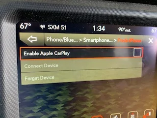

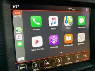

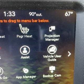

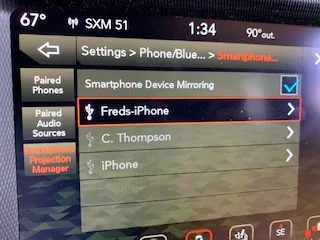

I just got mine to work after a week of trying every suggestion. I have an iPhone XS Max and was current on the iOS 12.4 when CarPlay stopped working. I pulled fuses including resetting the radio. I tried new cables. I switched USB ports. I updated my iOS to the beta 13.0 version (I am an Apple beta tester) still nothing. I checked the iPhone phone Settings/Screen Time/Content & Privacy Restrerictions/Allowed Apps/ to ensure CarPlay was enabled on the phone.
I got it to work a few minutes ago with this: On the touch screen on my Jeep under the Apps menu/Projection Manager/Smartphone Projection Manager/ (choose your paired phone) I found that "Enable Apple CarPlay" was NOT checked. I don't know if an over-the-air firmware update changed this setting but as soon as I checked the box and chose connect device my plugged in phone to USB2 immediately launched CarPlay and defaulted to my music playing.
This is what worked for me. Smartphone Device Mirroring somehow got unchecked.
