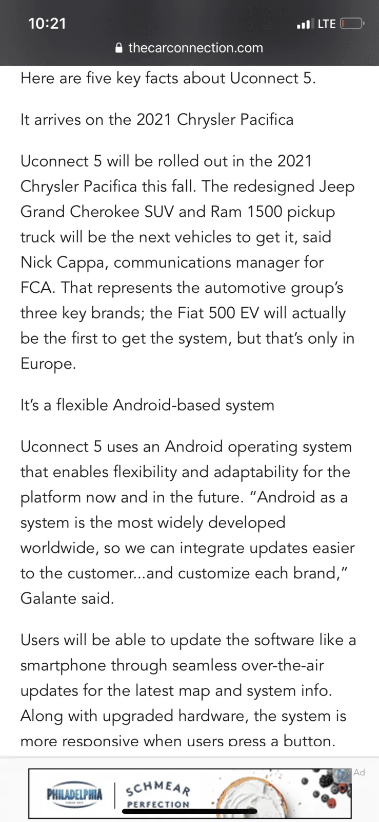

Article From some online searches :
I dug a little deeper on Google as well and can’t find any evidence that they’re going to offer UConnect 5 in any 2021 Wranglers contrary to what JeepCares mentioned earlier in this thread. I wonder if they’re going to offer it in models that are launched later in 2021 like the 4Xe or other rumored special editions.
