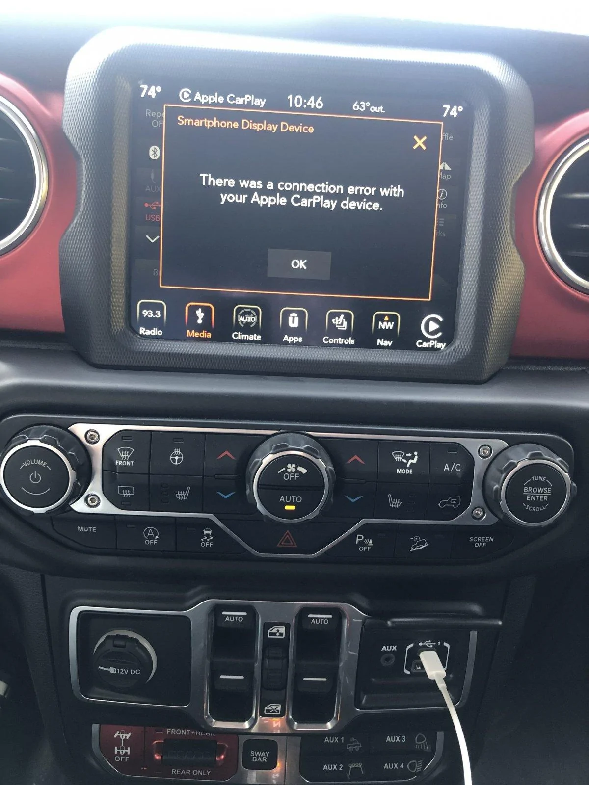

I would follow up with JeepCares.
I am STILL having CarPlay issues, but they recently helped me get one of them addressed.
I was having two issues, CarPlay would intermittently turn on and off and on and off and on and off as if the cable was loose. Also, CarPlay would crash and not come on again for 12 to 24 hours.
they help me convince the dealership to replace the media hub cable and the dealer told me when they inspected the old cable it had a break in it. I was very happy to hear that because it made such perfect sense based on the behavior.
One problem solved. Now hopefully they can help me solve the other problem. I will paste some of my recent experience below incase it helps identify the problem. I just want this to work!
when I plugged in my iPhone 8 Plus running iOS 14.2 nothing happened. Carplay did not start. Needless to say I was disappointed. I tried another similar phone and then an iPhone 11 and these did not work either. I waited 24 hours and tried again. This time CarPlay worked for my iPhone as well as the two other phones. I left the vehicle running with CarPlay working. I started the applications Waze, Spotify, and an audiobook app from audible.com. Everything seemed fine for about five minutes but then the radio touch screen froze becoming unresponsive and after about five or 10 seconds it stopped CarPlay reverting to a previous screen and CarPlay would not restart. It continued to charge the phone though. I then tried the other 2 phones but they did the same thing, CarPlay would not start but the phones would charge. I then changed from one Apple OEM cable to another Apple OEM cable but the result was identical.
Then 12 hours later I tried again. This time my iPhone started CarPlay again and it continue to work for about three minutes. After three minutes the radio froze again stopping the audiobook that I was playing. About 20 seconds later an error message showed on the screen and I have attached a picture below. The message read “there was a connection error with your Apple CarPlay device“. When I touched OK to clear the dialog box the radio resumed normal function except CarPlay was not available. My phone was still plugged in and it showed that it was still charging.
K-nuk
Jun 30, 2019
185
172
JLUR, CJ7
Here is the screen error message...
