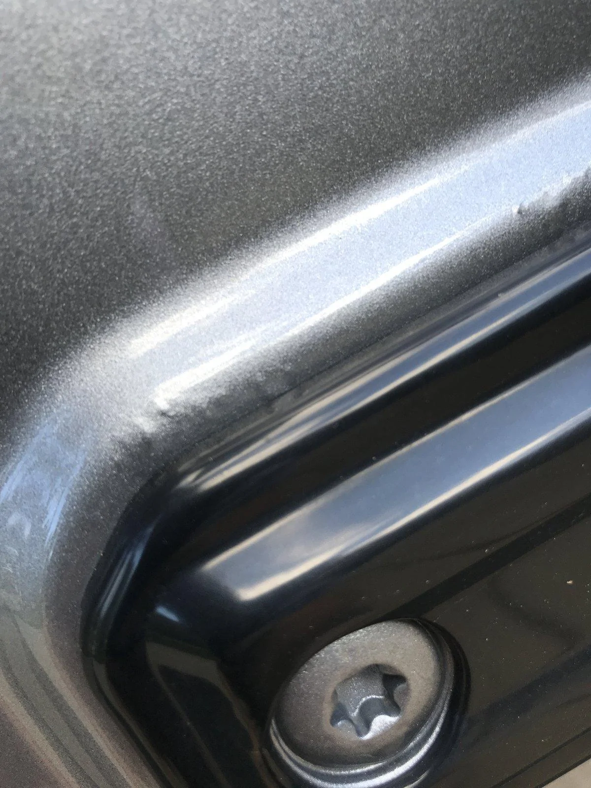

It's not a Wrangler thing or a Jeep thing it is all manufacturers that use aluminum parts. Ford, Chevy, Audi and others all have issues. Here is what a body shop worker said on an F150 forum with complaints about aluminum weakness and paint problems:
While I agree we don’t do much fab work anymore but there is more to body work than just slapping on some filler or replacing the panel. When it comes to aluminum the reason why there is a higher cost is because we need to get a whole new set of metal work tools so there is no cross contamination between the steel bodies we work on and aluminum. The manufacturers even want us to build special clean rooms for aluminum repair at a cost of about 60-80 grand. Aluminum also corrodes just like steel so there isn’t a real advantage there. I just saw a 14 and 15 dodge caravan with aluminum hoods that were corroded already on the outside. I am no expert on the whole aluminum vs steel but I have been doing bodywork for 15yrs and can tell you Troy it is not as easy as you seem to think.
When they decided to go to aluminum for the Wrangler the CEO at that time said they consulted with Audi because they had built separate facilities for steel and aluminum to try to avoid cross-contamination. I think they did that at the Toledo plant also. A single speck of steel dust on an aluminum part can ruin the paint and cause it to pop.
So it is an aluminum problem that most manufacturers have problems with. They can go to carbon fiber at much higher cost but it has problems also. Remember the good old days when everybody just complained about their steel fenders rusting out after a couple of years? Sigh. Miss those good old days.

Yep add me to the list with my 2018. Took the front doors off for the first time and all 4 hinges have this. For every thing I find I love about the Wrangler I get a slap in a face back to reality.
Jeep Wrangler JL Bubbles in Paint at Door Hinges 78F74880-AD5A-4F9D-A88B-1BF1F5A51B4C
time to go fight with the dealer.

That’s ridiculous. Makes you wonder if having the dealer mess with it is even worth it. Half the time they make it 10x worse! Geez sorry your dealing with that on a basically brand new jeep
Yep part of me wants to leave it but who knows what that would do.

Yeah, that's the same thought I have. I really don't want them messing up the paint (crappy quality, mismatch, etc....)

Don’t know if this will help guys but three weeks ago I had the dealership fixed all the hinges on my unlimited turned out beautiful they also informed me that any paint problems down the road because I had it fixed would be good for the life of the vehicle.

Go read the galvanic corrosion thread. ALL aluminum vehicles have paint problems because any bit of steel dust under the paint can cause corrosion. Ford has a class action lawsuit for F-150 aluminum corrosion issues. It is not a Jeep problem it is an aluminum problem.
And don't hold your breath that a standard paint shop can fix it. Requires specialized traing, equipment and booth.
