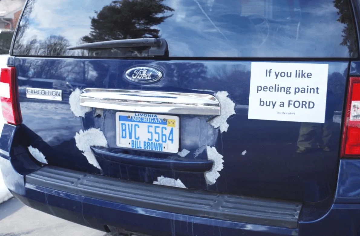

That is sadly common across multiple brands; I've seen the paint do similar things on Buicks, Chevys, Chryslers, Dodges, Fords, Jeeps, Nissans, Oldsmobiles, Saturns and Toyotas.
Just because other manufacturers have crappy paint jobs, doesnt make it ok for Jeep to do the same.

I didn't say that, I said I've seen it across multiple vehicle manufacturers, which makes me wonder if it's a paint issue rather than an automaker issue.
Poor paint prep, and bad design. You don't attach aluminum with ferrous metals, unless you do a good job isolating the two, with some barrier.
