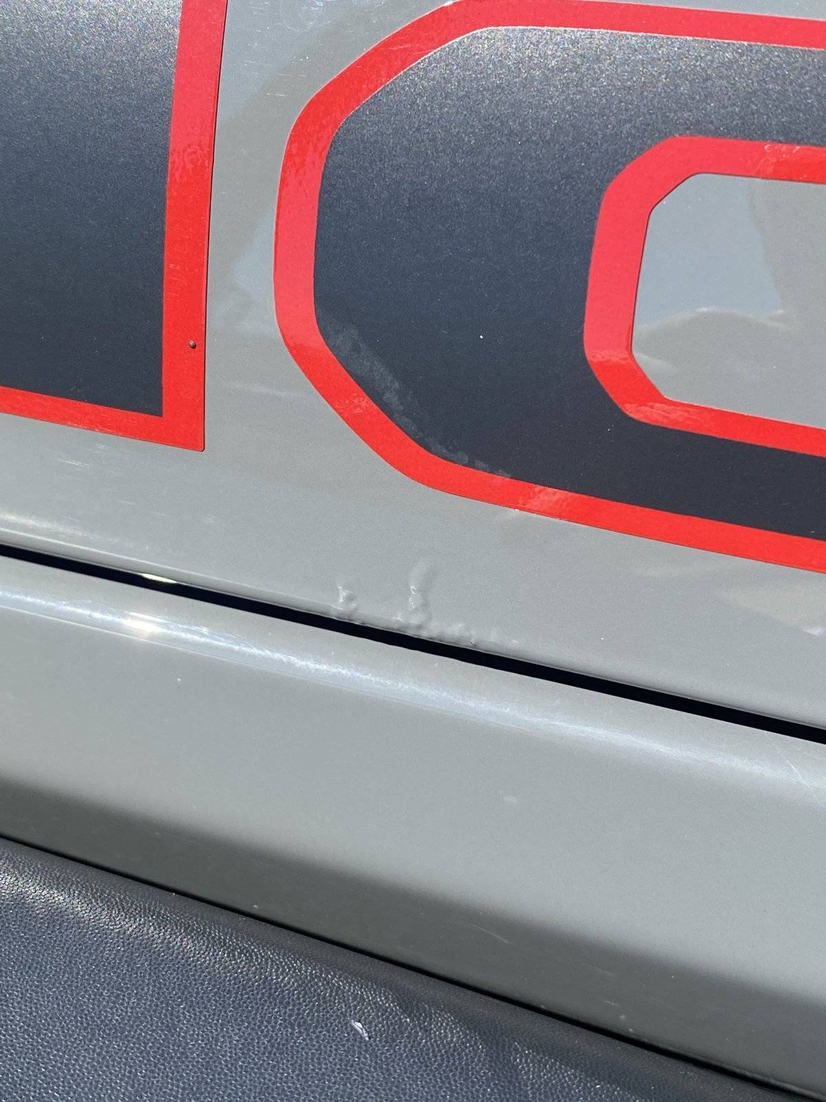

During the third attempt to fix my paint, the painted used this finger to see if it was dry
I would think that any professional painter would know to test for dryness on the tape that is masking off things close by. Guess they weren't that professional. :facepalm:
