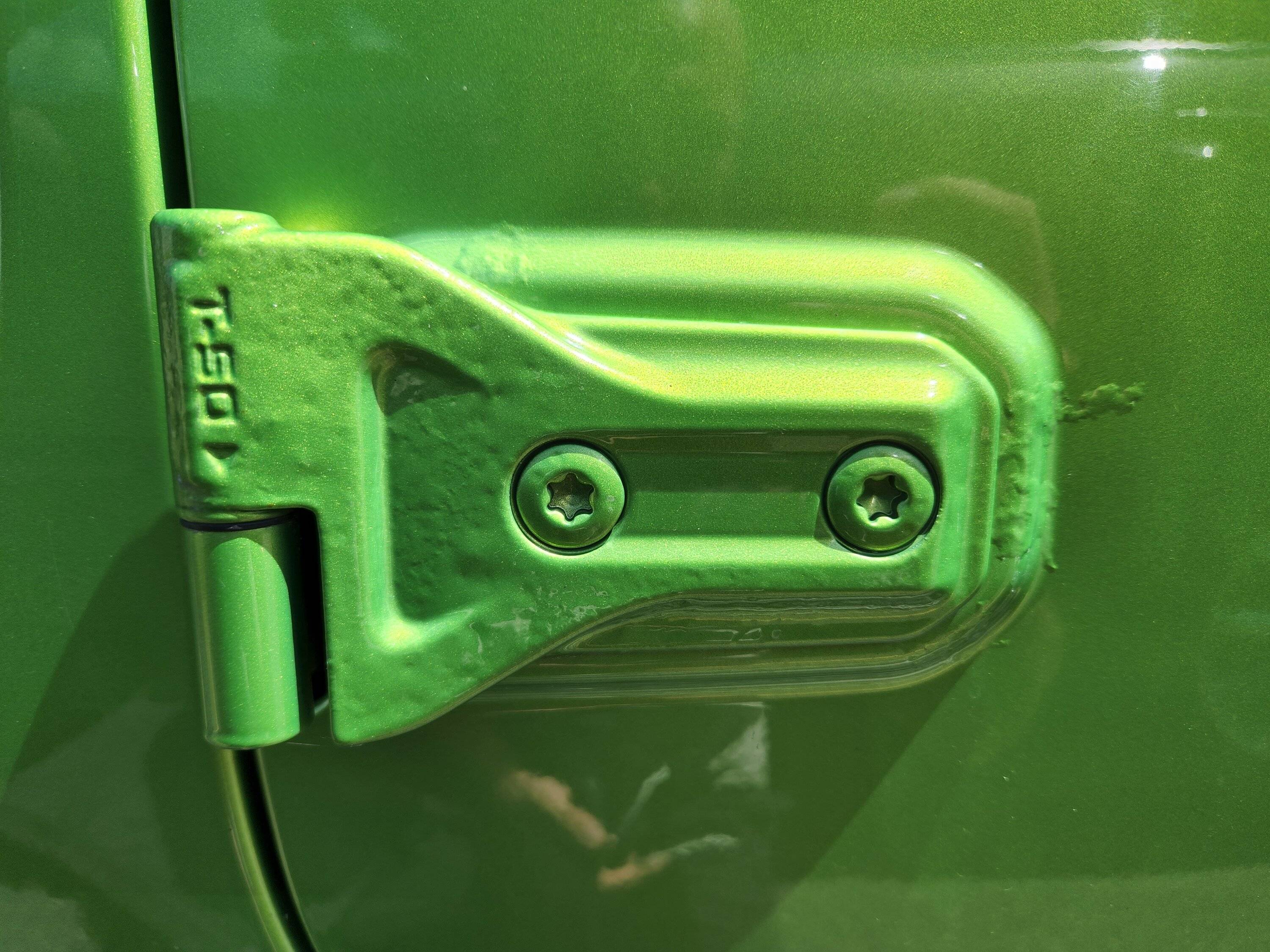

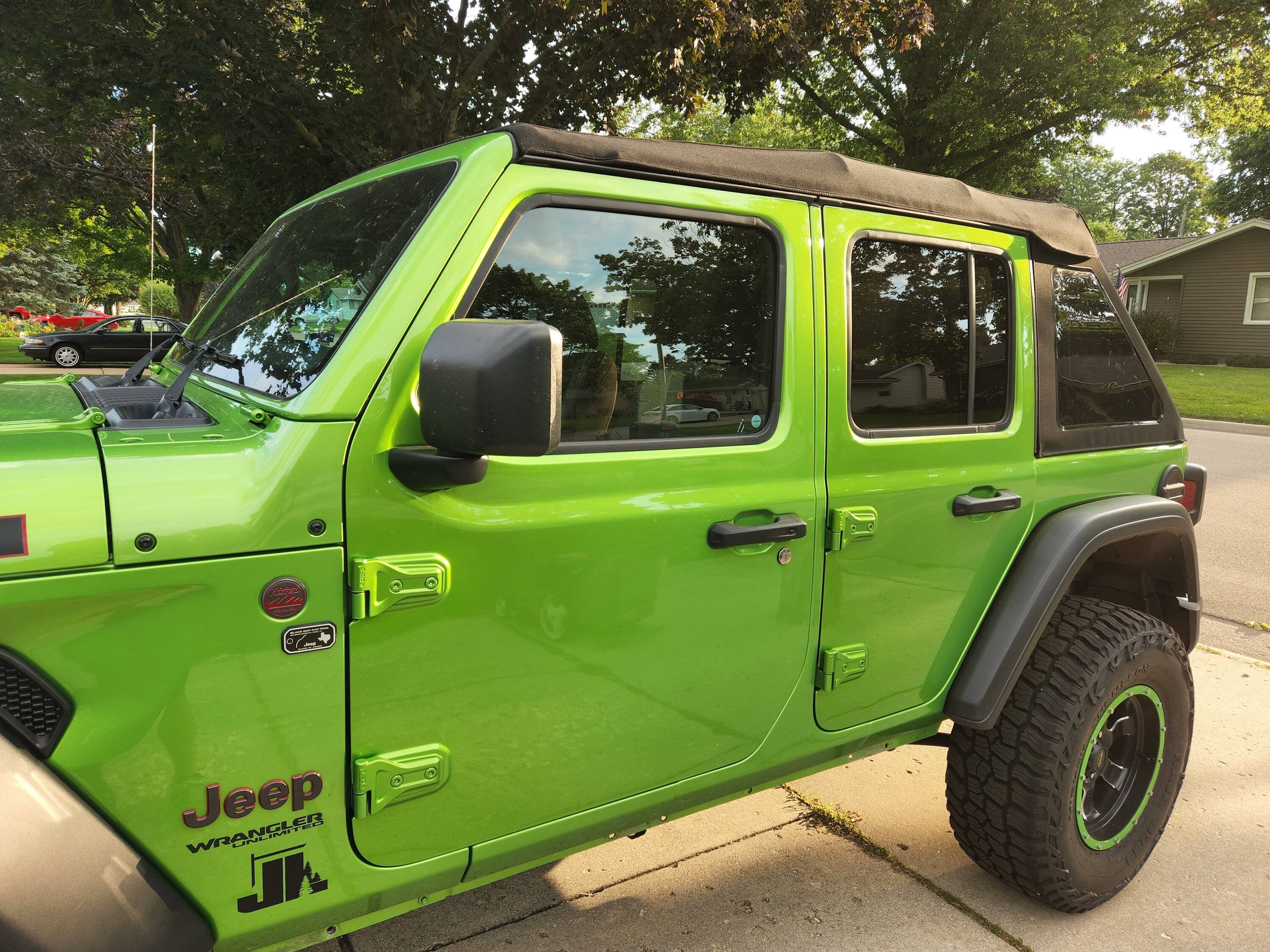

I have a 2018 that had corrosion on all 4 doors around the hinges. The repair was approved and covered under the corrosion warranty, had 50,000+ miles at the time of repair. Repair included new door hinges and bolts for all 4 doors. It took a month for the repair to be completed, though the dealer had issues getting the correct hinges in. The dealer's body shop painted the doors and hinges separately (new hinges were primed too) so there is now a paint barrier, and I asked them to coat the bolt threads with synthetic grease to hopefully help prevent any future corrosion, time will tell. Paint turned out great, can't tell any difference between the doors and body. Very happy with my experience, I read a lot of posts on this thread and was skeptical about doing this but I had some pretty bad corrosion on some hinges and it was spreading to the bottom of one of the doors. Here are a couple photos of the bad spots and an after photo. Hope everybody else's experience with this repair go well!
