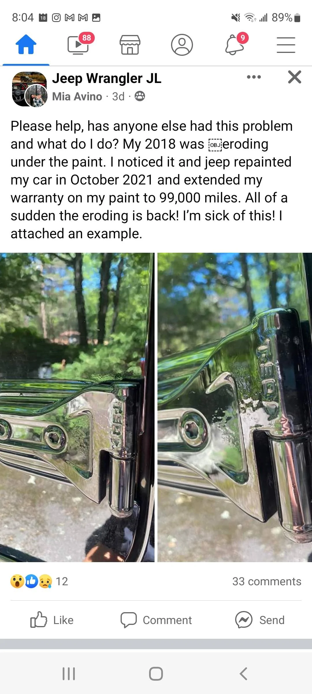

The JK had same door and hinge material. The issue is that they paint them with the hinges attached. So, water seeps between the hinge and the door and you get the issue we are seeing here.

I think there's been people in this thread that have had repeat issues. IRL I know of someone who has had repeated issues and just got rid of their Jeep because they were tired of dealing with it after two fixes.

Just saw this thread on my FB feed. Lots of people in there have said they have had repeat issues too.
