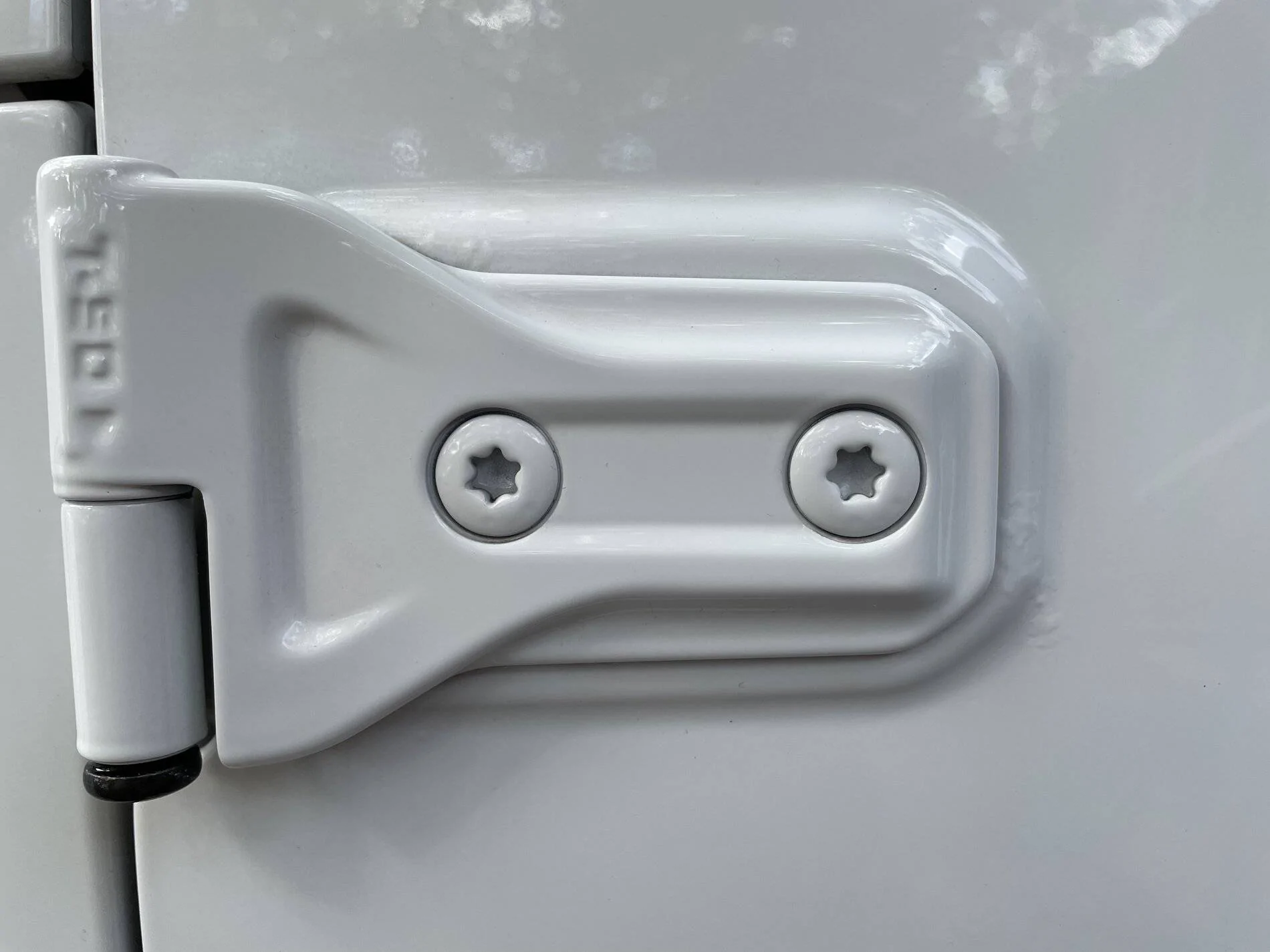

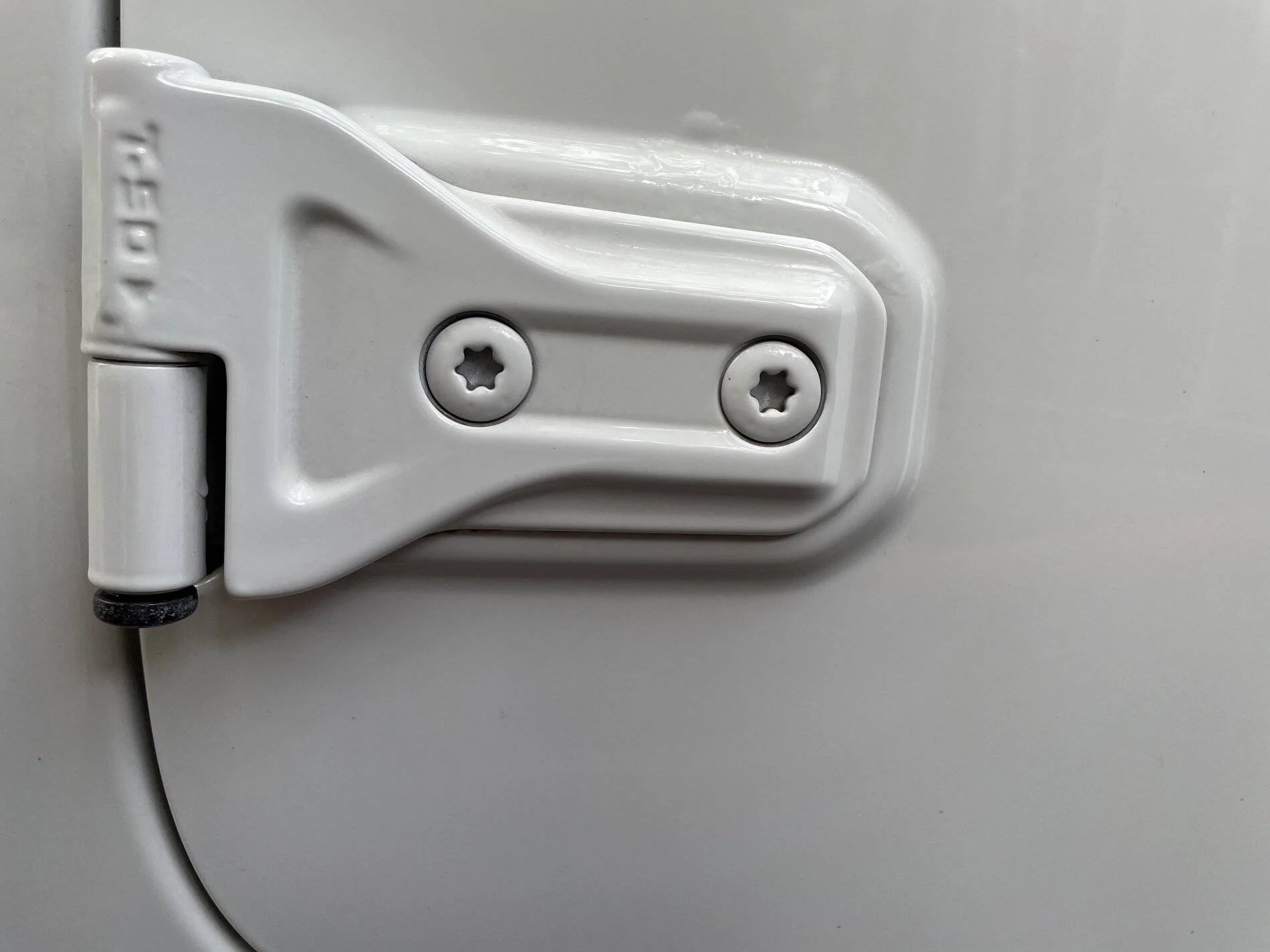

Anyone in the NYC area found a dealer willing to fix this issue?
see photos attached
I took mine to the dealership where I made the purchase - it has been a month and I am not confident they got their act together.
For those in the Detroit area - any recommendations on dealerships or shops assuming corrosion warranty covers?
Thank you in advance!

Aluminum corrosion or bubbling along the leading edge of hood, hinges or other exterior surface areas of the hinges, doors, fenders, swing gates or liftgates.
NOTE: This only applies to aluminum panels. To determine if the panel is aluminum, refer to collision manual for material specifications> DealerCONNECT> Service Library> enter year, model, engine> select collision info tab (adjacent to diagnostic tab)> 31- Collision Information> Specifications> Standardize Material Identification.
DIAGNOSIS:
Aluminum corrosion or bubbling on the doors and/or hinges (Fig. 1) .
Fig. 1 Examples of Bubbling
Aluminum corrosion along the leading edge of hood or other exterior surface areas of the doors, fenders or liftgates (Fig. 2) .

Remove blistered paint from the panel surface with 80 grit grinding disc.
After digital imaging or Regional Office approval and removing the initial blistered paint from the panel surface with 80 grit grinding disc, is severe pitting exhibited that cannot be removed with sandpaper, 3M Clean and Strip Disc or equivalent (Fig. 3) ?
Fig. 3 Corrosion Examples
• YES>>> Replace the panel.
• NO>>> Proceed to Step 1 of the repair procedure.
