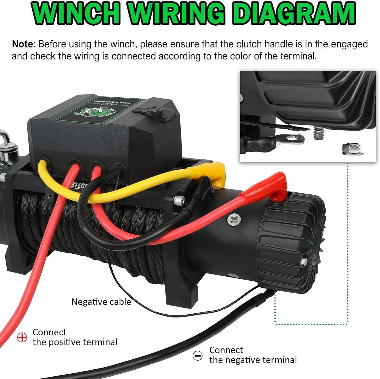

Alright, let's see if we can figure this out.
B+ to Control box - Burnt
Control Box Red to Winch - Fine
Control Box Yellow to Winch - Fine
Control Box Black to Winch - Burnt
Winch Black to B- - Burnt
This appears to be a Stegodon.
The control box Black to Winch is NOT a ground, it's one of the control circuits. Looks like the control circuit is wired direct through to ground.

If it wasn't a new install, this happened the 1st time they hit the controller. As gator pointed out, they have the ground black hard wired to the controlled black, creating a dead short. They didn't need a dust, they needed to write it correctly.
