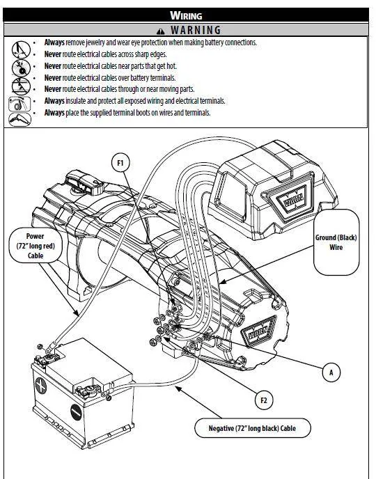

Not necessarily - Warn's winch disconnect kit, which is what they recommend for their Zeon's all the way up to the 12S Platinum, is rated for 200A. That's because the max rating is only peak amps and those numbers aren't seen for sustained periods - even the winch's own contactor isn't rated that high.
Um.. not that I see (not that I disagree that it's a solid safety addition)
https://www.warn.com/power-interrupt-kit-62132

Yeah so, I've never seen or heard of using a fuse on any winch in 50 years. Whys isn't there a fuse on the starter motor then? I do use battery solenoid cutout switches, always. Warn does not advice to USE a fuse, never seen them use a schematic showing one. At 600 amps, wouldn't the cable get pretty darn hot and melt that insulation anyway? There has to be some common sense here.

To me it looks like no fuse, direct connect to battery
