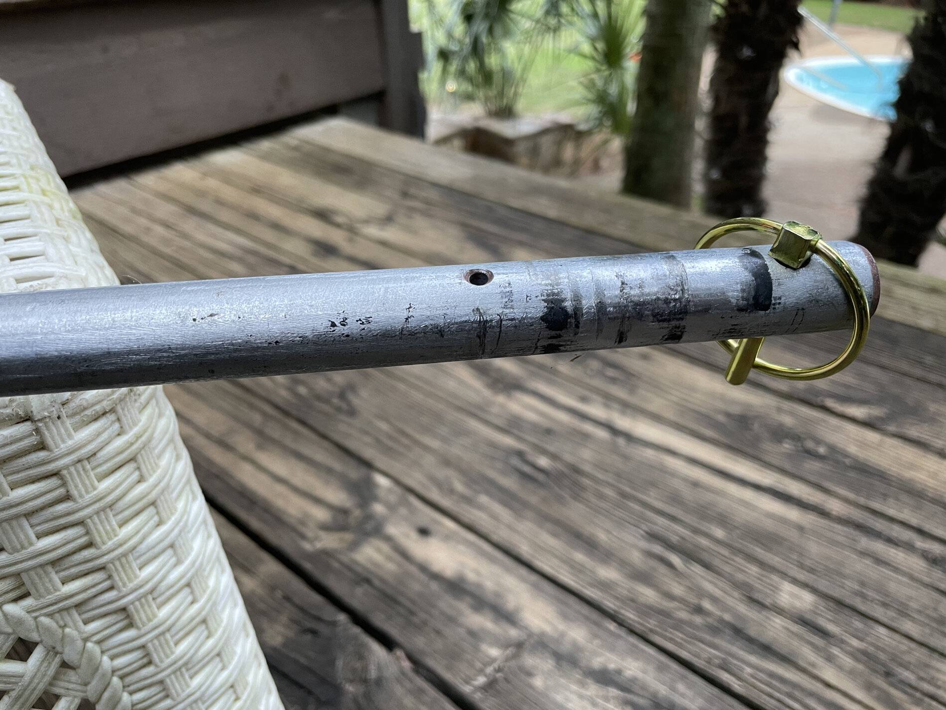

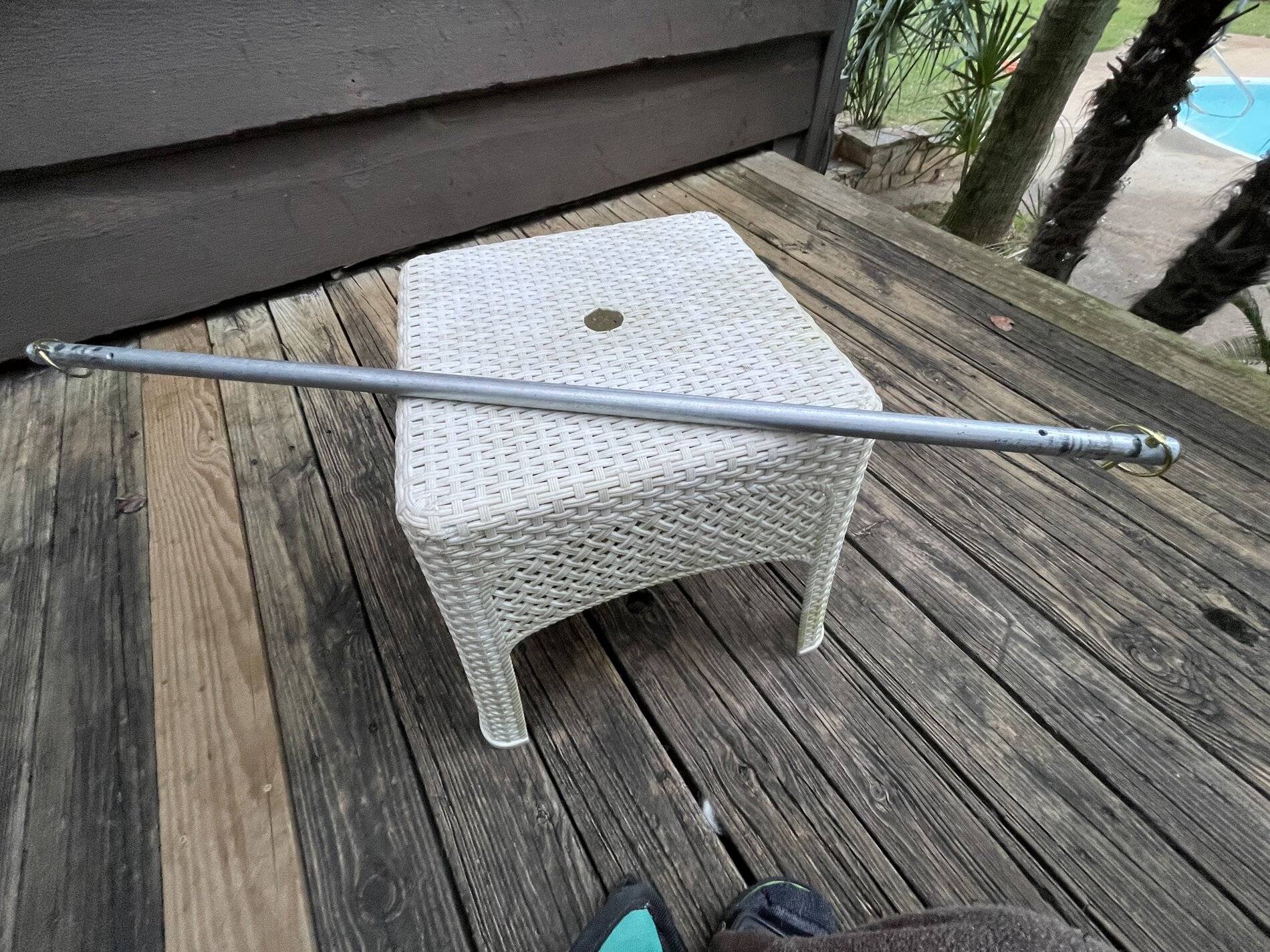

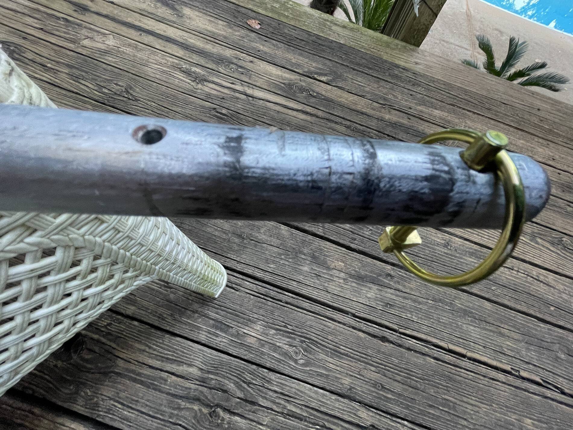

I can share my experience with my Maximus loops. I did around 18,000 miles of towing lifted 2020 Rubicon diesel on 37" tires. Mine never bent but mounting bolts were getting loose. I recommend you check yours. I ended up fabricating brace to make it more rigid. That fixed the problem. I also replaced 7/8" clevis pins with one piece of 7/8" diameter 39" long shaft. There are some significant forces involved because ends of the shaft bent slightly making it difficult to remove. I used cold roll steel shaft because it was zinc plated. I will replace it with harder shaft.
Mine are on with Locktite RED triple checked when I saw the bend all was tight. I am assuming it was just a one time thing, maybe the steel plate had a some bend originally and this is just memory bending. AS mentioned the force cold not have been that strong as the Aluminum Clevises are un phased.

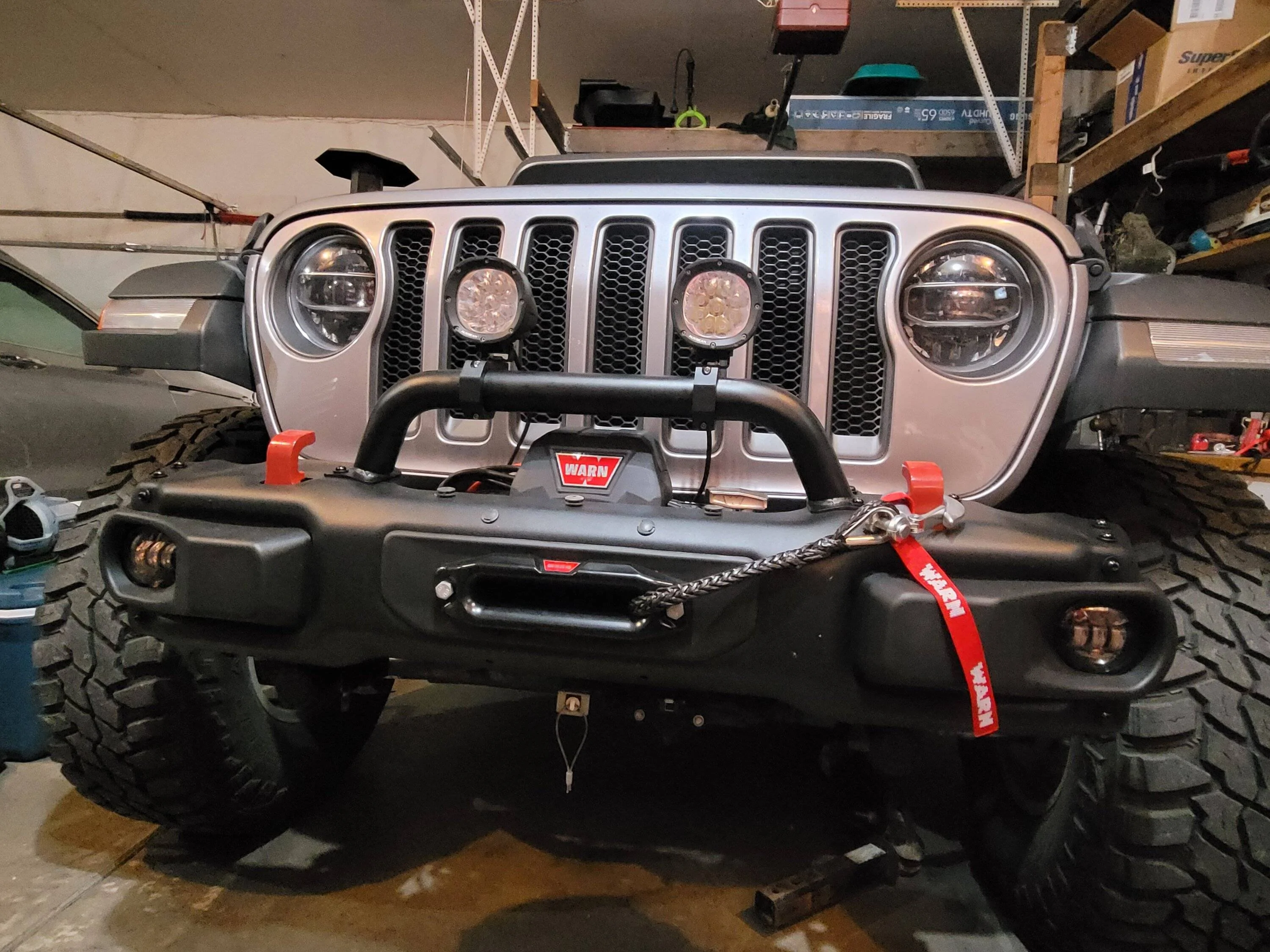

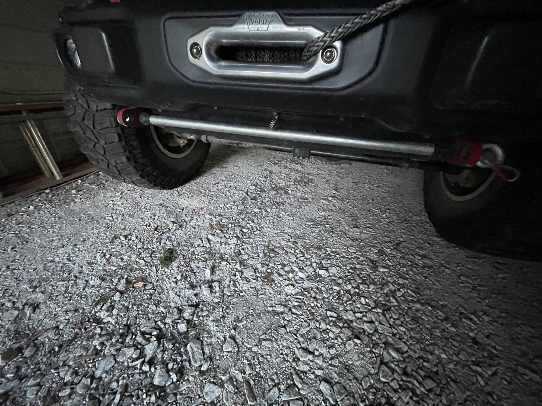

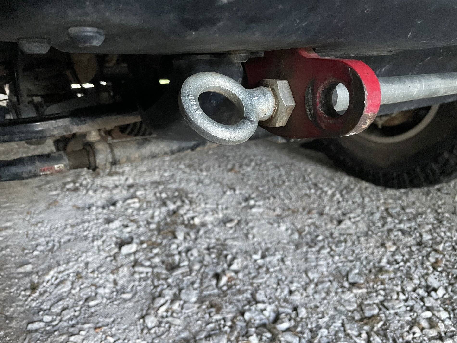

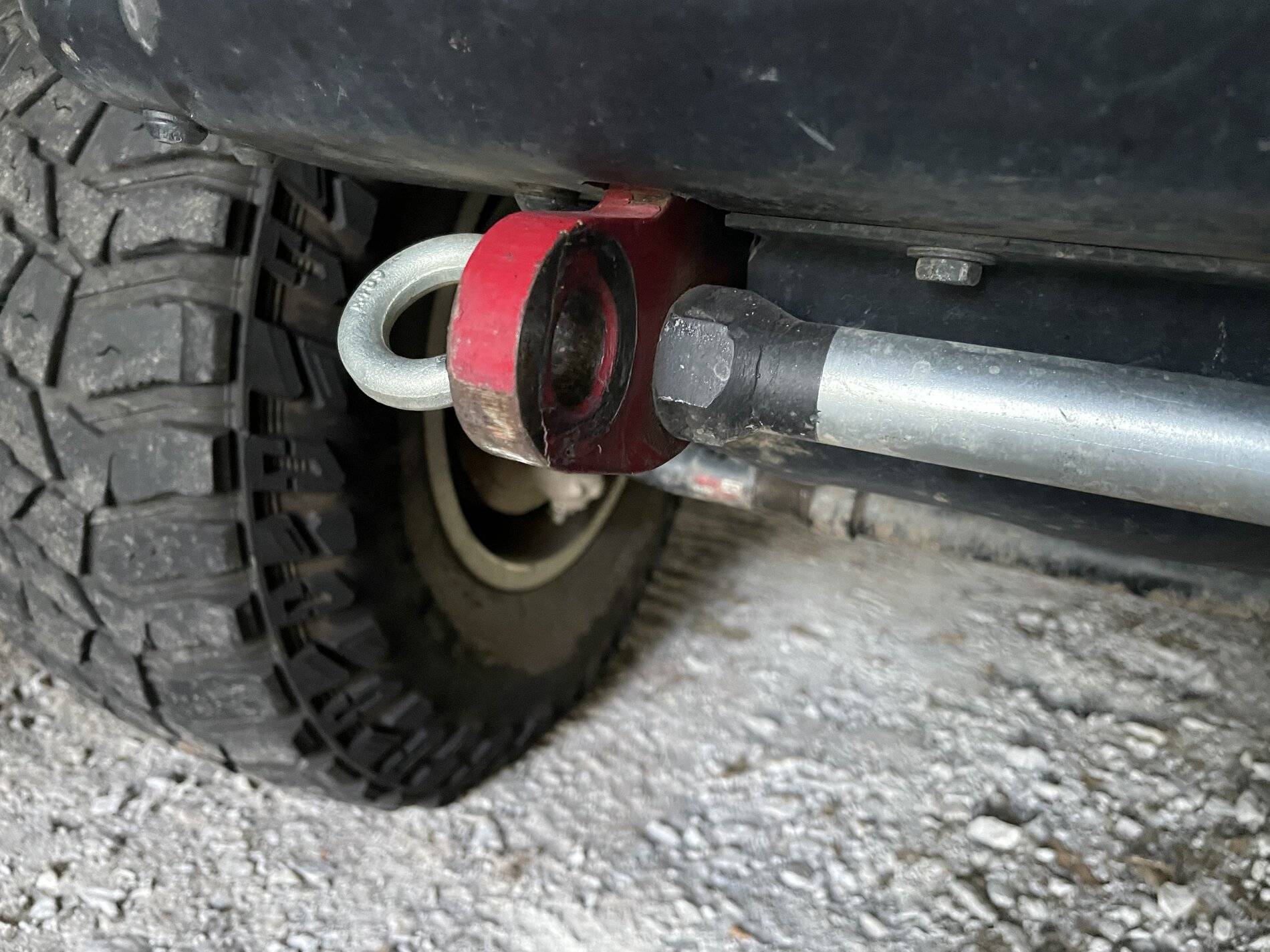

I went Maximus-3 on my 2020 Gladiator due to the behind bumper winch mount. I found out a year later about the bending problem. Mine never did, but I had to buy a tie rod to add to the system. Never liked Maximus-3 loops since. Now with a JLUR with Roadmaster mounts. They sandwich the frame on both sides. Made it work with a winch. I had the RVI3 on the last two Jeeps. Best portable system out there IMO. The JL has a Demco Stay-in-play. I like it much better. Hook up and go. No box in and out.
Nice setup, I still have the Maximus and with the bar, I have not had any problems at all. I would trash the Roadmaster setup with the trails we run. Wish there was a way to raise them up, we use that system on my wife's GCL and it is super sturdy and quick to hook up.

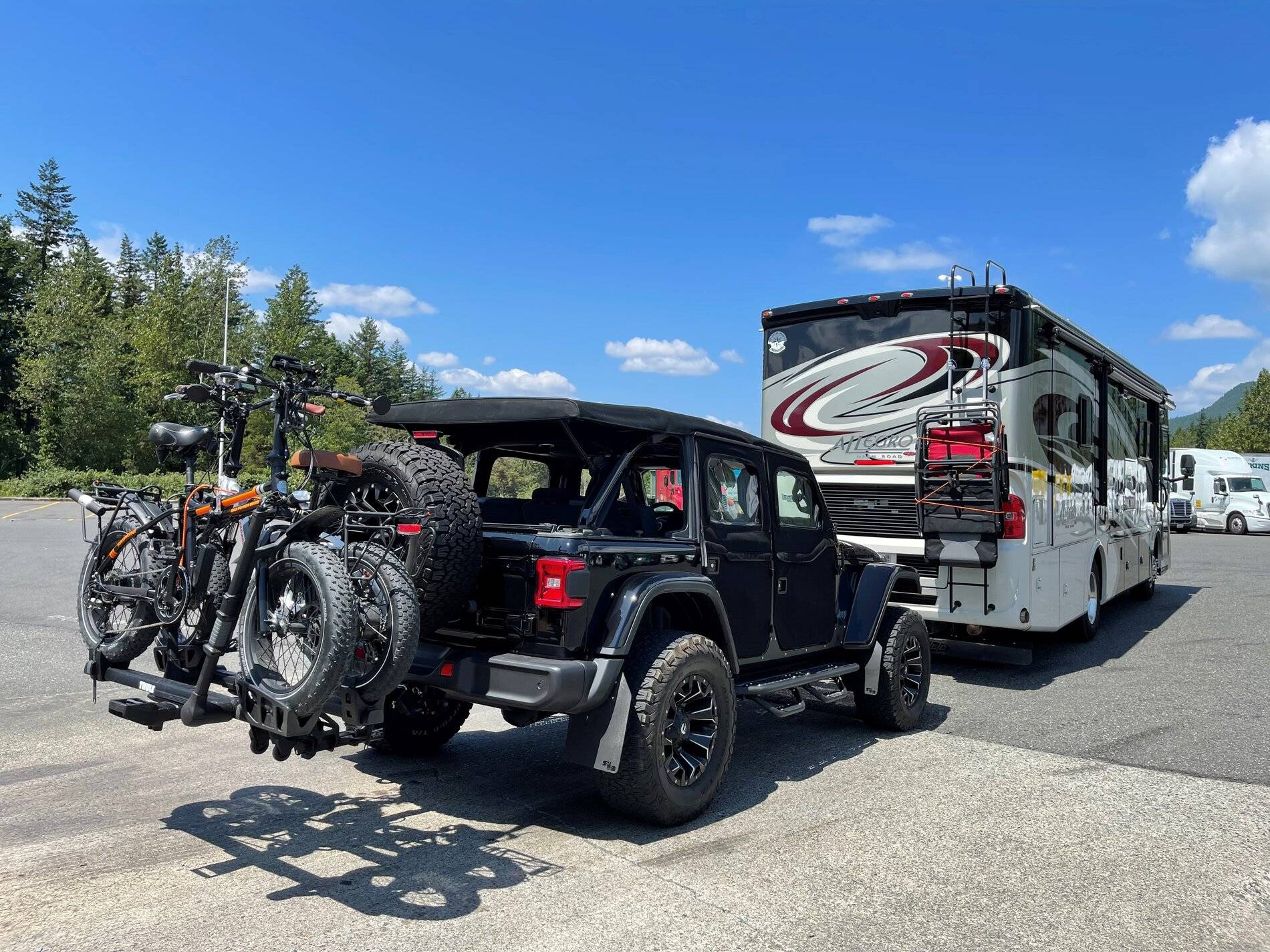

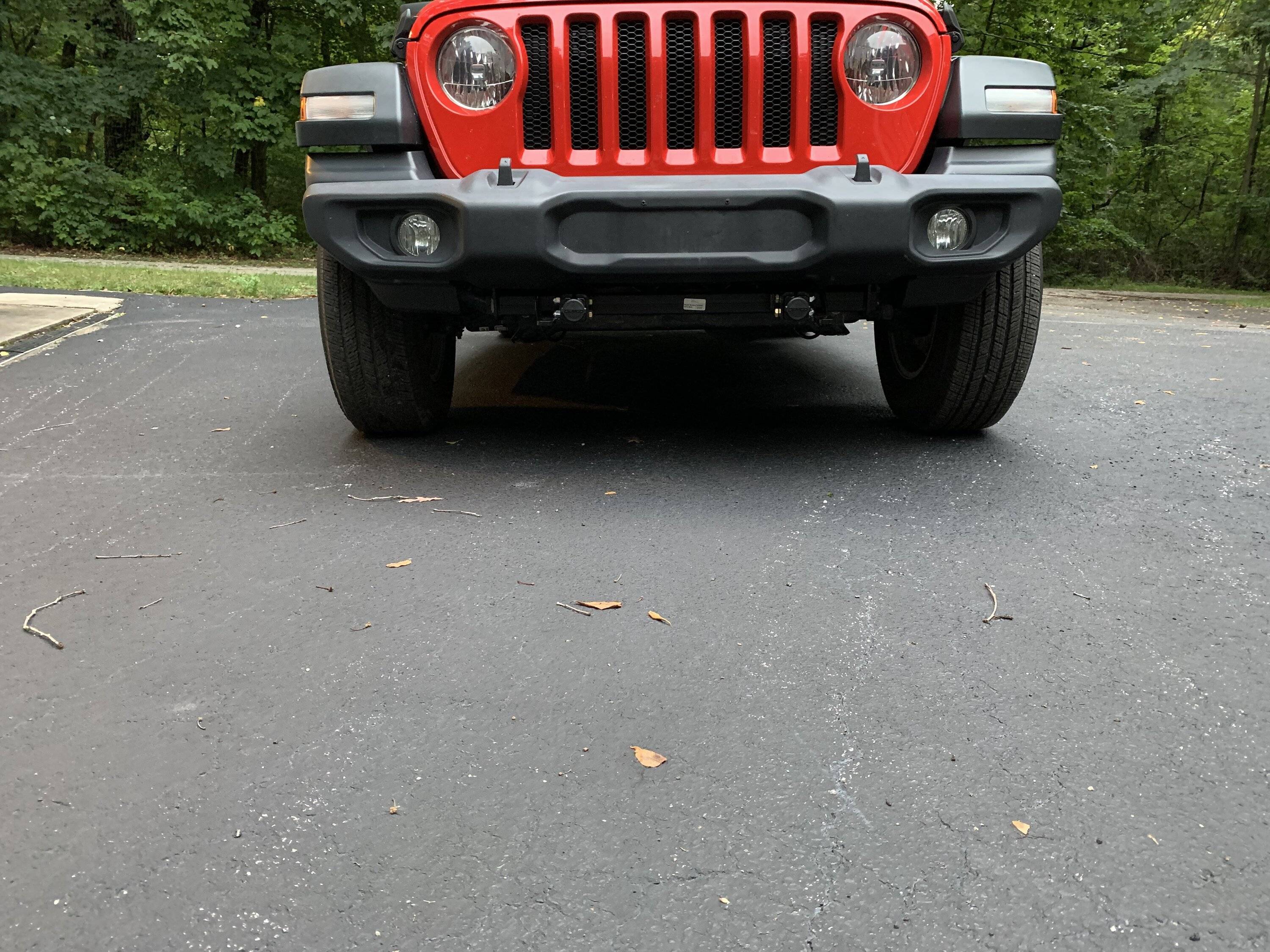

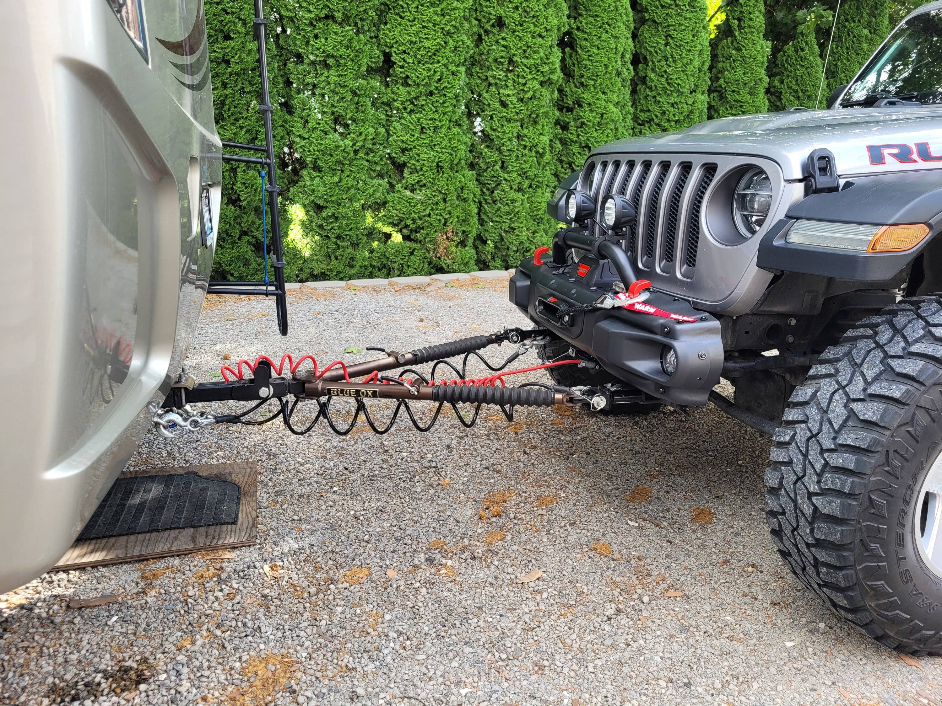

We have a Blue Ox aluminum tow bar that we have had forever from when we were towing our old 2001 Grand Cherokee, we us the older Classic Brake Buddy as well since we already owned it. Went with the e-trailer base plate that is somewhat hidden and we are using the diode wire harness in the brake lights. It get the job done. Easy to hook up but not so easy to unhook. The pins go into the base plate knuckles easily but are very stiff to pull. Still trying to figure that part out.
A little unhooking trick that was passed to me when I was having a difficult time removing the pins even though I was reasonably straight and level. If the pins are stiff/binding, set the parking brake on the jeep, start the engine and turn the steering wheel full left or right to loosen the pins. Works every time for me, even if you have to unhook while in a turn.

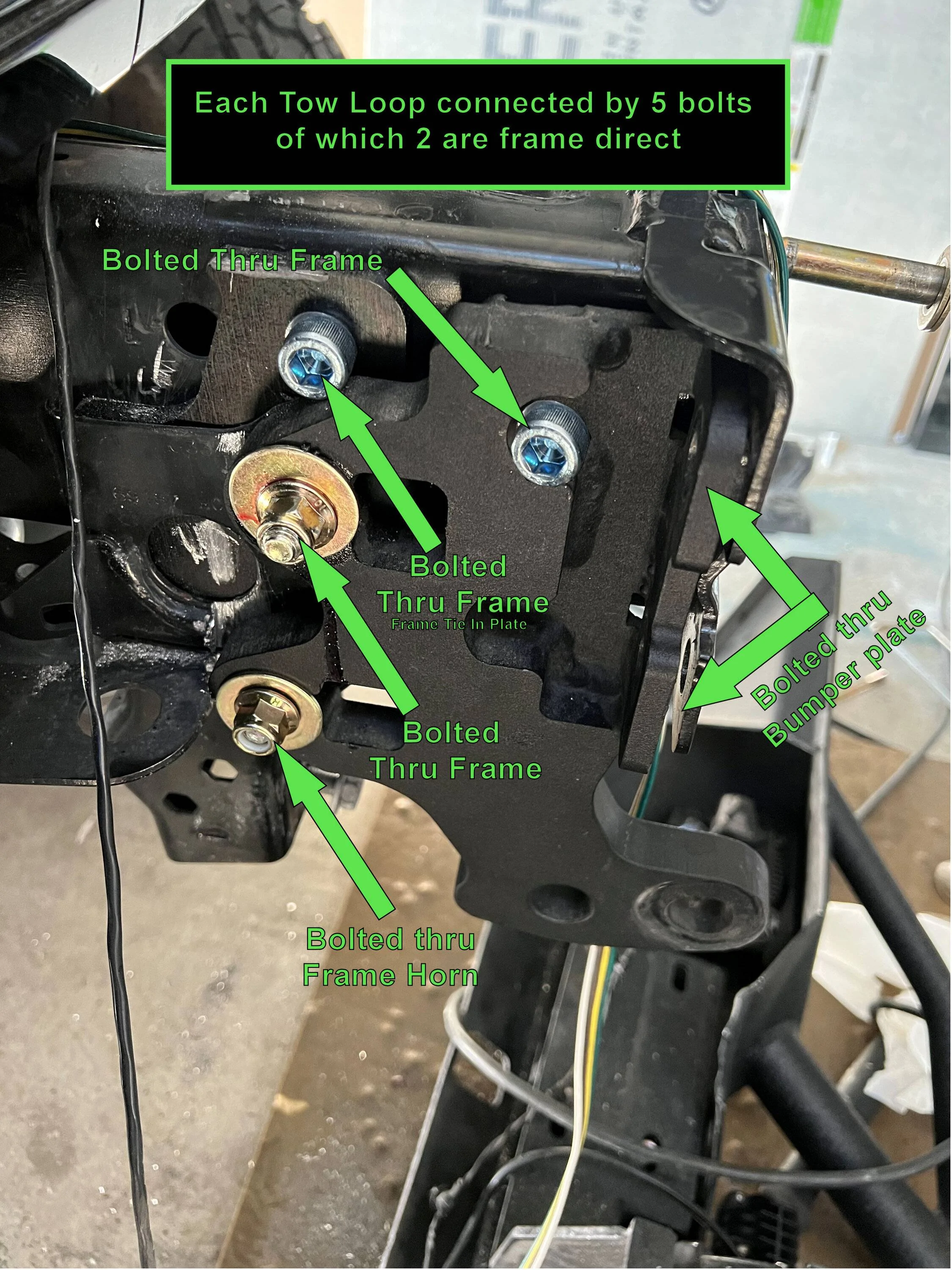

Maximus 3 Frame tie in kits also sandwiches thew frame and far more robust then Roadmaster. The maximus also bolt thru the frame in 3 locationbs on each loop
Jeep Wrangler JL Best Setup for RV Flat Tow Maximus 3 Tow Loops Bolt patterns

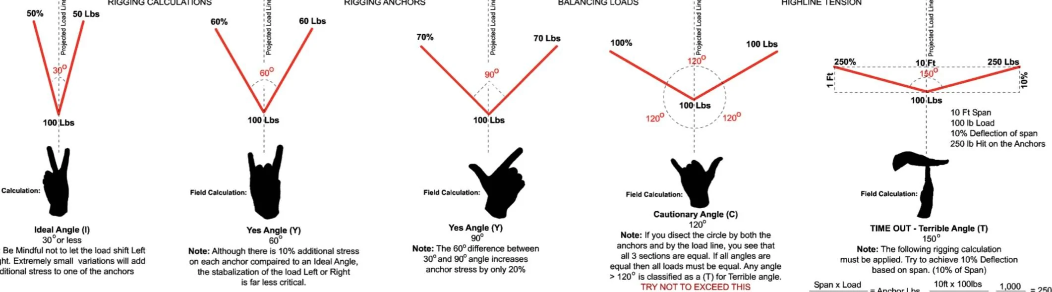

The other newer benefit of the maximus is you can now mount to the inside of the frame which reduces the spread of the tow bar thus reducing lateral stress and forces on the tow connaction and frame.
Jeep Wrangler JL Best Setup for RV Flat Tow tow angles
However the only real flaw in the Roadnaster is it is comprised of welded components, wand when installed you cannot inspect those welds without removing the bumper (welds are the #1 casue of base plate failure), Maximus does not rely on any welds. I agree the last gen of maximus that did not have these fixes had its share of issues. This is not tosay Roadmaster is a bad system but it does lack the above benefits. Note Roadmaster is not voide of failed welds thier last gen had its share and I have only see one account on the current Roadmaster.
