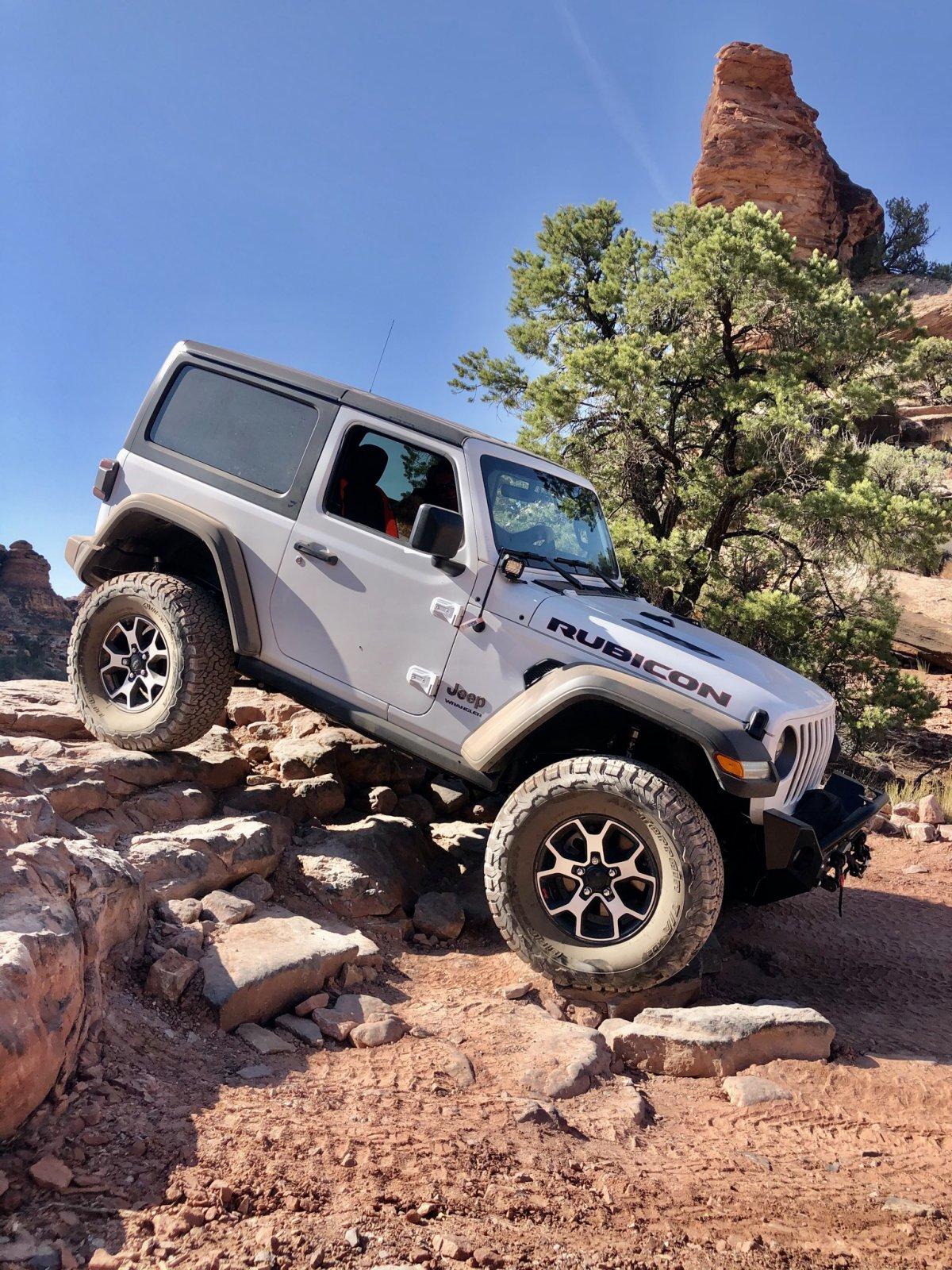

Are you on Elephant HillTr?
It sure is! Good eye!
Elephant hill rocks ! (haha get it?)
Actually though, the reason I posted the photo was to show the Rockhard aluminum bumper which I have been using to tow the jeep behind our motorhome. It works great with a Smittybilt towbar and simple magnetic tail-lights. The entire package cost less than $200 (not including the bumper, Which by the way looks awesome) and weighs less than 50 pounds.
I also maintain all my much-needed ground clearance without a bunch of unnecessary bulky stuff dragging from the bottom of my frame.
Highly recommend this system.

I'm going to PM you at some point in the near future if that's OK regarding picking your brain on your setup I have a 2dr Rubi on order

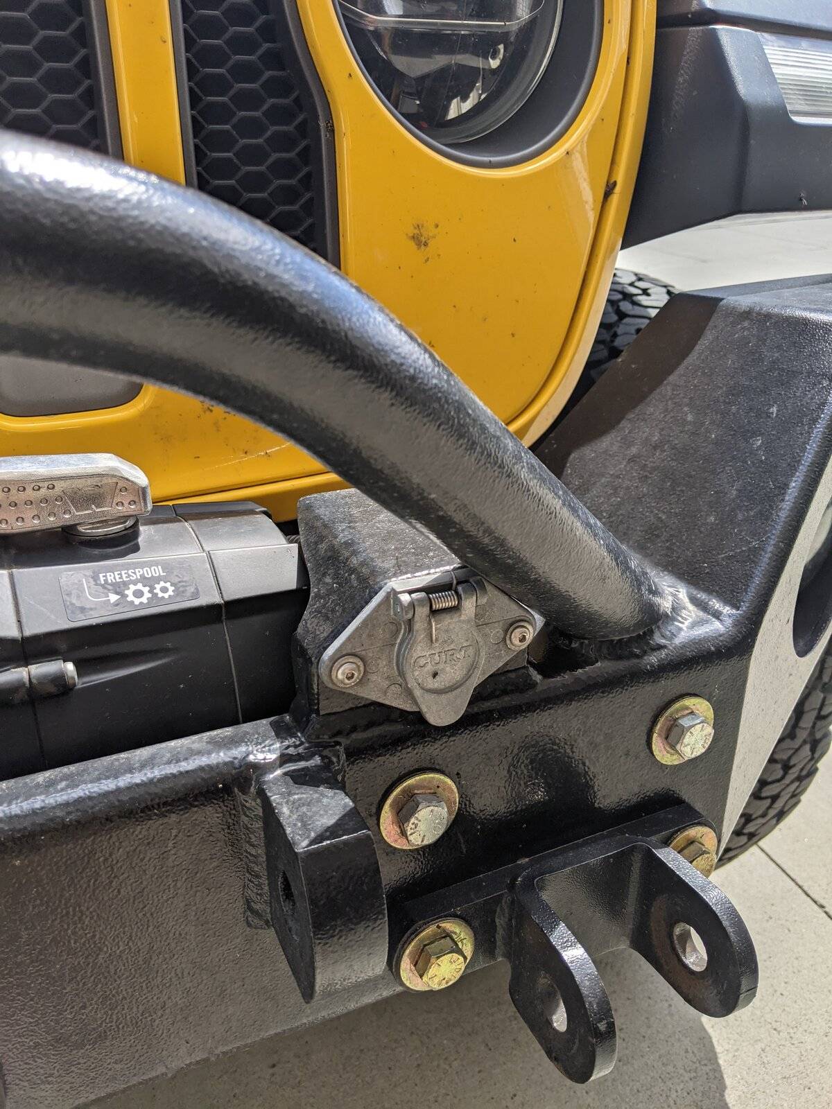

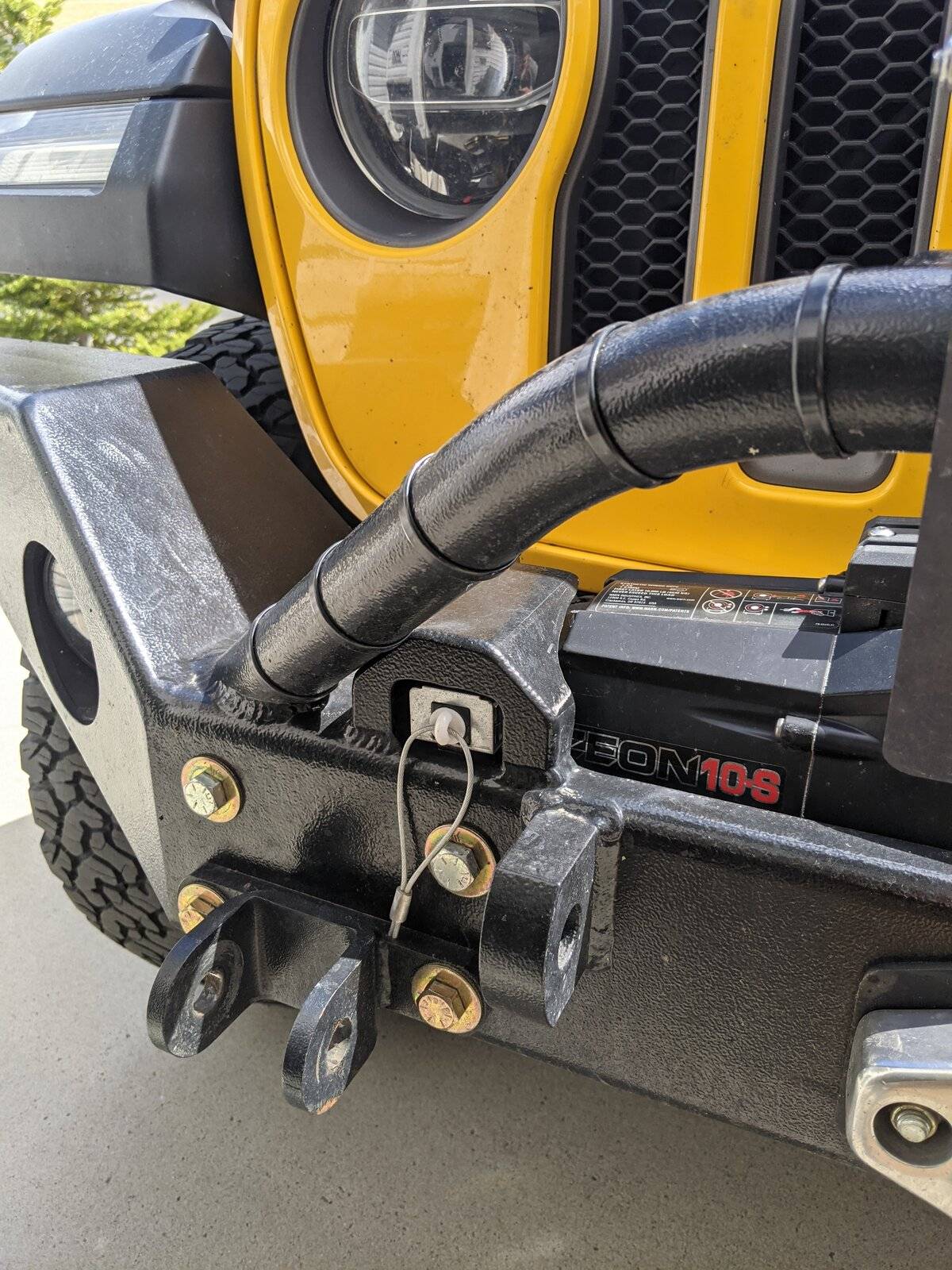

While we are on the pros of an aluminum Rock Hard 4x4 bumper I thought I would post a few pictures of mine. I added housings for the brake away cable and the tow umbilical cable. This is much cleaner looking and keeps me off my knees.
Jeep Wrangler JL Best Setup for RV Flat Tow front
Jeep Wrangler JL Best Setup for RV Flat Tow brake
Jeep Wrangler JL Best Setup for RV Flat Tow lights
