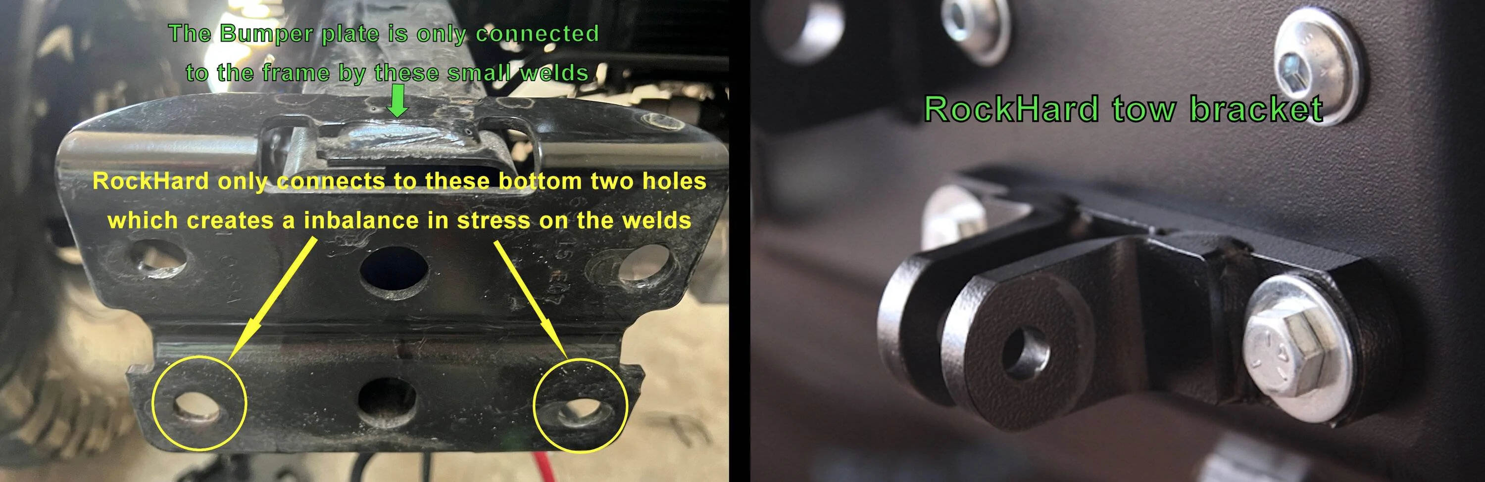

Heres my setup. I have flat towed 4 diff vehicles over 200K miles in the last 33 years, never even come close to having an issue. 30K miles towing on current setup. On my 3rd tow bar also. They do start to wear at around 80K miles of towing.
That is about the lamest endorsemtn I have ever heard. So if someone drinks and drives for 10-20 years without having an accident, that makes it by default safe operation of the vehicle???
Jeep says you should never tow from the bumper plate connection (which Rockhard LOD and others ignore) becasue it is part of the crumple zone and designed to fail on impact, but because you have not had an incident everyone should do it, and just say screw those Stallantis/Jeep engineers what do they know???
The fact that your Rockhard tow connection which is only held by tow bolts too the bumper plate (thin 3/16th sheet metal) which is then only connected to the frame by 4 very small welds that you cannot even inspect without removing your bumper. How do you know you do not have a cracked or broken weld just waiting to fail? you don't. (That Bumper is not even ties directlt o the frame). People should always inspect thier tow connection before every tow. becasue you cannot properly inspect, you are rolling the dice with every pull and or stop.
Jeep Wrangler JL Best Setup for RV Flat Tow Rock Hard
There is also a reason that the bumper connects to the plate (again not the frame) using 4 bolts (one at each corner) which then provides balance to the plate when there are forces on the bumper. Whereas the crackerjack engineers at Rockhard create a tow connection that only ties to the bottom tow bolts on the bumper plate which is not balanced and also creates a rocking motion on that plate and welds with every stop and start.
Tow connection to the Wrangler should ALWAYS be bolted thru the linear tube frame... Also note Vehicles manufactured 15-30 tears ago are not buuilt like they are today, you should not should not compare towing with vintage vehicles expecially Wranglers as they are not as rubust today as they were back ing the day...

No you wern't, but you were providing potentially dangerous advice. This thread was "best Setup for towing" not best potentially compromised setup.

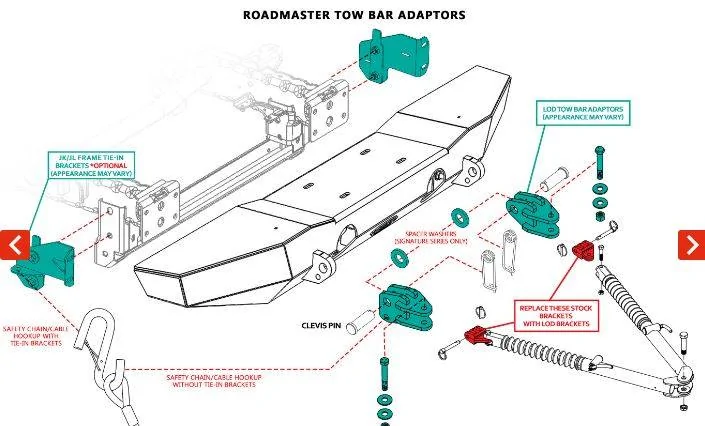

Are you saying aftermarket engineers are not as smart or diligent as Stellantis Engineers? Unfortunately, life is full of trust, and I get you are trying to limit it in the flat towing arena. In this example we are speaking strictly about a stock Jeep as I haven't seen anything from Stellantis engineers recommending too much when any mods are done.
Has anyone tested strength with frame bracket ties ins and where they mount to the front bumper?
Or do we trust the welds and engineering from one company over another?
I like to hear others have no problems and failures happen from all engineers and companies.
I suspect that is why the old saying don't buy anything made on a Monday or Friday
From LoD website
" Do you tow your Jeep behind and RV? Do you constantly find yourself winching large objects or other vehicles on the trail? If so we recommend installing front bumper Frame Tie-In Brackets! These Frame Tie-In Brackets reinforce the connection between the welded face plate of your Jeep frame and the frame itself, and coupled with our Tow Bar Adapters and our Front Bumpers create a super strong and reliable connection to your RV! These brackets come in black powder coat finish and are fully welded and made from high strength 3/16” thick steel for maximum strength. They also contain an integrated safety chain attachment point and are completely bolt on and work with all LOD front bumpers. "
Jeep Wrangler JL Best Setup for RV Flat Tow Frame tie in Roadmaster

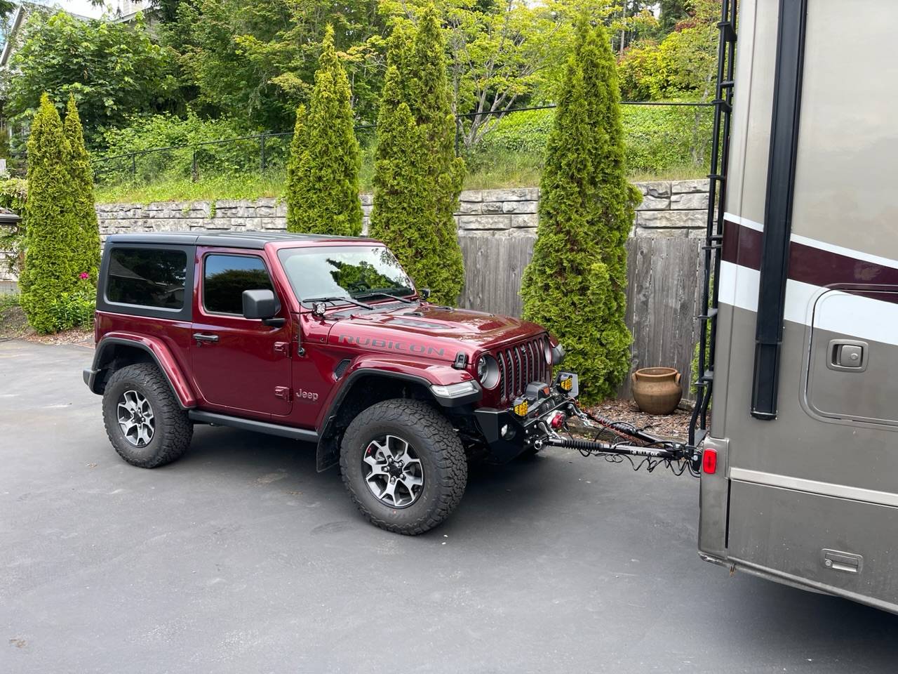

Apologies if I have posted here before but here is my set up for my JLR 2dr behind my Class C Sprinter. I like the simplicity of the hookup (no brake or aux lights to place) and the lightweight set up overall.
RockHard4x4 aluminum Patriot mid width bumper
Demo Stay n Play Duo braking system w/Coach link
Blue Ox Ascent Tow bar
