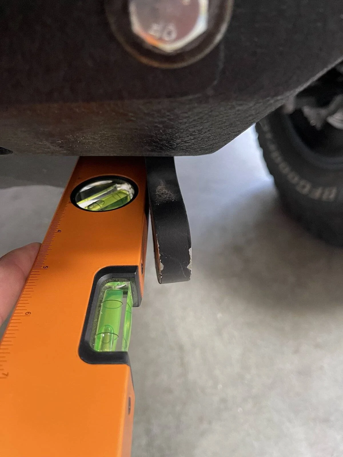

My 2nd trip with the Maximus 3 went over 6 mountain passes below was the result, the maximus 3 bent. Now I am towing a 4xe scale weight at 5800lbs but this should not be happening. Maximus did promptly replace it though (great customer service) I will be watching it closely.

My 2nd trip pit with the Maximus 3 went of 6 mountain passes below was the result, the maximus 3 bent. Now I am towing a 4xe scale weight at 5800lbs but this should not be happening. Maximus di promptly replace it though (great customer service) I will be watching it closely.
Thanks, my rig weighs about the same. I have the Maximus 3 in hand, just waiting for the adapters for my roadmaster sterling hitch. I want to ensure I will have enough room for it to work with my ACE bumper before I start hacking it up. It appears like they will not stick out enough to use a tow defender to keep the rocks off the Jeep...
