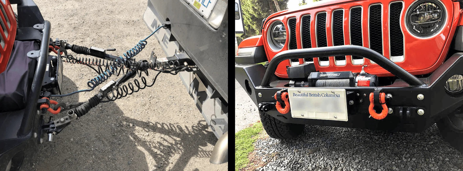

  • Go with a vehicle-specific base plate. All those aftermarket bumpers with winches look cool, but they're not designed for long-distance towing. You might be OK, but ???
In most cases, you are correct, but not in all cases. That is one of the problems with making general and ill-informed "All those" types of statements.
Rock Hard manufactures a number of models designed with flat towing in mind with the tow point bolted directly to the frame rails. There is at least one other brand that I am aware of, though I do not recall their name at the moment.
Many 3rd party bumper pull scenarios do not bolt directly to the frame rails and as a result to not satisfy the required safety regulation for flat towing.
When done right, these can offer a number of advantages, such as raising all tow connections to a greater height, eliminating all deep bending and kneeling on the rocky or wet ground to connect/disconnect. Our Rock Hard bumper solution works great and is faster and easier to connect than any alternate system I have seen. In addition, its easy-to-access tow connection bolts make period torque checking easy. This was a royal pain on our last flat tow using a BlueOx base plate.
