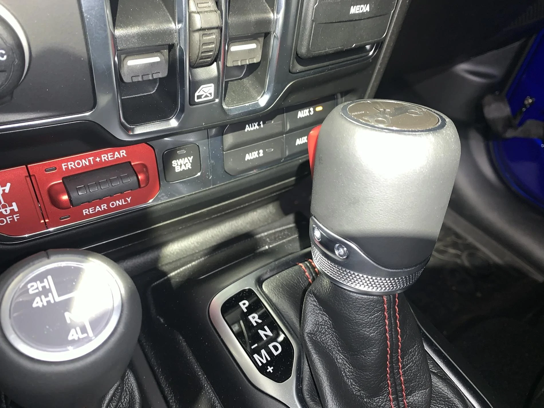

I needed a 12-volt outlet that was hot while the vehicle is turned off. I decided to wire one to the Aux. 3 switch on my dash and made it useable (via UConnect) while the vehicle is off. The install was super easy with the wiring supplied under the glovebox. I used the ground which is hidden under the plastic trim on the door sill of the back seat.
Nicely done! I think I am going to borrow your idea. What 12V outlet / socket did you use for this wiring?

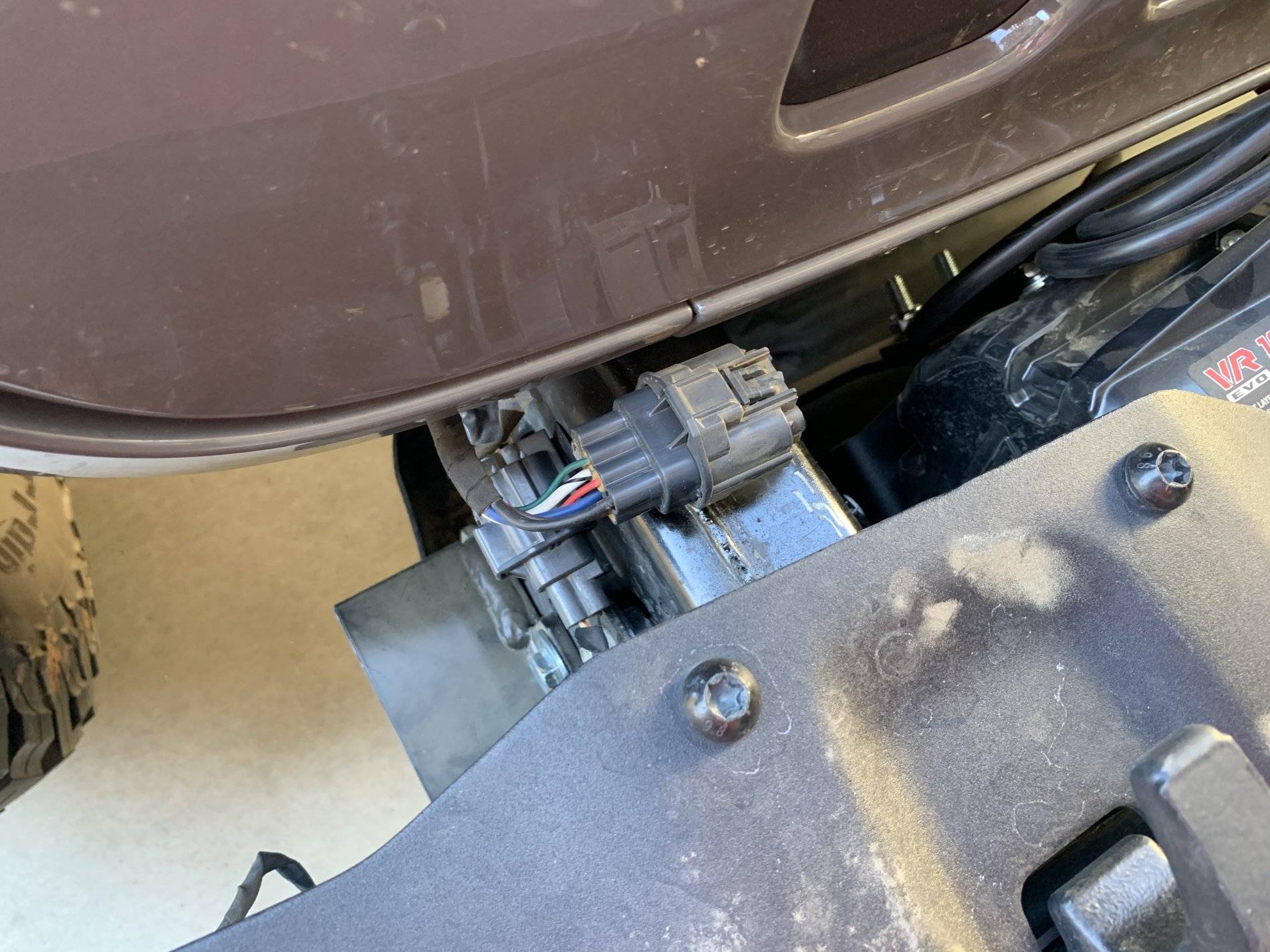

I had the Mopar flat tow wire harness installed, along with the Mopar towing wire harness (wtf it didn't come with this IDK...), and d-ring adaptors. Falcon2 tow bar setup...
that first pic is of the flat tow harness plugin sitting on top of the frame rail. it came with a automotive connector to 7 pin standard trailer plug so it is super convenient and takes about 5m to hookup flat tow now that I've learned the Shift-N pattern for towing.
