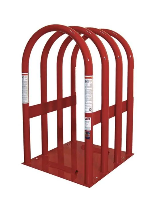

At most places they look like this. Most tire shops have to have them.

And no one uses them unless they are mounting commercial (bus, truck, semi) wheels. No one uses cages for passenger and light truck applications.

Yeah, no one uses cages unless working on commercial size wheels. Beadlocks are supper easy to mount. They don't even require a tire machine. I installed mine at home using some small motorcycle tire irons to coax the outside bead onto the lip prior to installing the beadlock ring. Throw a bag of balancing beads in the tire as you mount it and you will never need to visit a tire shop, unless you install new TMPS and need them programmed.
I don't think my 37's took more than 35 PSI to seat the inside bead. Far less than operating pressure on many light truck tires.
