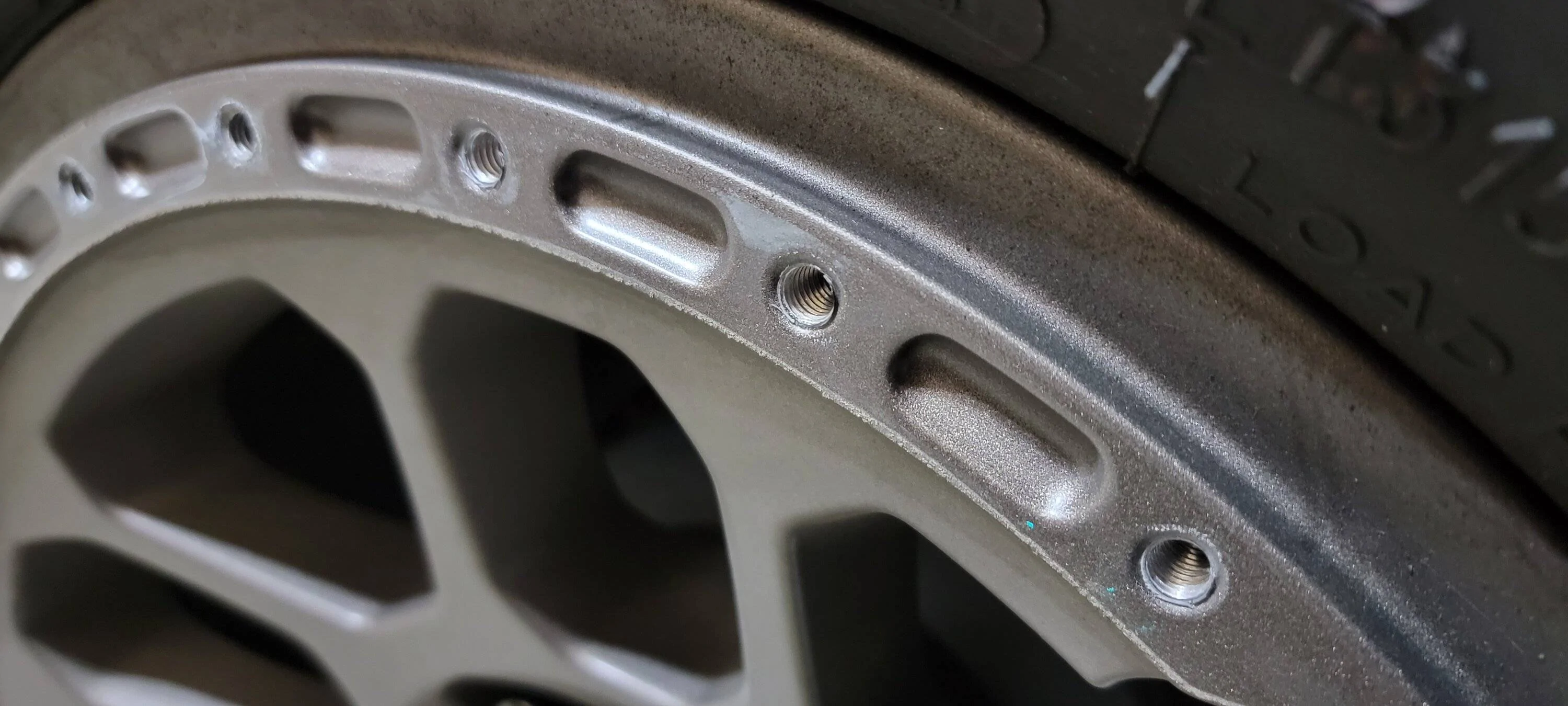

Over torque steel bolts into aluminum, place it under pressure, and it will fail. It has 0 to do with the quality of the beadlock and everything to do with improper installation.
Quality wheels won't drill into the aluminum wheel and hope it holds. If that exists nobody should run it under any circumstance. I agree with you 100%. That's a recipe for disaster. Even Jeep is putting inserts in their beadlock capable wheels.
