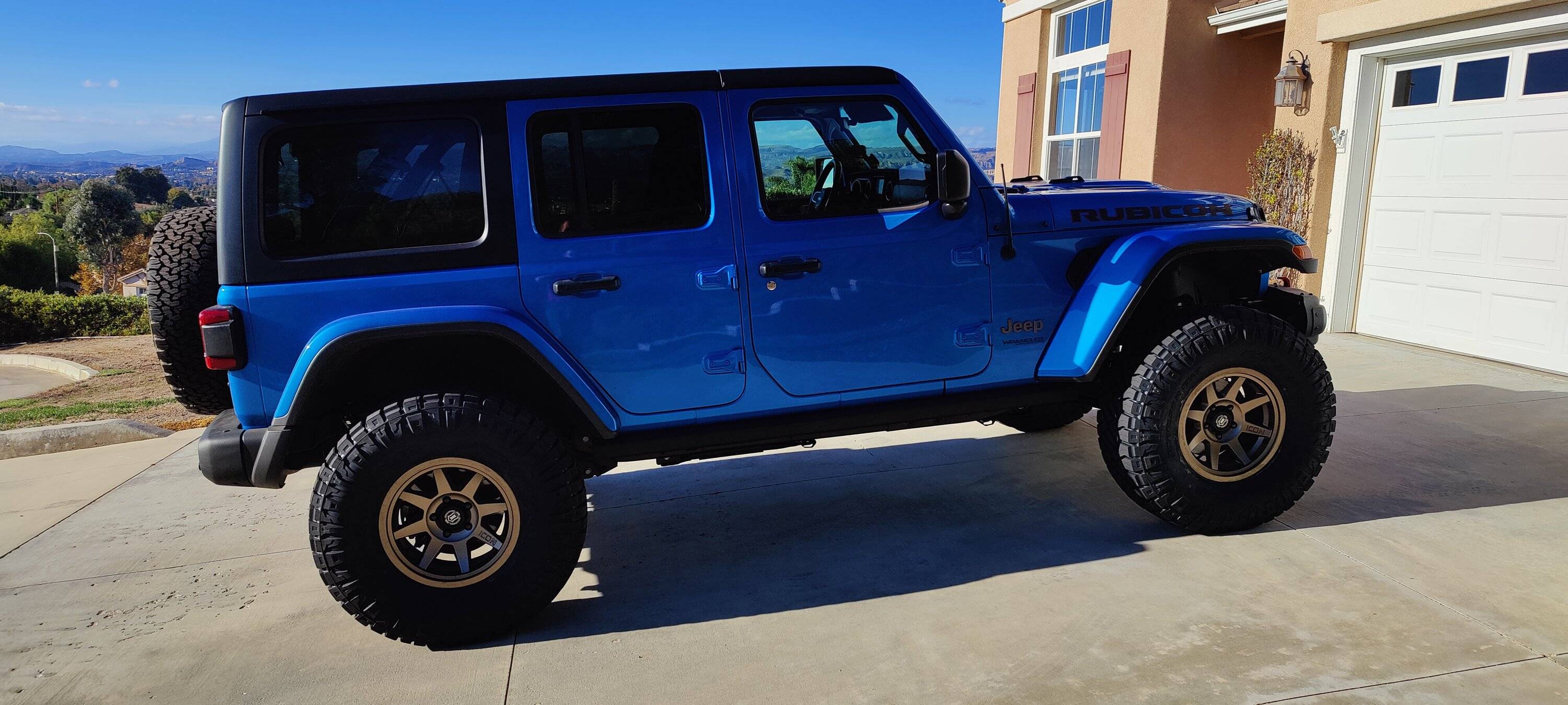

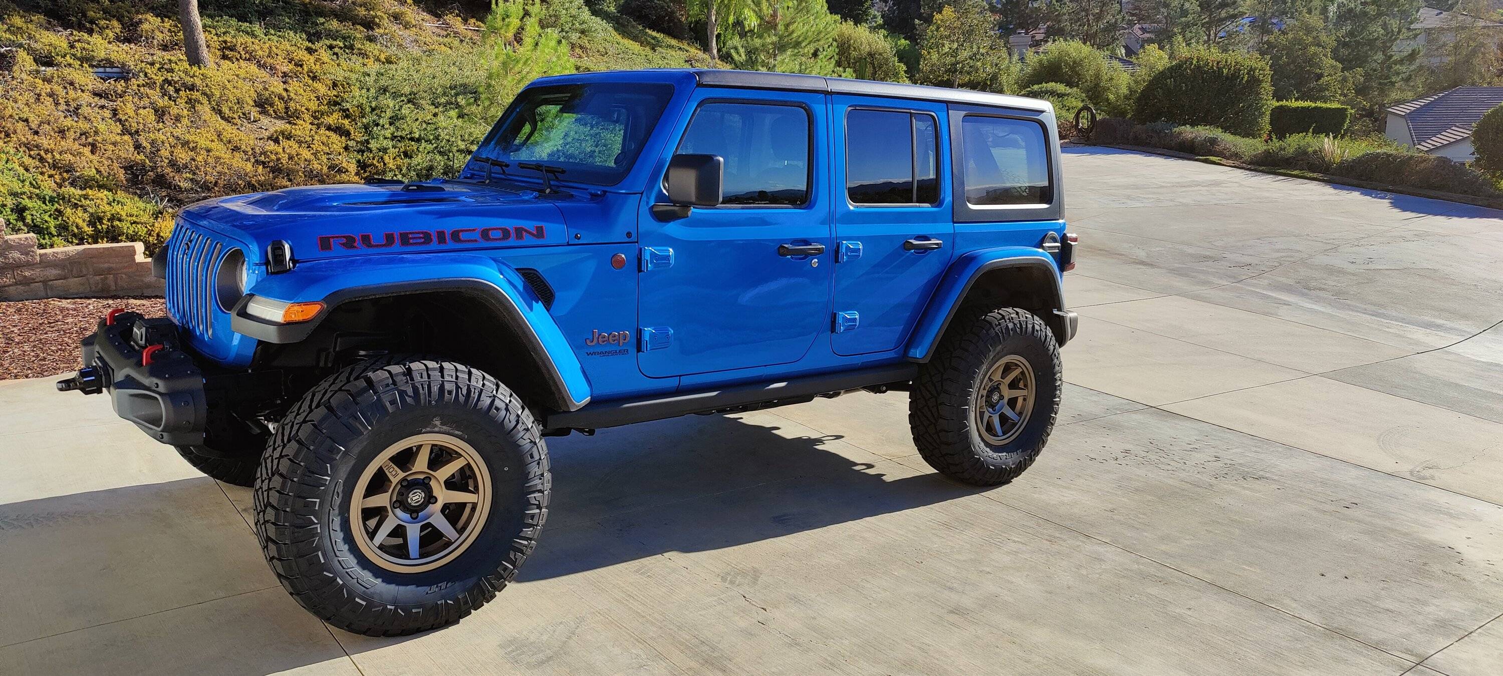

Tires mounted and installed on the Jeep. Looks awesome! Happy to hear your thoughts!
I have a set of these in satin black stacked in my garage, waiting for tires.

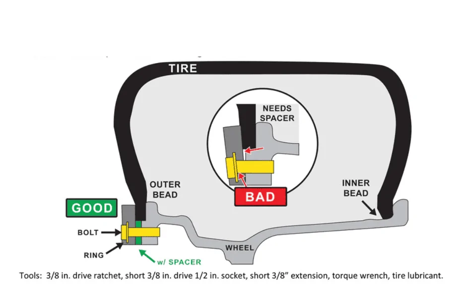

Link to FB page A broken leg and a wild accident to start SEMA!
Speculation
  • Leg not broken, nasty cut. See the leg pic which for some reason OP obscured.
  • Over torqued + anti-seize + over inflated
The Nitto 38x13.5R17's have such thick sidewalls they required spaces for my Raceline beadlocks. I not sure of the tire that failed, but this is what happens without a spacer with a thick sidewall:
