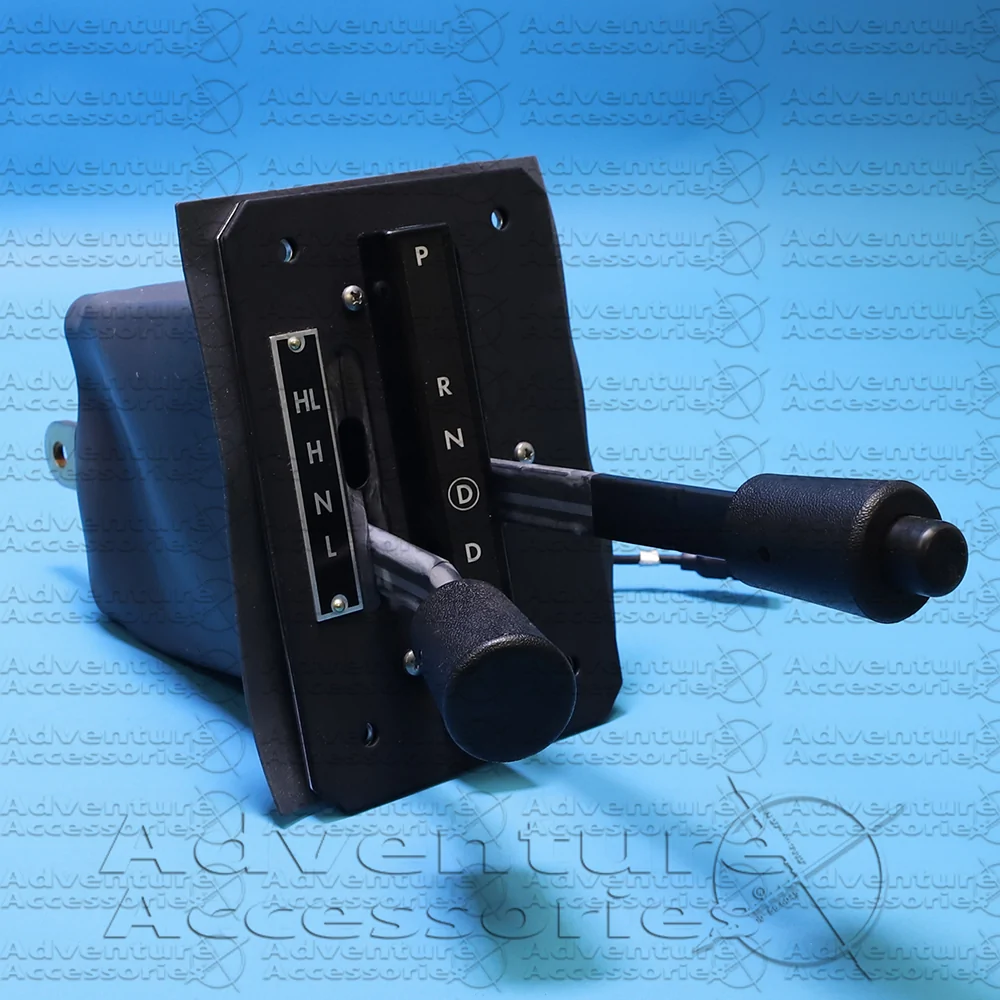

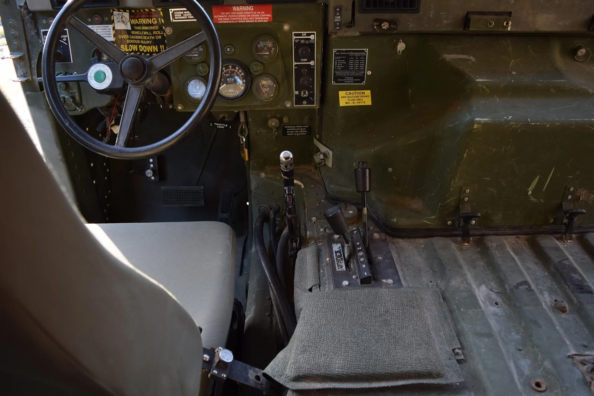

Ok not military but my Dad is a 90 year old Marine and I grew up around a lot of military. So I bet you had a few that even as simple as it was said…remind me again what the two levers do.
On the transfer case lever, “H” is for regular highway driving. “HL” and “L” are locked conditions for extra traction (“L” for extra torque).
