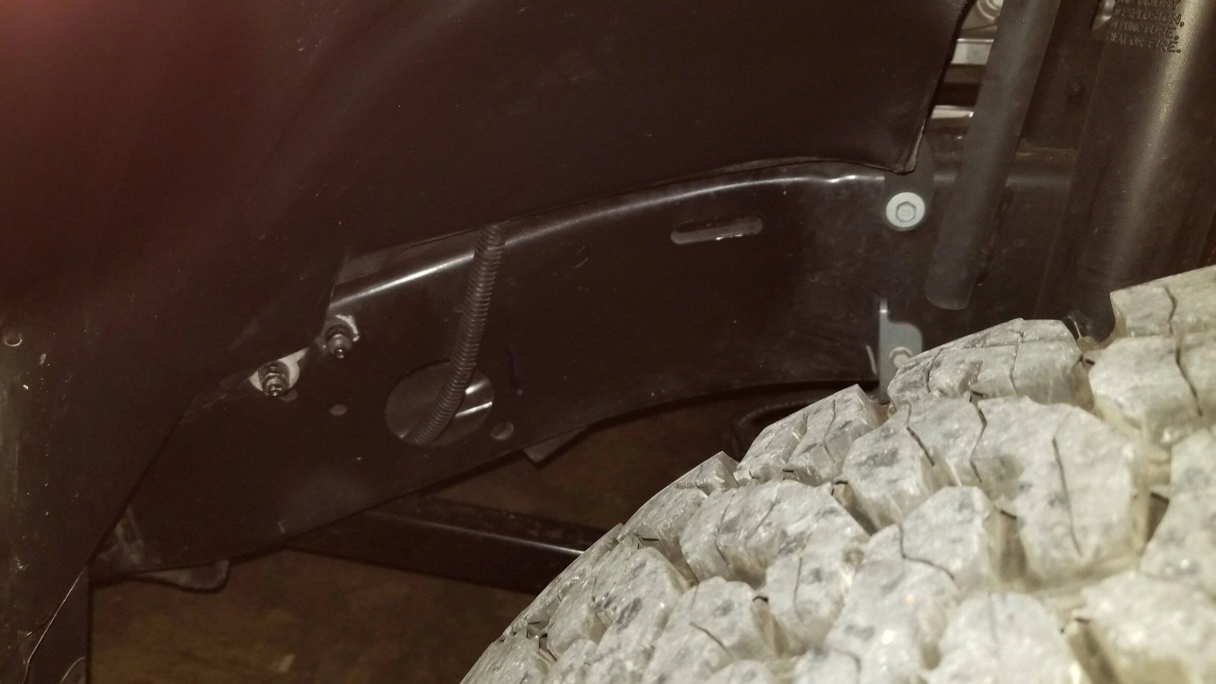

Found a pic I took of the plastic shielded, extension cable that drops down from the engine compartment into the wheel well.
You just tuck in the end of the cable into the frame rail. It stays in place ..... no fear it would inadvertently come out on it's own.
The cable has an easily removable, tethered, plastic cap on it... You remove cap and plug in the battery tender.. Again no need to open the hood..

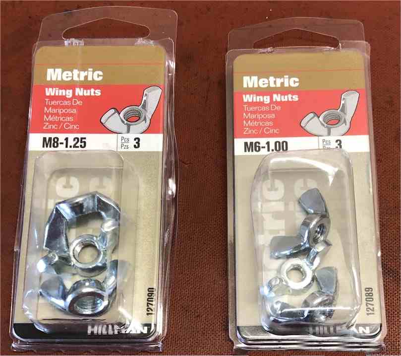

For those that want to buy Wing Nuts to use..
For # 6 on the battery pic below you need M8-1.25
For #5 on the pic below you need M6-1.00

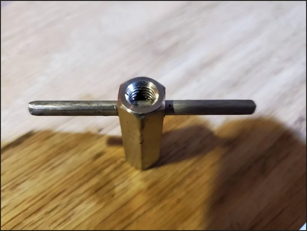

If you want quick disconnect nuts on on both, you can use a Wing Nut on one and a modded
Metric Hex Coupling Nut on the other. Do this and you can quick disconnect each when wanted and the nuts don't hit each other when loosening..

To make this.... take a stainless steel metric hex coupling nut, drill a hole in it and
then, take an aluminum nail and force it into the hole. Trim the ends on the nail and
smooth off the edges on the ends of that cut nail.
