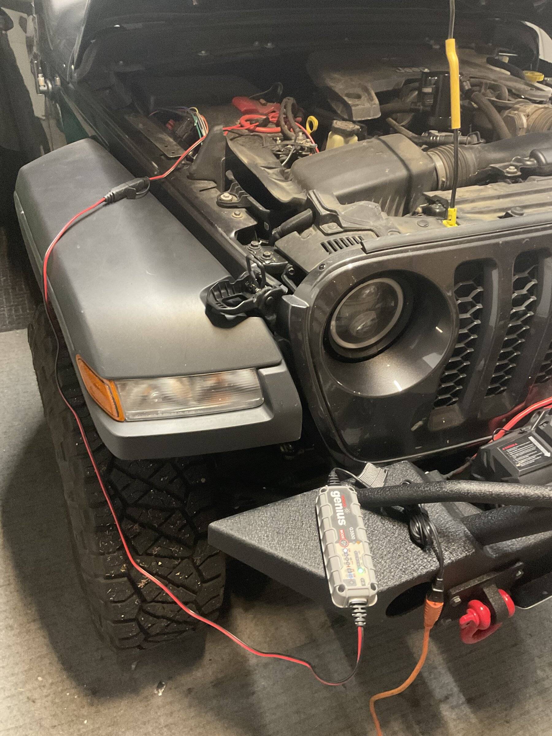

Mine is regularly on, it’s a good idea for sure. I have a Noco, with permanently connected adapter that came with it, has cover already That you can see. I’m connected to 3 and 5, don’t think it’s a big deal which you connect to.
Jeep Wrangler JL Battery maintainer question A9FA3FF6-00A8-4646-8507-20FF6B58327D
I do the same set up. NOCO costs a tiny bit more but I own three of them and never had a problem. Like you, I don’t use the clamps but instead, used the eyelet permanent mounts for quick connect/disconnect. I considered permanently mounting the maintainer as well but decided that probably won’t make it live longer. I’ve been using this set up on my boat, Jeep and Hellcat for years with zero issues.

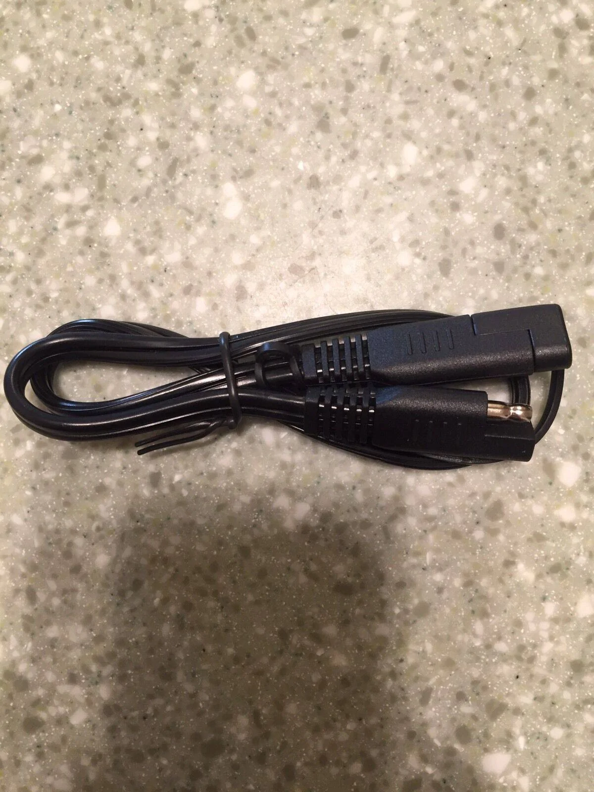

You could just buy a new extension cable and use that one you have without a cap for another thing.
Here is the exact 18" cable I bought / same vendor. Not expensive. Seller is aok ... quick to ship.
I have bought a couple from him over the last 2 yrs.. Has the 2 Pin SAE to SAE you need.
https://www.ebay.com/itm/112595846383?hash=item1a373c44ef:g:IRkAAOSwhQhY3lvr
For the plastic shielding buy at Harbor Freight... a couple of bucks for a few feet of it.
This is the cable I have. It has the cap I would just have to buy the plastic shield. I saw the posts saying to use 5 or 6 for negative but which number in that photo should the positive be connected to? I know I have probably read it on here but easier to just ask again than try to find it.
@TheNewGuy
In regard to your quick disconnect cable > For your Positive side of Main battery connection, connect to #4. Use #6 on the Neg. side.
All the back and forth in regard to what to use on the Neg side is due to the IBS sensor being on the neg side as it is.

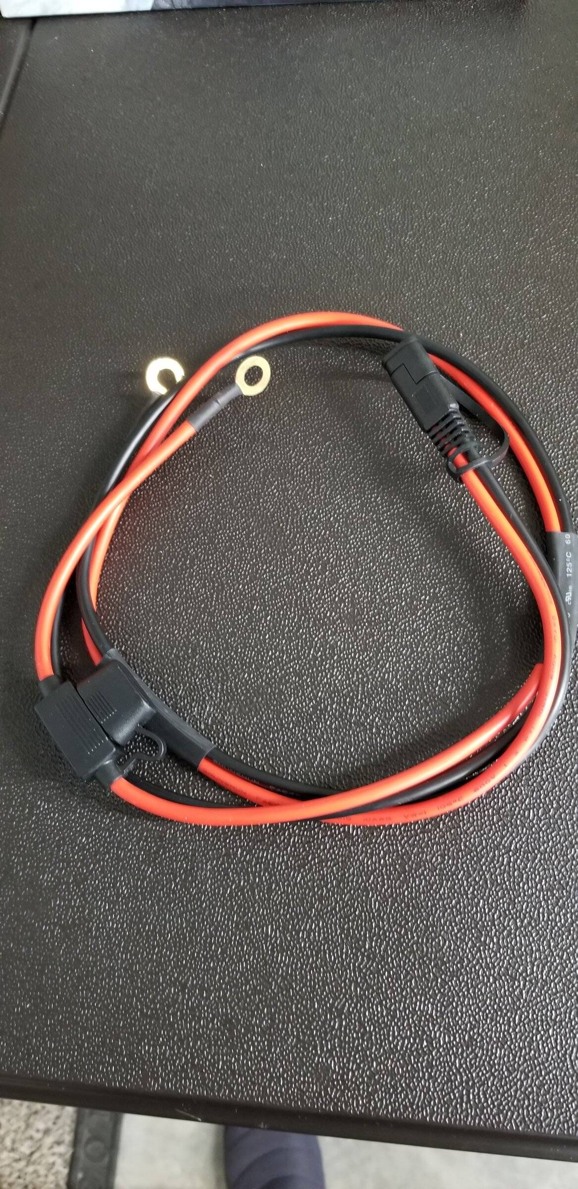

5 amp will do, 10 amp will do everything if you want the flexibility to use it on more than just your Jeep.
As for technical difficulty, you have nothing to worry about. You used more time and brain cells reading this reply than it takes to order and install the NECO Genius. If you use the harness, everything is plug and play and your spouse, kids, drunk uncle or mistress can connect the maintainer with zero fears of sparks, getting dirty or worse, accidentally reversing polarity.
The links below will get ya what you need. If you only want to use the maintainer on one vehicle, just order the maintainer and it will come with a clamp harness and an eyelet harness. You permanently mount the eyelet harness to the Jeep and use the clamp harness as a giant paper clip. Being a permanent kind of guy, I tossed my clamp harness in the trash.
LINKS:
Maintainer
Extra Harness
FYI - Pretty much every maintainer made requests the maintainer be connected to the battery BEFORE you plug the the maintainer into the wall. They want the maintainer to have the load sensed before it is energized to prevent damage to anything. Easy to remember, just thought I’d point that out.
True, but I would warn against charging both batteries at the same time. They are disparately sized and, while the Noco won’t complain, one would be better off disconnecting the AUX negative while charging the main and charging the AUX separately.
I now use a Noco-5 on my AUX and an Odyssey OBC-20a (6 stage - hell of a nice charger) on my main. Truth be told my AUX is disconnected and bypassed so I only maintain it once a month. With limited driving these days (pandemic) I charge my main every week.
As linked above, I developed this routine after an expensive and frustrating lesson.
