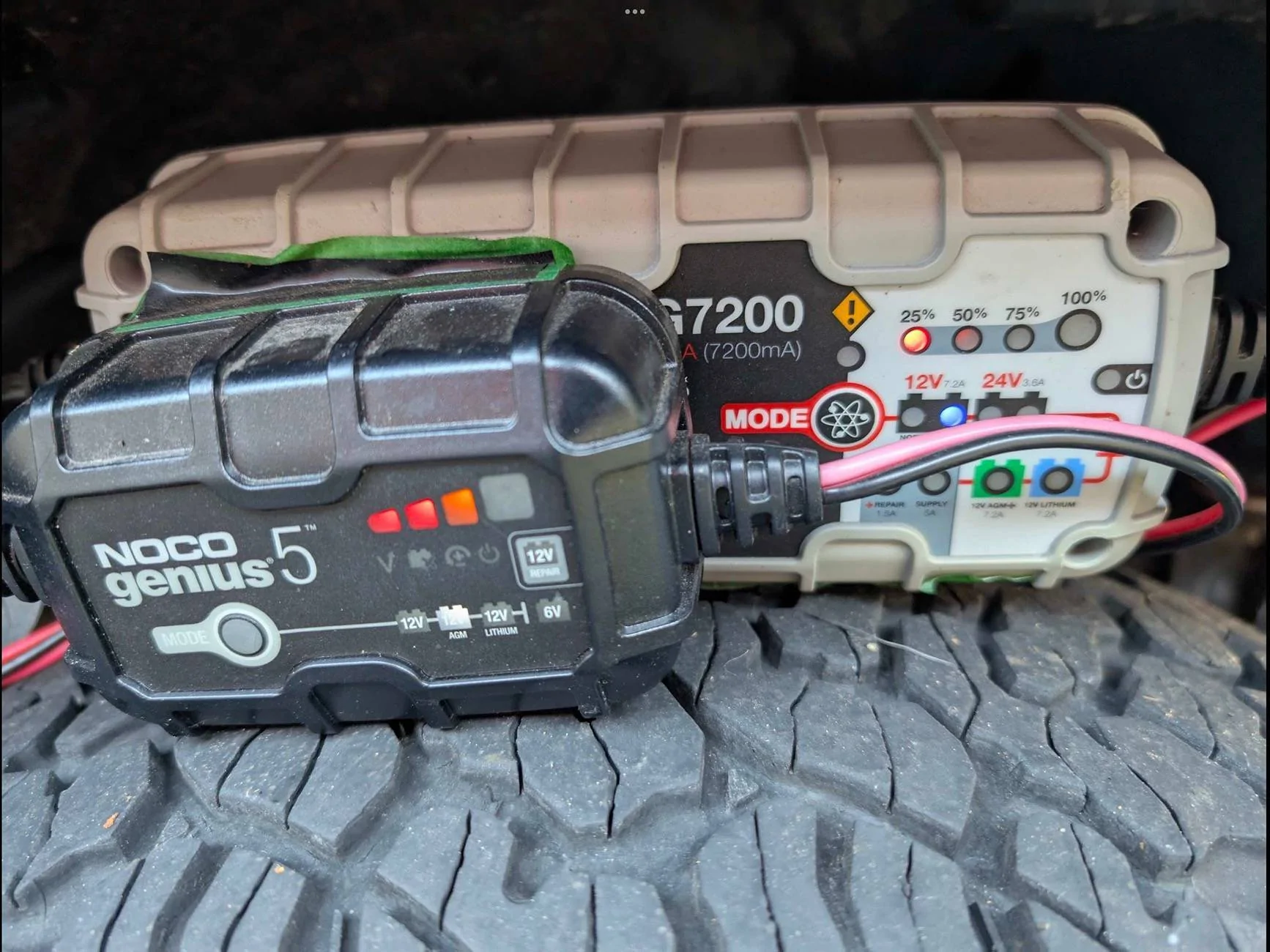

For the past 6 years have charged the puny aux and main separately with NOCO 5 and 7200. Zero problems. Always separately repair desulphate. Do this for all my vehicles - zero problems. But understand the reluctance and extra work to disconnect and buy another smart charger. Often my vehicles are stored months at a time and when operational are driven infrequently and only as needed. Since most my daily travel is now by unrestricted e-bike which is a ton more fun. Wearing D3O moto gear and DOT helmet. WTF.
Last battery changed out was Porsche that lasted only a shitty 12 years. But that was on a shitty CTEK that had no repair mode. Bought a NOCO 10 so the CTEK is now sitting lonely as a spare. Porsche branded the base CTEK and sold it as the prescribed charger for a BS 4x markup. Yeah have 5 NOCOs and 2 CTEK - all very shitty smartchargers.
Poor lonely CTEK. But really continue to charge together. No argument there. To each their own. Haha!
