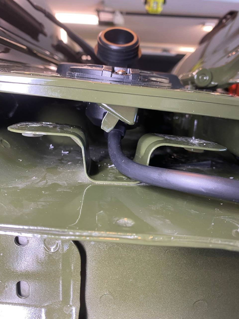

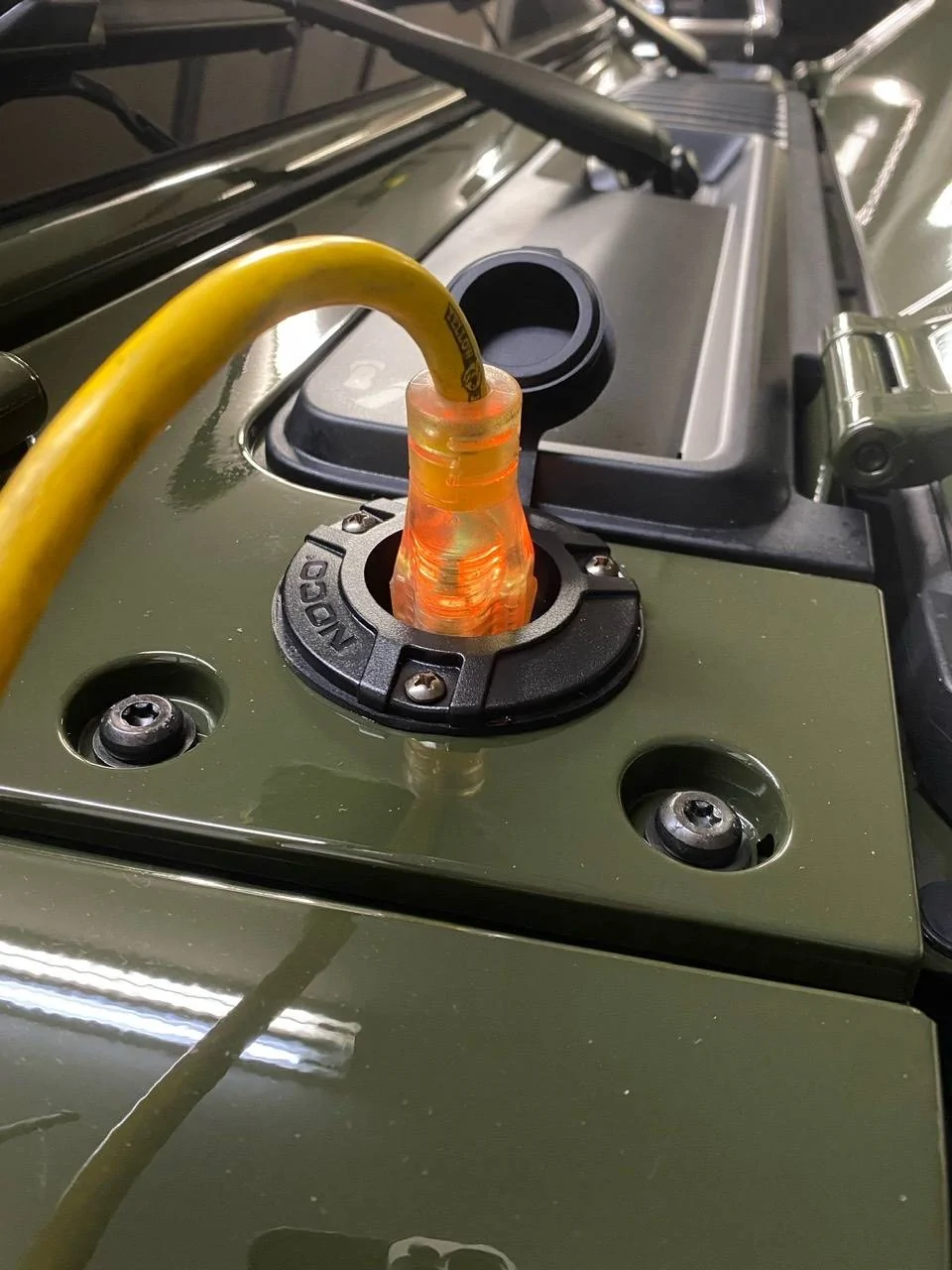

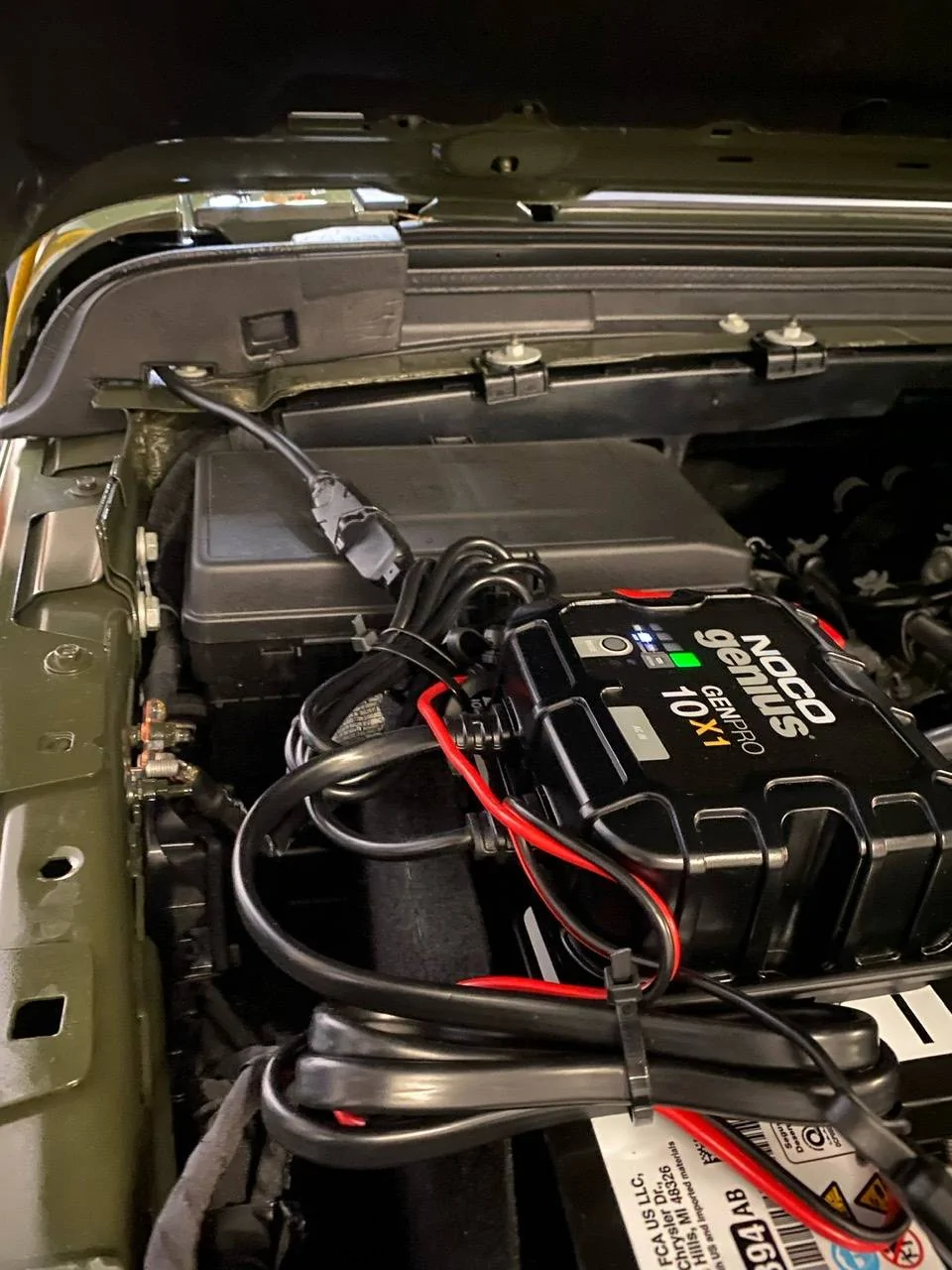

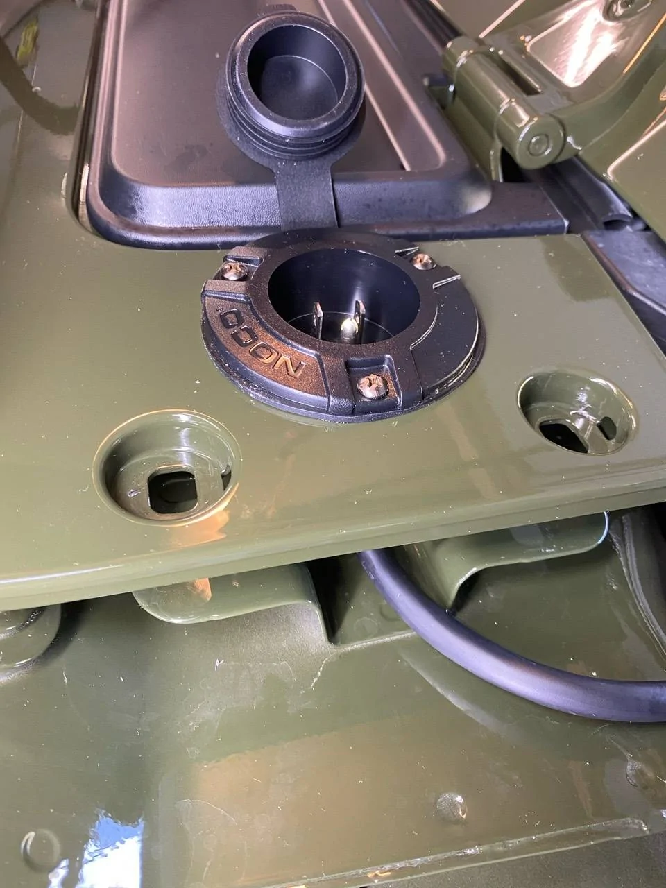

I installed the Noco GenPro 10x1 on top of the battery. Then routed the power cord over to this area with a Noco AC plug…

Here’s additional photos for your reference if interested in this location…

This reminds me….I have to wrap the wire in wire loom. ?

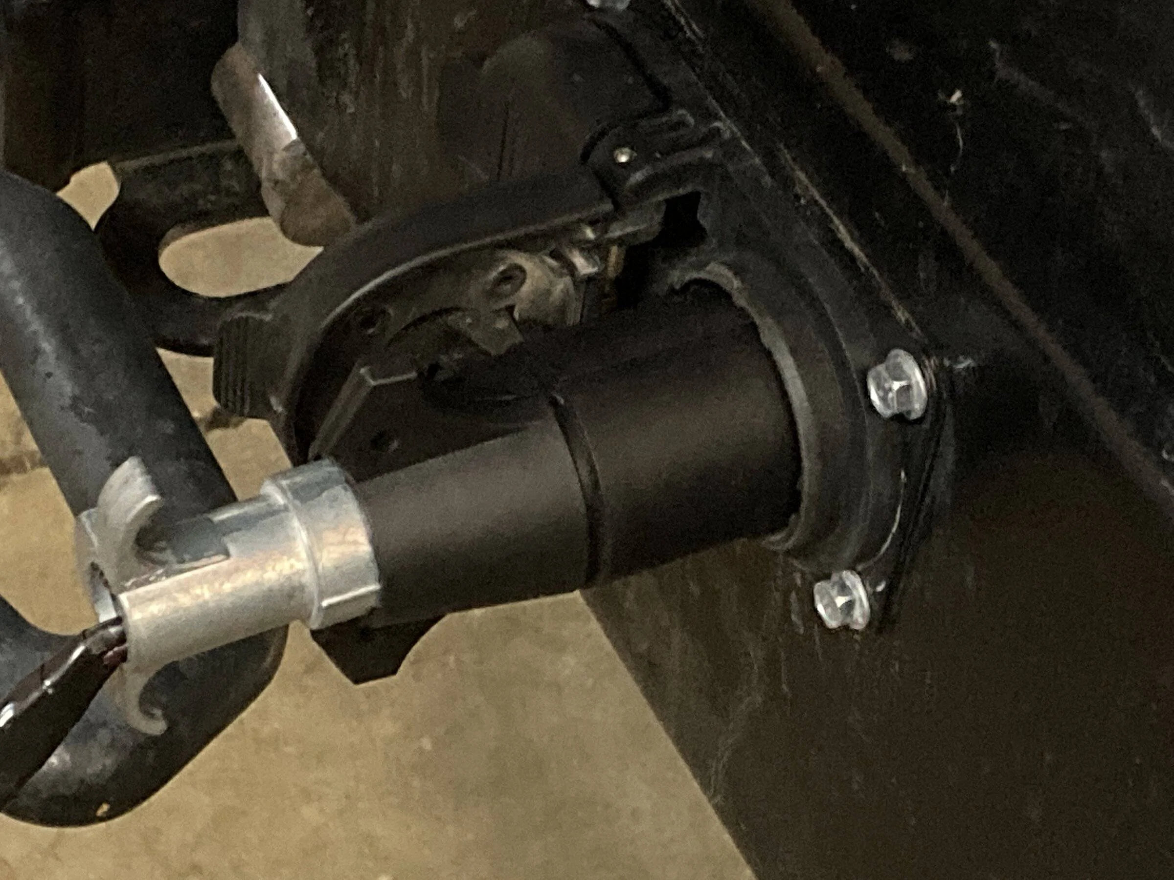

Jeep Wrangler JL Routing cable for battery tender? 62401DCE-0D46-4E07-9C8C-535C0837D36C
I wired my Battery Tender into a six pin trailer plug I already had and then used a 6 to 7 pin adaptor and just plug it into the factory trailer plug.
