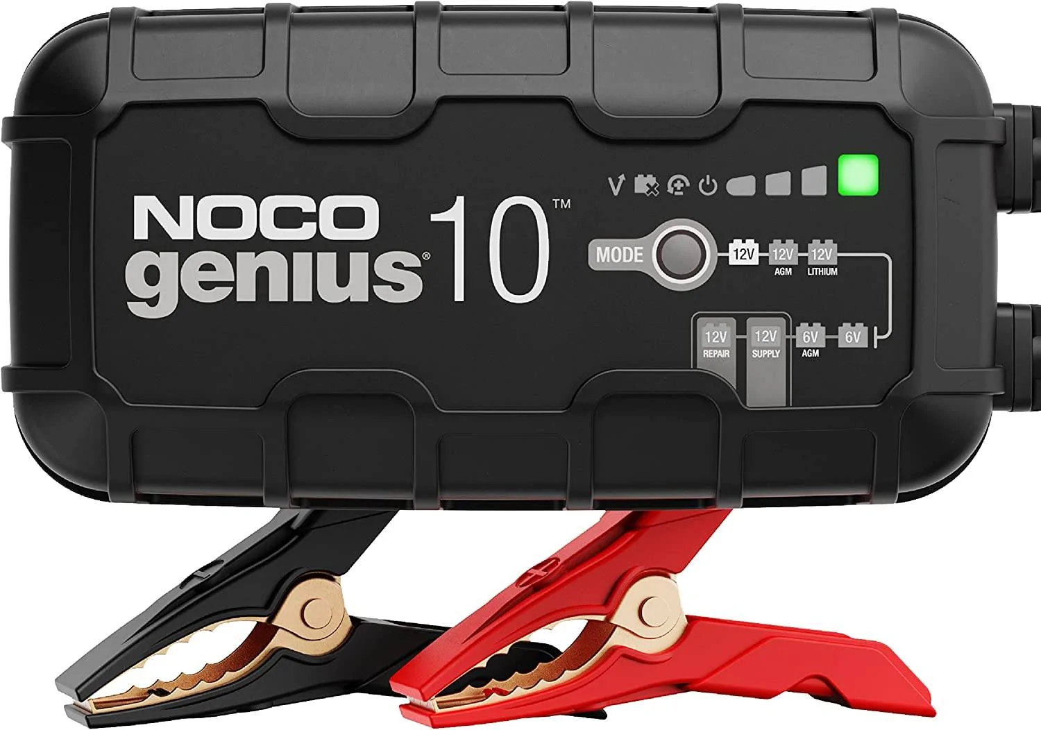

Interested in buying a Noco 10... Right now they are on sale at Amazon for $84.70:
Very good sale price1
https://www.amazon.com/NOCO-GENIUS1...p/B07W3QT226?ref_=Oct_DLandingS_D_b06d3b03_60

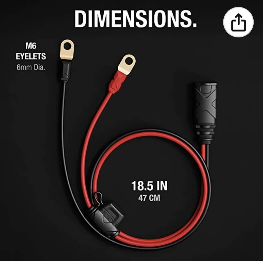

It’s a solid battery maintainer. I use mine for the Jeep, portable generator battery and my spare UPC batteries. I order extra eyelet cables and “hardwire” the connector to my devices. doing that allows for quick connection without raising the hoods or jacking around with clamps.
https://www.amazon.com/NOCO-GC002-E...ive&sprefix=noco+cables,automotive,129&sr=1-3
