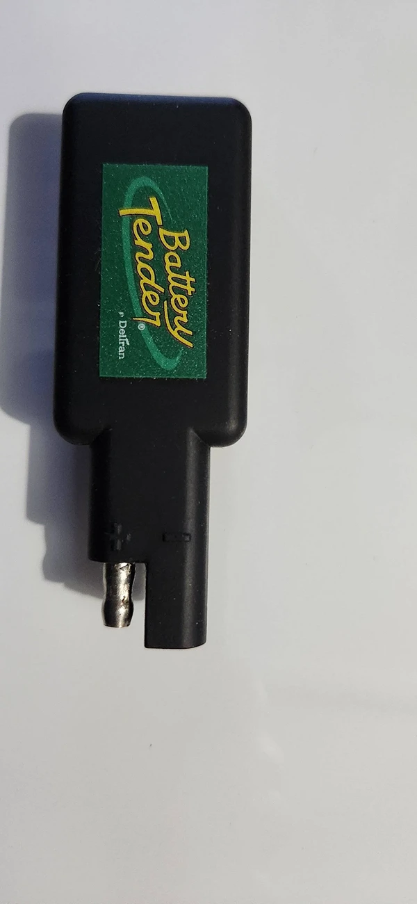

Yeah, I just ordered one myself. I bought a Battery Tender 5 amp but I will be returning it.
I had no idea about any of this and I used to maintain my '06 Wrangler with a Battery Tender through the cigarette lighter. I did feel that I had to buy a new battery far too often. (Though 18 years is still a long time to keep a daily driver.)
The other plus is that the Noco cigarette lighter plug attachment looks far more well made than the Battery Tender one I had. Once I dropped the BT one and it broke apart.

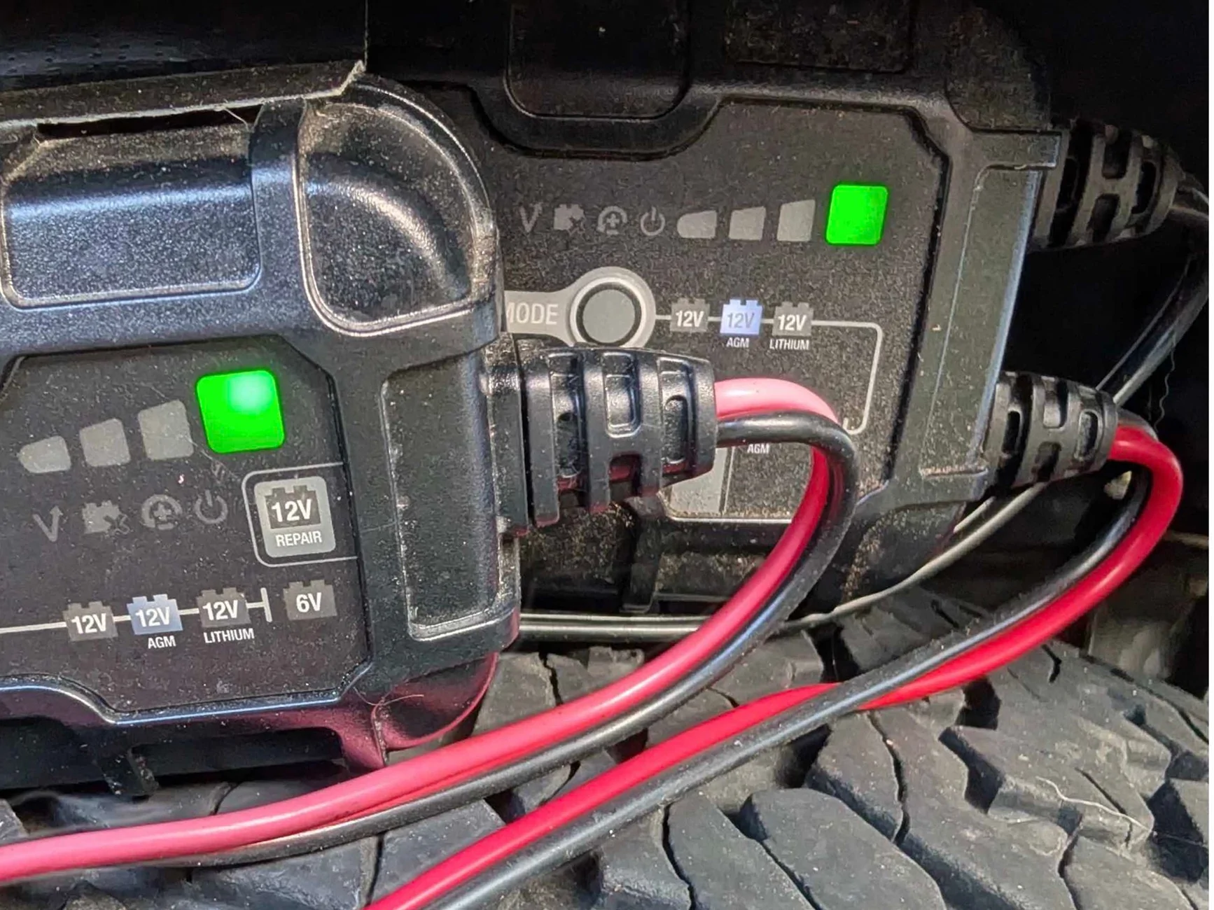

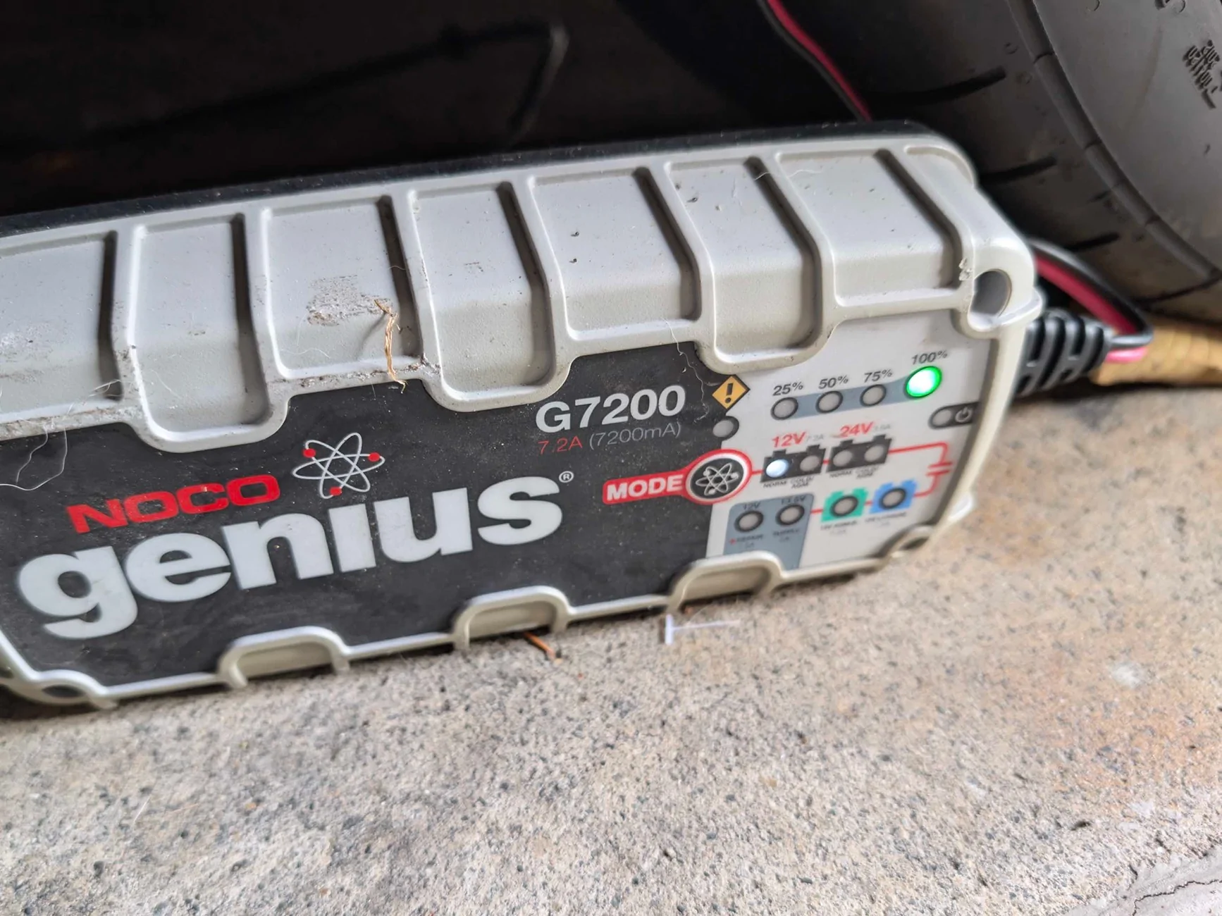

We have been charging each Jeep battery separately since new and each 2018 OEM is still fine. Our aux actually is stronger vs the main. All our batteries last 12- 14+ years before replacing when smart charged and desulphated. So see no need to vary at all what we do - especially when reports on this forum talk about replacing batteries after a couple of years. Sometimes even sooner.
Is odd that our Subie is not on a charger and is parked outdoors 24/7 with a 2017 OEM. So goes to show you do not need to be on a smart charger depending on the battery and vehicle. Here are a few quick pics of the chargers we have running at home at the moment. The 7200 was the predecessor to the current upgraded 10. We have 3# 7200 - 1# 10 - 1# 5 and 2# CTEK which were top of the line smart chargers way back 20+ years ago. The early CTEK did the job but the current NOCO tech profiles are significantly better.
Always smart charge using AGM mode for the Jeep. Do not use your old school chargers. We have one and have not used it in 20+ years. Of course as you know we are probs the only one on this forum that separates batteries because it works perfect for us. But each to their own. Do what you want and works best for you. This has all been researched and debated to death on this forum.

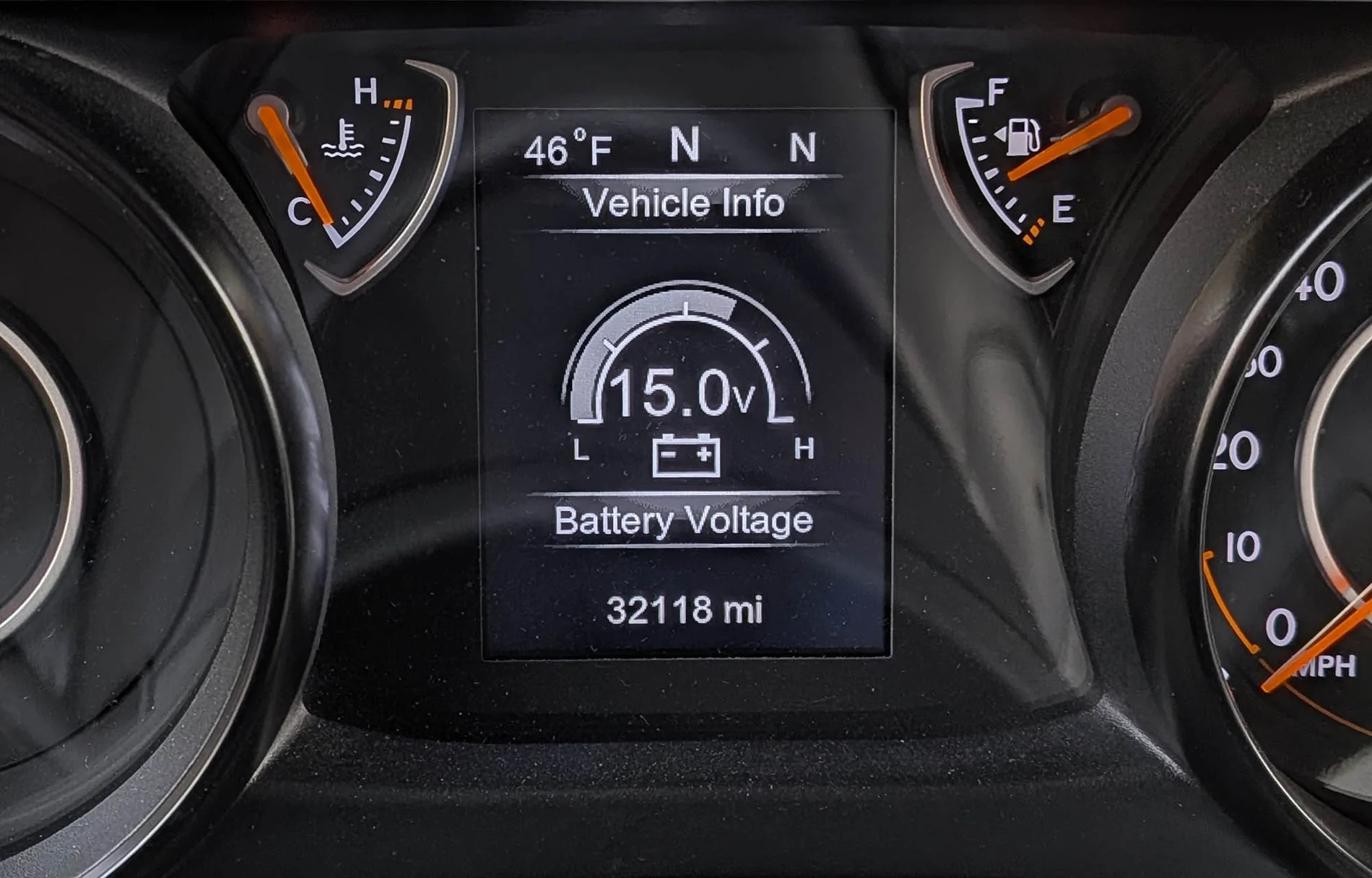

From all my research I've concluded that a battery charger only sees the characteristics of the combined batteries and knows nothing about the individual batteries. Since the ideal agm charging rate is .1C to .2C, for the 12Ah aux battery that would be 1.2A to 2.4A. For connected batteries, if I connect a 10A charger to the main battery, I wonder what the charging rate is to the aux battery. Whatever it is, it's probably not as bad for the aux battery as this 15V charging that I see occasionally.

What year is your Jeep? I wish I had the two small manual gauges on the dash. I just have the large screen.
2018, that's the base dash that comes standard on the sport.
