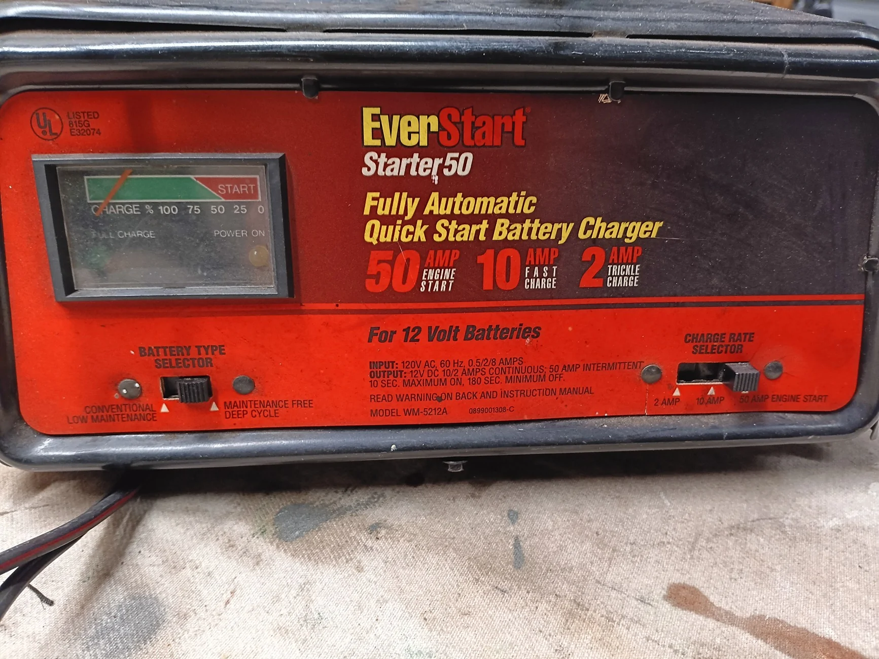

Is this charger ok?

Amp rating looks good. But overall it looks pretty old-school, so it probably lacks modern optimization for AGM batteries?
Thank you.
Yep, I'm reasonably certain it's 20 years old or real close to it. If I were to use it, should I use the 10 amp setting?
After reading and consideration, I believe its time for new AGM charger. I didn't realize how old my junk is. :facepalm:
