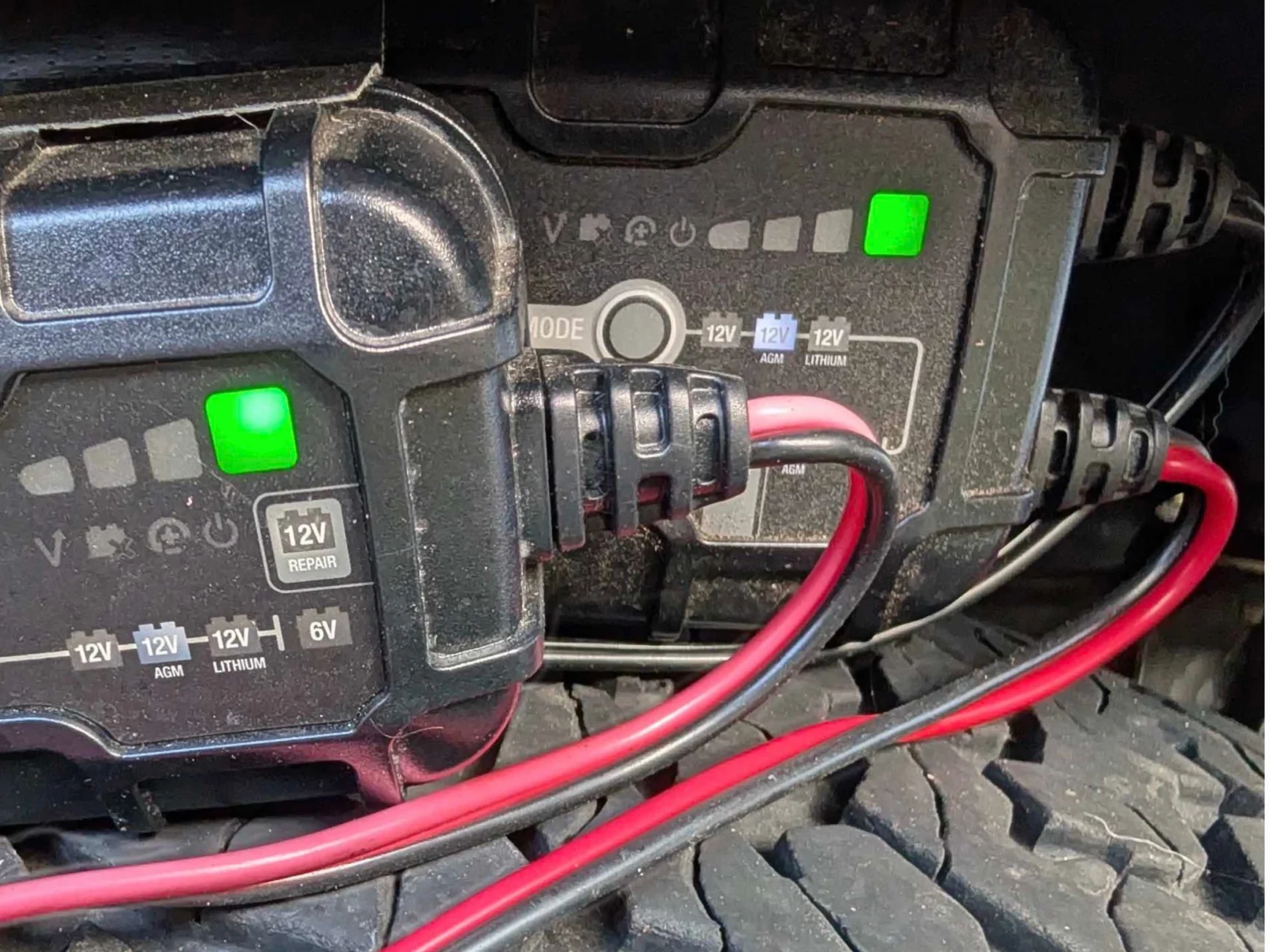

Formulas aside - from an anecdotal real world smart charging perspective - our 7 yo aux 200 original has been perfectly fine on the NOCO5 while our 7 yo main original perfectly fine on the NOCO10. Always charged separately.
Further it does not seem optimal to charge a 12ah with a NOCO10 - nor charge the main with an old school continuous 1A trickle charger. Our Porsche was on a 3.6A CTEK and it lasted ok but was not optimal - so is now on the 7.2 NOCO which should do a lot better.
In this pic the 5 in the front left is on the aux - and the 10 behind on the main. 7 years and running. No problems at all. Both should last for a good few more years easy. Always stored outside exposed to the elements 24/7. Jeep used only in the winter to get to very chilly ski resorts. Definitely works for us - but ymmv.
Using a charger religiously as essentially a maintainer (i.e. not allowing the battery to become discharged) helps ensure a too high charger Amp rating doesn't damage the battery.
In any case, a 5 Amp charger is a much closer match for the 12 Ah AUX (ESS) battery than a 10 Amp charger.
Yep both your comments are 100% valid based on 25+ years using our various NOCO and CTEK smart chargers. What kills batteries fastest are multiple deep discharges. Unknown to many is the specific model of a smart charger plays a huge role in what actually works and what actually fails for a particular battery. As this knowledge comes from actual user experience vs speculation or educated guess or projected estimation.
