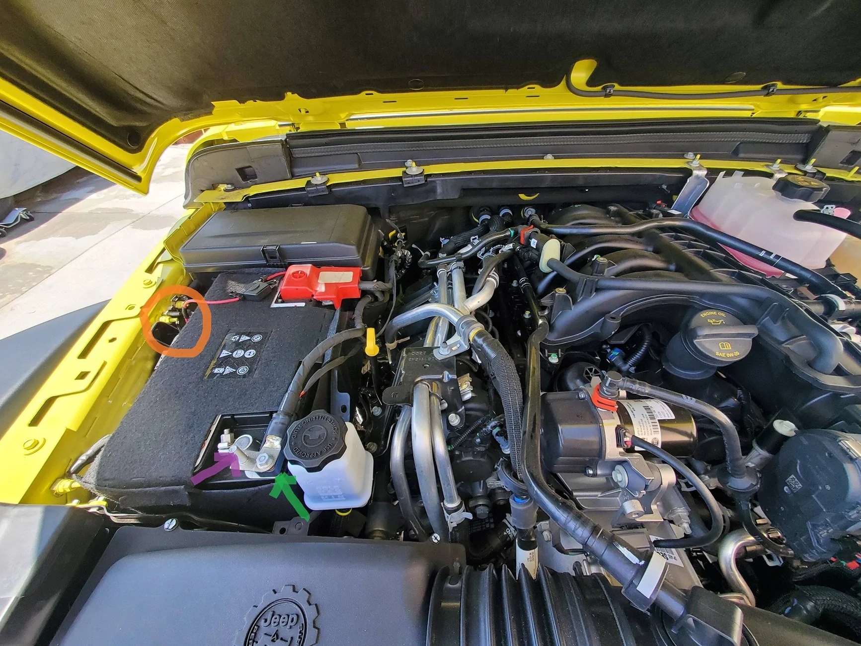

The charging needs you describe will only apply to your 12V battery. Off that battery's ground connection is the small IBS device , as shown on page 4 of this link https://static.oemdtc.com/NHTSA-PDF...5MDQ1NzMkbzEkZzEkdDE3NjI5MDQ2MTckajE2JGwwJGgw in the picture on the left, which also shows "a" place (IMO not the only place) that your charger's ground connection can be attached such that this IBS remains informed as to your 12V battery's state even as its charged from the external charging device you seek guidance on.
In the paragraph above this picture is the following sentence " Please note to charge through the IBS or tie negative clamp to Body/engine ground."
What this means to me is that you can attach the negative/ ground side of your charger to the point of this link's picture pointed to in purple below, or the body ground circled in orange.***
(The IBS is somewhat obscured in this picture pointed to in green, and the cable at this point has at its distal end the body ground.)
***There is more here than meets the eye IMO, is it regards attaching the charger's ground to that circled in orange. What I mean by that is while you may, if you wish, literally attached your charger's ground there, more to my point, and as you may be aware, many circuits in your vehicle use its metallic structure as a return path for electrical current: current that ends up at the point circled in orange, to then find its way back to the battery's ground via the aforementioned cable.

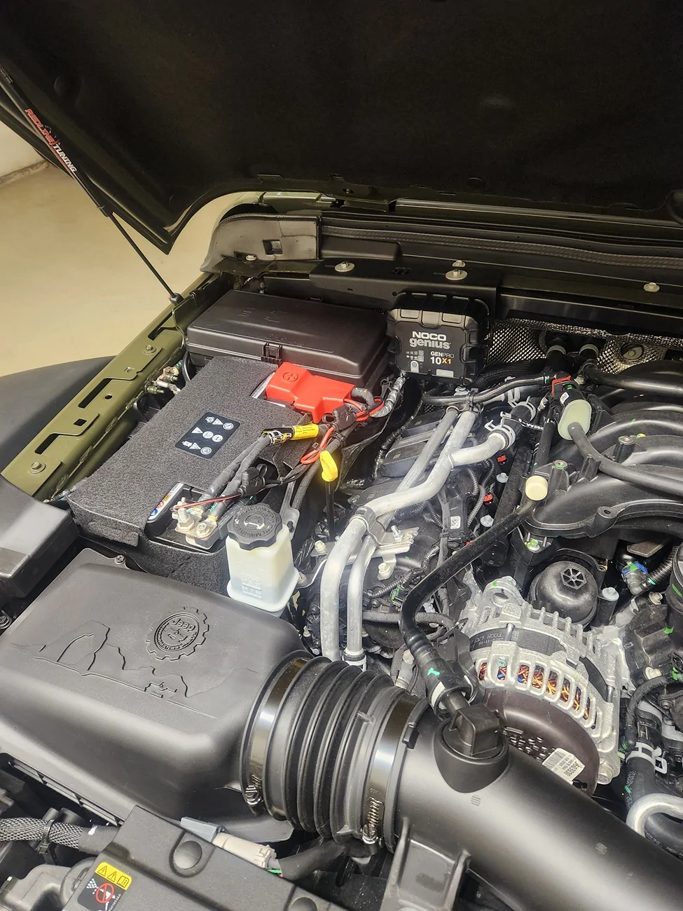

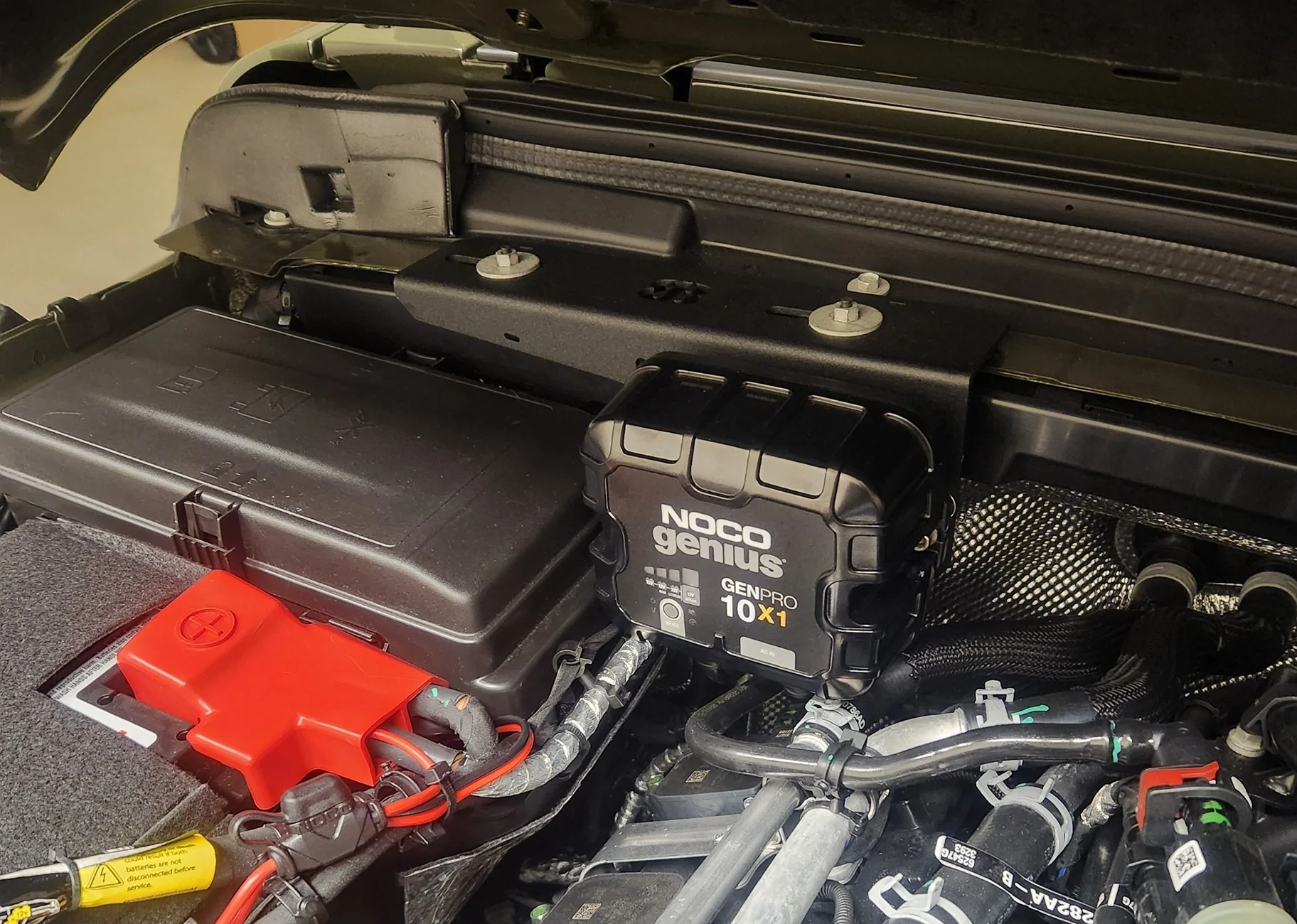

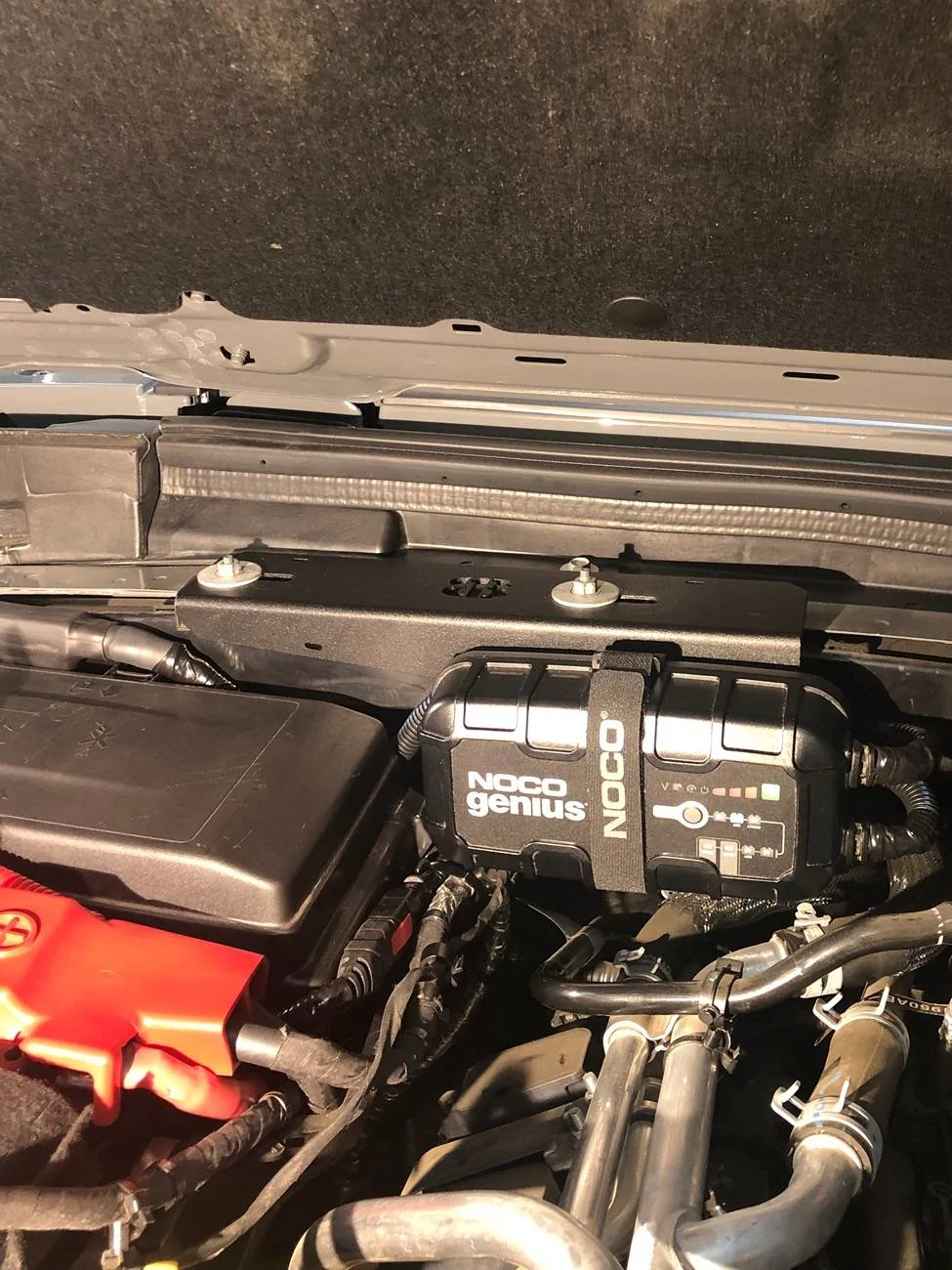

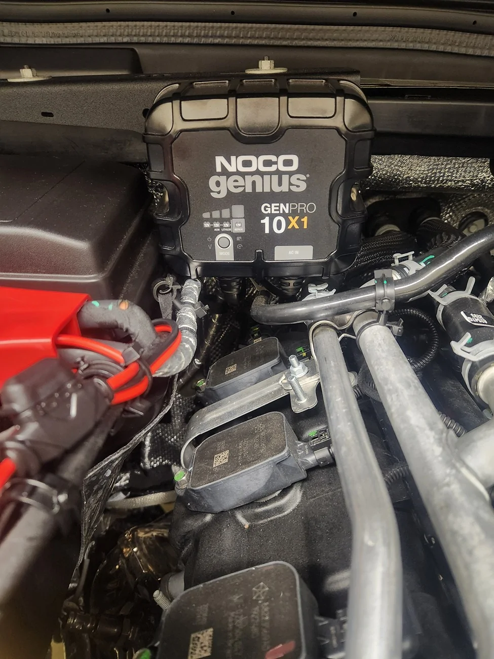

I also have been using the NOCO 10amp charger for almost 2yrs on my 2024. I installed one because my Jeep is not a daily driver.
I used the 813 fabrication bracket instead of a compressor. I looked at the mounts and figured it would make a clean install. Anyways it turned out to be a great setup. The wires/harness coming out of the bottom have about 3/4" clearance from anything.

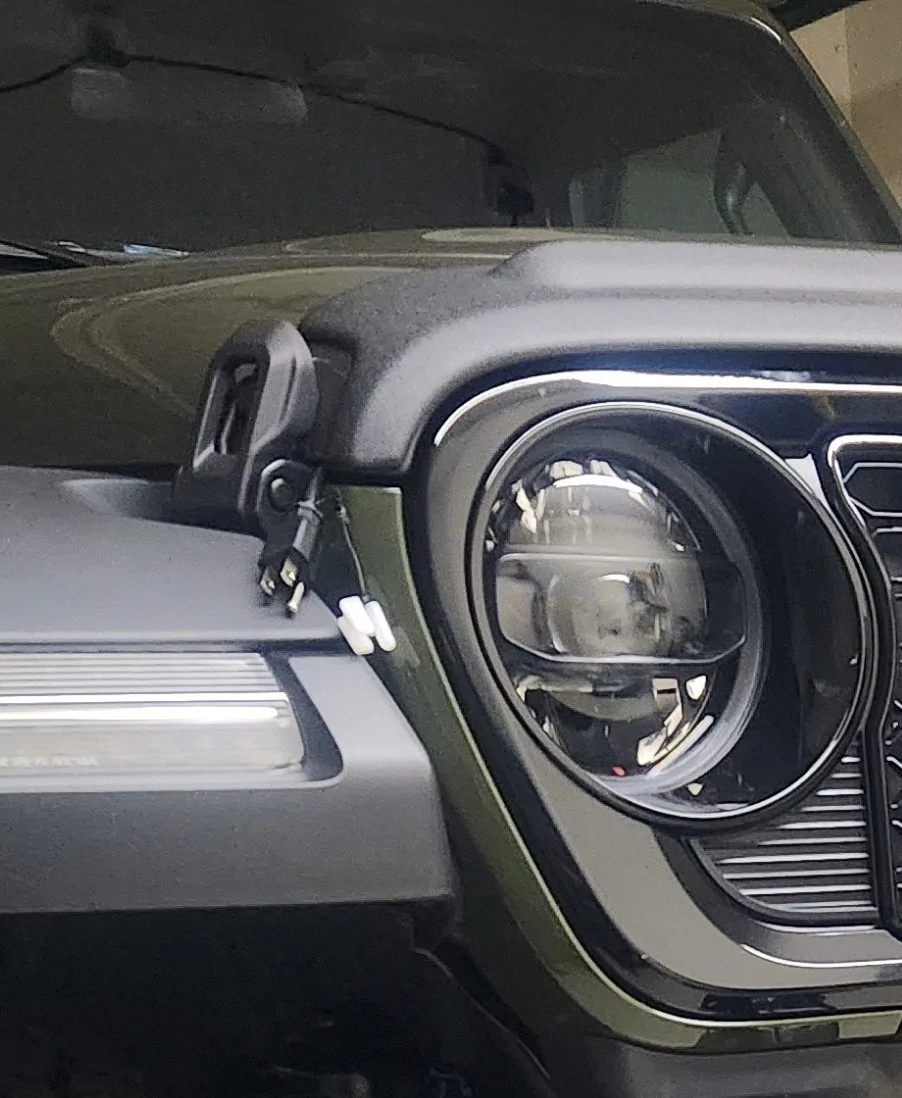

I ran the 110v along the top edge of the fender and then out above the passenger headlight. It is easy to put it back under the hood when driving. I was going to mount a through firewall connection near the bumper, but never got around to it.
https://813fabrication.com/products/jeep-jl-gladiator-underhood-arb-single-compressor-firewall-mount
I ran the 110v along the edge of the top of the fender and then out above the passenger headlight. It is easy to put it back under the hood when driving. I was going to mount a through firewall connection near the bumper, but never got around to it.

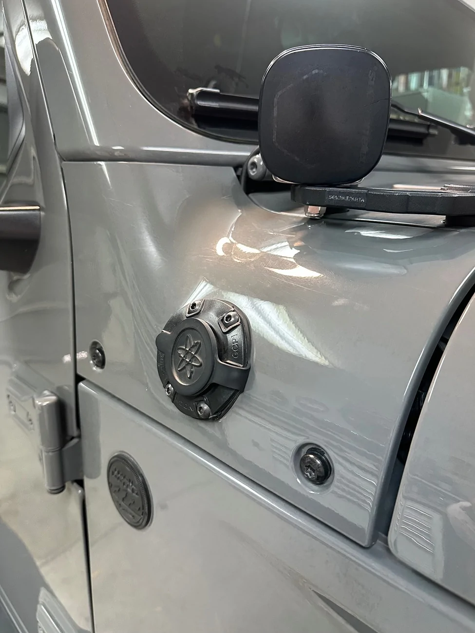

I did the same but added a Noco AC port. Not super attractive, but it’s convenient. This Jeep isn’t going to win any show and shine awards anyway.
How much of a problem was it to bend it to that curve? It looks like it took some persuasion.
10,986
33,922
It’s thick rubber with a rubber gasket, but the newer style has only 3 mounting points. I bought a couple of the older style that use 6 points off eBay. I used black stainless 1/4-20 hardware including washers and nylocks and just tightened gradually around the perimeter. There’s not a lot of pressure on the cowl piece but you can see the rubber is not 100% flush otherwise the cowl would start to distort.
Yeah, thanks for confirming. That's exactly why I haven't put one of those on my Jeep yet. The easiest spot to put it is still awkward. I haven't settled on an easy enough spot yet.
10,986
33,922
There’s not a lot of wiggle room for the power cord on the port itself or the back of the recessed portion of the port within the cowl area. Measure 12 times and you get one shot with a hole saw. There’s better ways to do it that are more aesthetically pleasing for sure.
