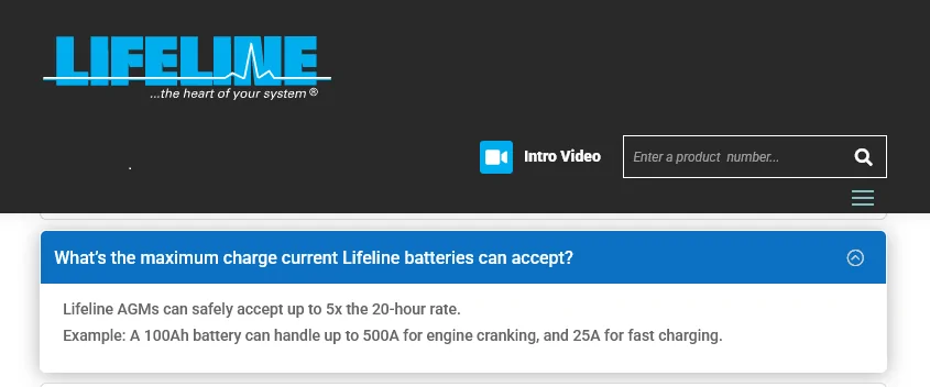

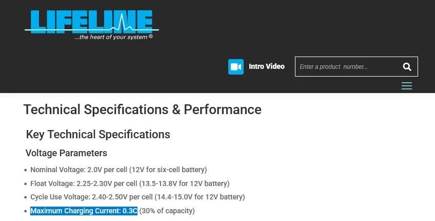

Max charging current is listed right on the website:
Jeep Wrangler JL battery charger lifetlineAGM
And, immediately below the excerpt from the technical manual you deceptively decontextualized and poorly interpreted:
"For example, charging a 100Ah battery at 40% DOD with a 25A charger would take:
[(40/100) x 100 Ă· 25] + 3 = 4.6 hours to reach full charge.
If a 10A charger is used, it would take:
[(40/100) x 100 Ă· 10] + 3 = 7 hours to reach full charge."
There's a reason an industry standard and "practical" 0.25C charge rate was used as the upper bound in Lifeline's technical manual examples demonstrating the difference between fast and slow charge cycles, and it wasn't lawyers.
