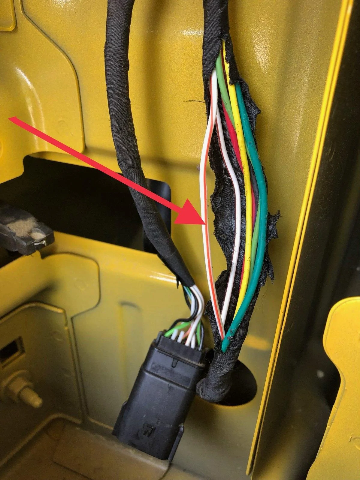

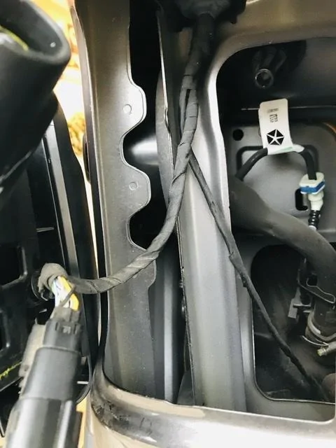

So I’m neck deep into this and as usual getting hung up. Long story but my questions are
- what gauge is the backup light wire? I need to know so I can get the right Size positap (nobody carries it around here so I am ordering it) The splicing product I got will not work.
- where did you all mount the ground? There are a few bolts on the body within the pocket for the tail light housing...?
and in the picture below which bundle can I access the beige/white backup light wire?
This “easy” mod has reminded me why I avoid electrical work all together.
Should be 14 to 16 gauge wire, I used simple T-taps, works well and is weather resistant and can be found at most auto part shops.
The wires right before the taillight connector are easy to access, just unwrap a bit of the tape to expose the wire group.
