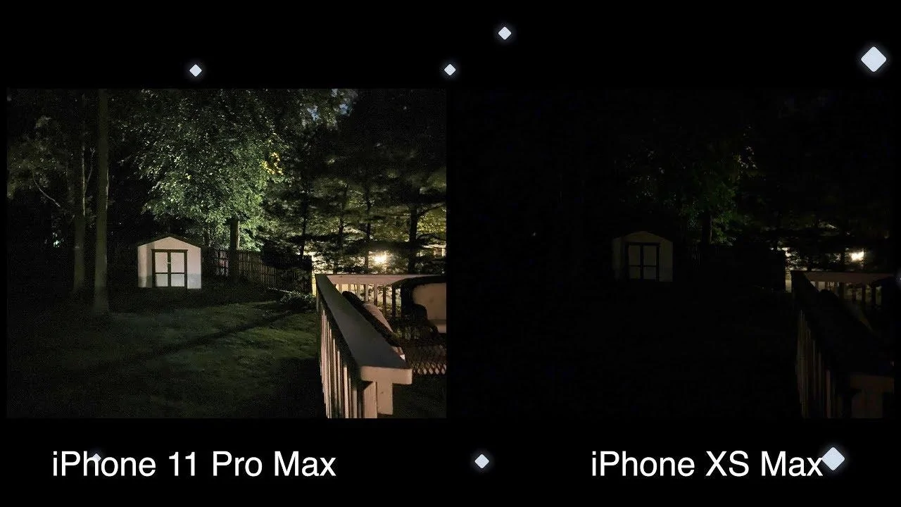

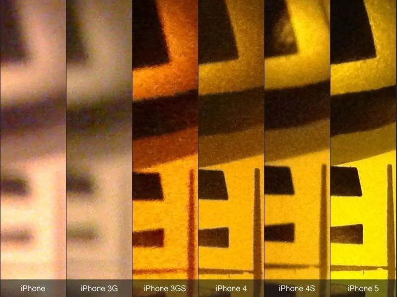

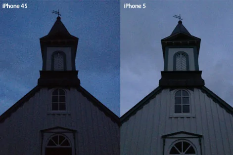

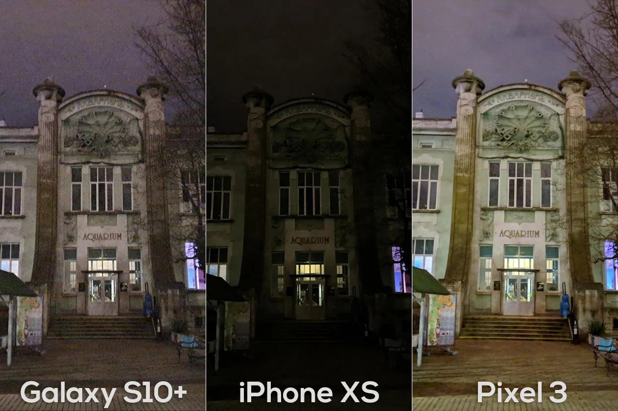

I can't say what vehicle has a better camera than the JL, but I do know that better cameras exist and that their differences are apparent in low-light situations. Most everyone can agree that the JL's camera sucks at night, but the majority of the suggestions here are basically to "make it not night" with brighter lights. Upgrading the camera is another method.
It's not about resolution either. Take a look at what cell phone cameras are doing. I know that there is some software being applied to a some of these, but the sensor itself can actually make a difference.

As for what you said about low light visibility, the software based (and optical image stabilisation) approaches in phones are mostly to reduce blur from shaking hands when using relatively long exposures. For a vehicle the difficulty is not only in getting the exposure but having enough sensitivity to be able to have usable frame rates plus having low latency. If it's for recording and if you want to make out plates by pausing recorded video, shorter exposures are needed as well. So, even if it's SD resolution, like you said, there's massive room for improvement in terms of sensor quality and optics.
