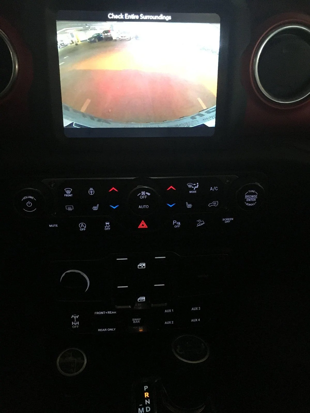

Got the guide lines disappeared after the software update (which brought back the off-road pages). As soon as I tried the new "backup cam" app the lines disappeared. The warning beeping still works and I saw the lines only once since. Tried to change the settings but with no luck.
