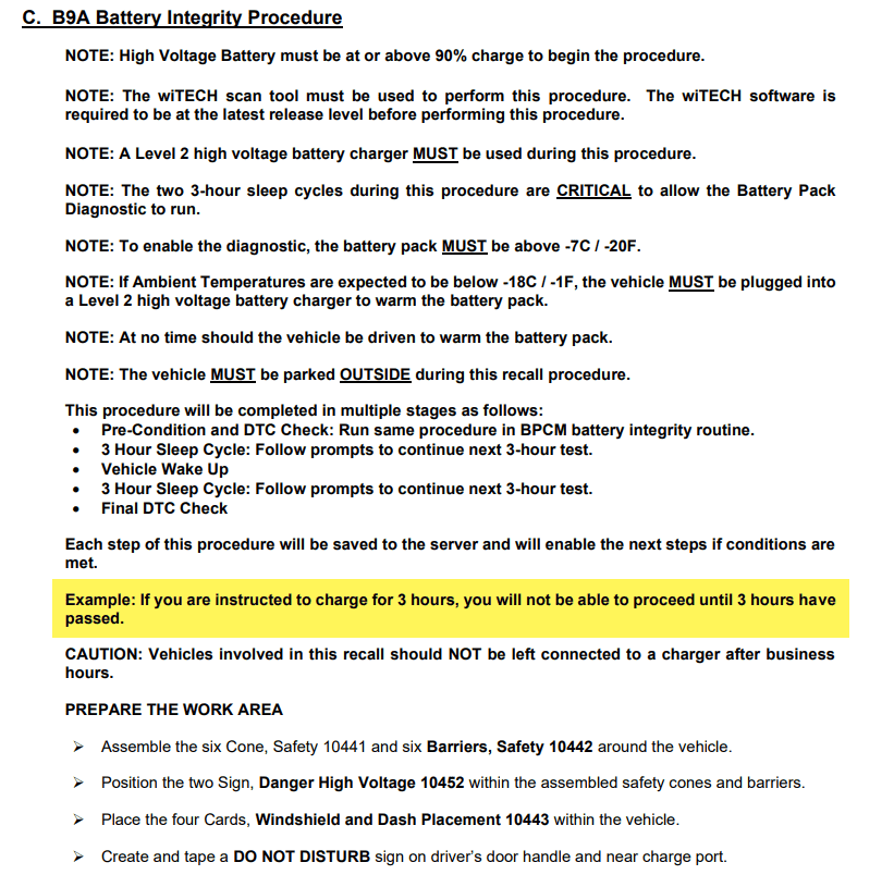

Here's the recall document. I personally have not completed one of these recalls yet, so it's possible what they're saying is true. However, no where in the recall document does it mention returning the vehicle to the customer after the initial flash and integrity check. It explicitly states that after the flash the integrity procedure must be run, and it will consist of two three hour sleep cycles. It's possible the first integrity check instantly confirms the battery is OK and wi-tech clears it, but you'd think they'd mention that part in the document as they usually do.
I don't believe my dealership is offering to perform this recall at the moment due to low charger availability, as being the hybrid guy I should've gotten one by now.
Thank you for posting that!
I do see what you're saying. It does read like the sleep cycles are part of the battery check. The only statement I can see that would indicate they don't need to run the cycles is the "IF" statement below. ie IF you are instructed to charge for 3 hours.. It does not say you MUST.
That makes it sound like if the Precondition and DTC check don't give you an indication to run the 3 hour cycles, you don't need to.

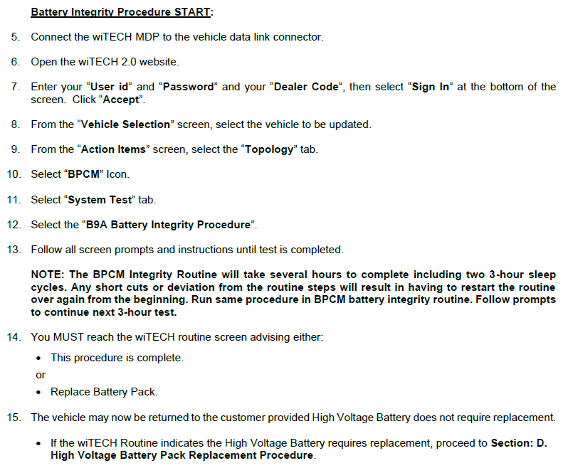

This is the exact procedure the technicians follow. It is the bulletin itself that tells us what to do, how to do it, and what it pays in addition to all the other information related to getting the claim completed. It is not 7 pages long as you can see.
Under section A, it states:
Jeep Wrangler JL B9A recall is available! 1709934355969
However this is mentioned in step A which is before you actually perform the flash updates, which is step B. The full integrity testing takes place in step C. It's possible wi-tech just checks out here, says you're good to go, and all the updates and sleep cycle integrity testing are completely unnecessary, which would be hilarious but I doubt it.
This would also mean the recall paying the same 0.6 hours for the entire testing process as if you just updated the module and shipped the vehicle. Which believe it or not is par for the course at Stellantis.

Thanks a ton, alpha! I just read the whole document, and it was good to get an idea of how things are supposed to be done.
It does seem that perhaps after updating the software, tech are not performing the integrity check - which of course is the whole purpose of the recall: to identify defective cells. If they're not doing at least one 3 hour cycle, it doesn't seem that is being done. A lot does seem to be left to wiTECH providing instructions, though.
