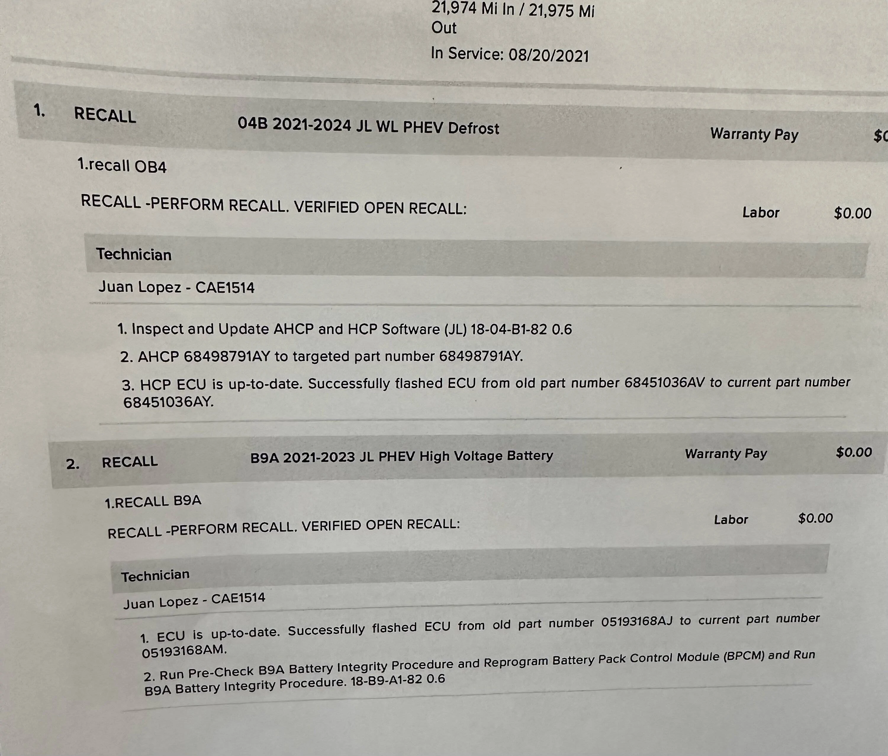

Dropped my 4xe for the 2 recalls this morning at 9:40 am battery at 8% and they called me at 1pm it was ready for pickup. This is Chapman jeep in Scottsdale AZ.
I hate to say this, but it doesn't sound like they actually completed all of the steps required for the B9A recall...
This doesn’t sound like enough time to do the B9A. Especially when you factor in that they also say they fixed the defroster recall in that same window.

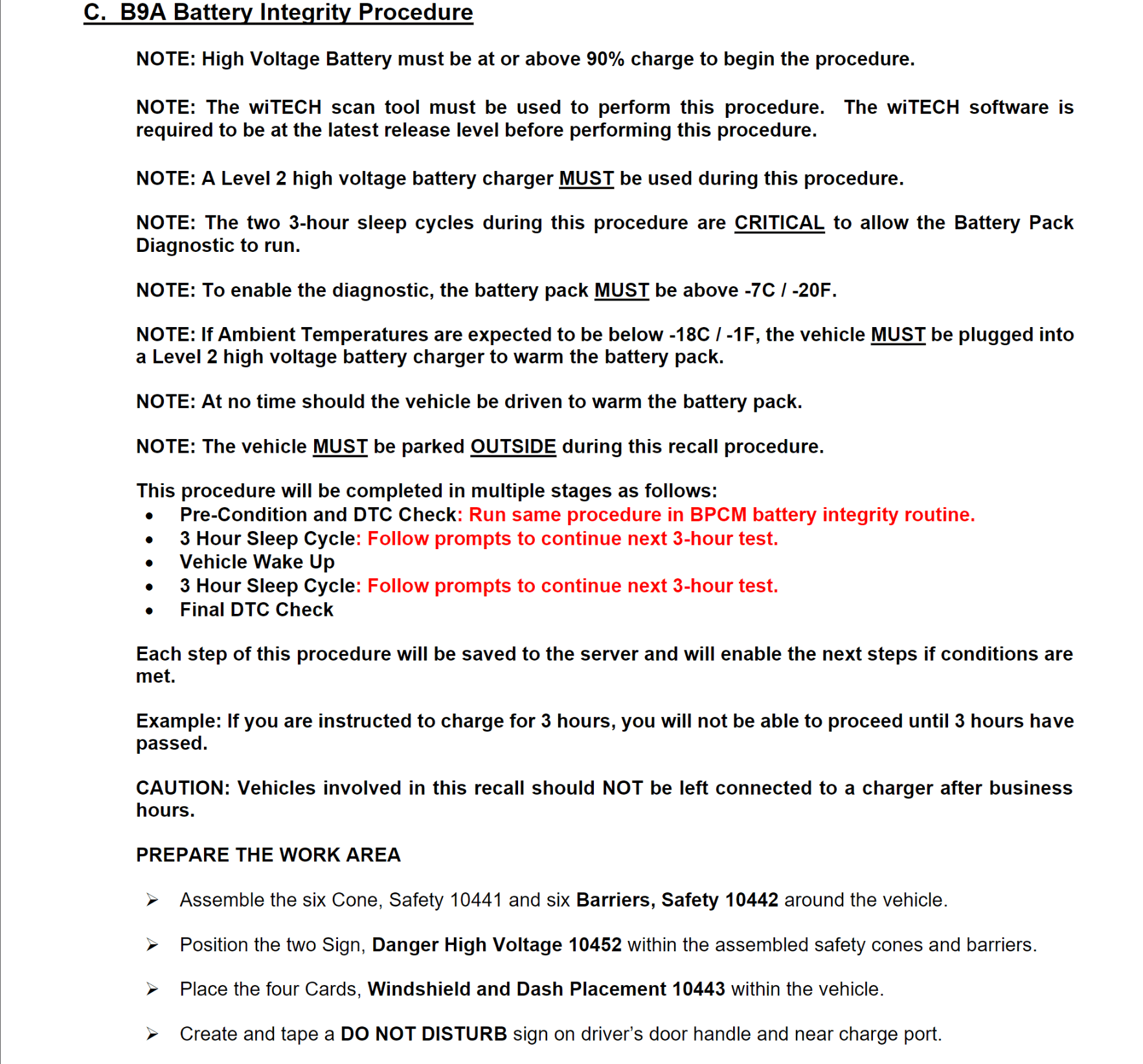

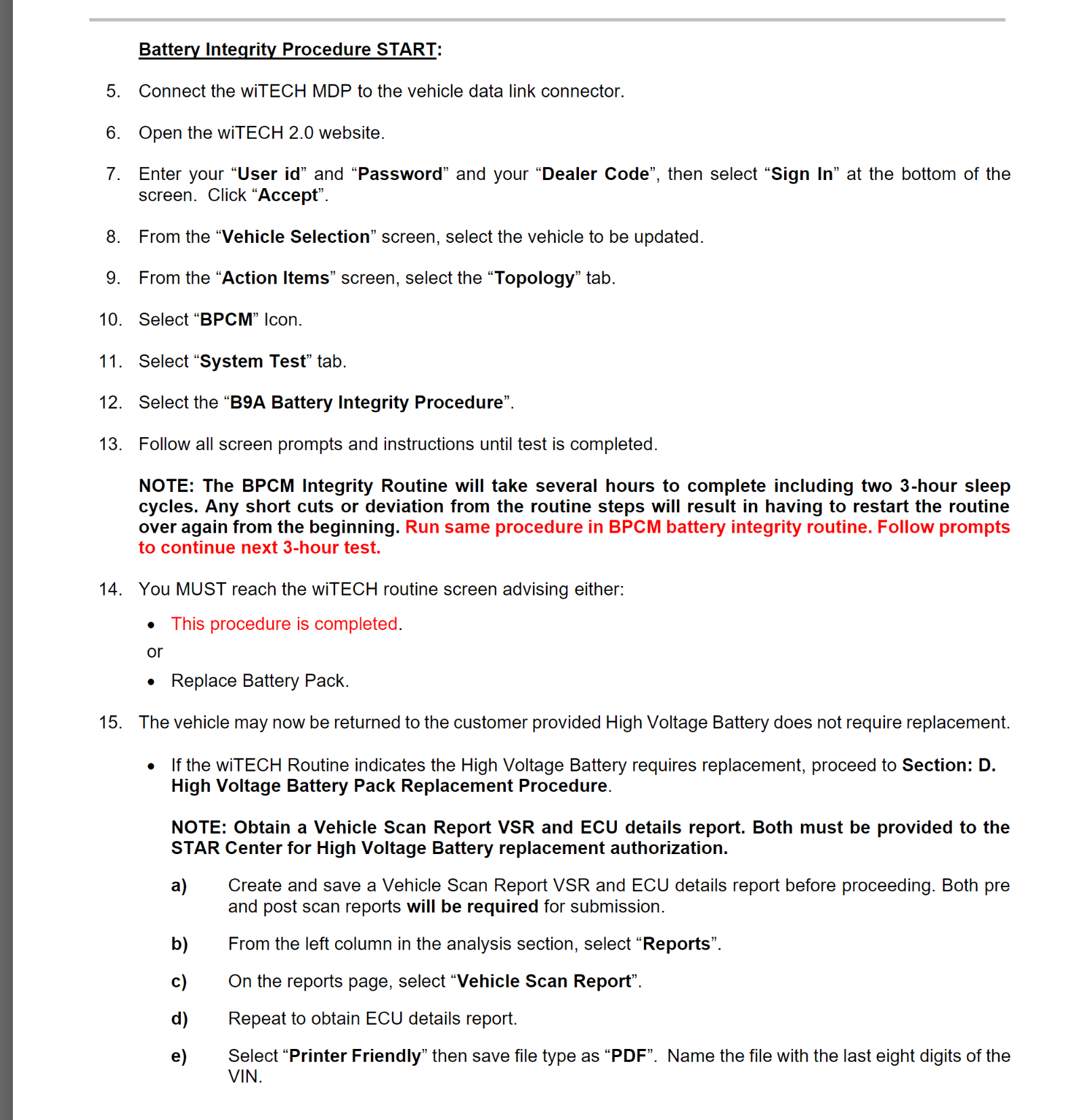

The procedure has already been stated in this thread.
1. Flash the BPCM, AHCP, and HCP. Update PCM/TCM/IDCM if also available.
2. Make sure the battery is above 90% SoC, if not, charge it until it is
3. Perform a battery integrity test using wi-tech
4. Let vehicle sit for 3 hours plugged into the charger
5. Performed another battery integrity test using wi-tech
6. Let vehicle sit for another 3 hours plugged into the charger
7. Perform a final battery integrity test, if it passes return vehicle to customer. If it fails, replace HV battery.
If the vehicle is woken up such as the door opening, charger being disconnected, etc, then the 3 hour wait time part will need to be repeated. As simple as some random person walking up and putting their hand on the door handle, activating the passive entry system even though the vehicle is locked, is considered a wake up and will cause the procedure to fail and require repeating.
The procedure has not changed. If you are getting your vehicle back in under 6 hours then the modules were most likely updated and the battery integrity portion was not completed. If you brought your vehicle in fully charged then in absolute best case it should take six and half hours to complete. If the vehicle was returned with less than 90% charge then the recall was also not performed unless the vehicle needed other repairs which resulted in a discharged battery, such as a road noise complaint that required test driving.
If you dropped your vehicle off only for the recall, and you got it back with less than you brought it in with, then by default you should assume the recall has not been properly performed.
I'll state this once more; this recall pays the technician on average 0.6 hours of labor perform and most will take roughly 9 hours of actual time to complete. I would wager the vast majority of 4XEs will not have this recall performed properly due to insufficient labor time allotted by Stellantis.

I sometimes forget they expect you to create a "safety area" around every hybrid the comes into the shop with warning cones and everything whenever the hybrid system needs to be worked on. They don't pay for that.
Jeep Wrangler JL B9A recall is available! 1709803857556
I do want to note that I've yet to do one of these recalls yet myself, so it's possible the information in the recall document is not completely up to date.
