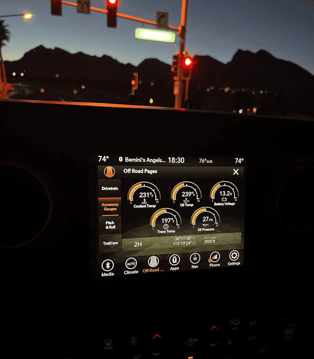

You are welcome!
241F is the highest I see (quite regularly) on driving uphill in high 70s or low 80s outside temperature in my Wrangler. But on my previous Gladiator Rubicon last year, I touched 245F+ in Red Rock Canyon hills.
As long as you did not get a warning come on display (hot oil or coolant temp warning), don't worry. The Jeep will warn you with a chime if you reach or exceed unsafe temps.
Since we are using synthetic engine oil, I won't worry too much on oil temps close to 250F specially if you did not see a warning chime come on the dashboard display.
This is from a short drive on Summerlin Parkway I took a pic last fall which is my daily commute.
Jeep Wrangler JL Average coolant temp 1688344235898

That 239 degree oil temp on Summerlin is pretty surprising. Since it is your daily commute, is this something you noticed on a regular basis or was it just an isolated incident? If the latter, why do you think it occurred?

I have my AC/Climate set on auto for 74F or 75F. When ambient temp is in the 70s or low 80s, I see oil temps regularly around 235F in that ambient temp range. When ambient temps are lower than what is set on my auto settings, some of the engine heat is transferred to the cabin and cooler temps outside also cools the engine and coolant. When ambient temps are much higher than the set 74/75F for the cabin, then the A/C is running most of the time, and hence the fan is also running.
It is when the ambient temp is close to the desired like in the 70sF, then neither the A/C is running nor is engine heat transferred into the cabin. It is at this outside temp when I consistently have oil temp easily shoot up to 230s.

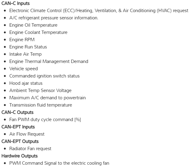

I was concerned about this and I got it checked at the dealership. They said it is normal and gave me a print out on when the fan kicks in. It is a pretty complex algorithm the computer uses. I don't have that print out in digital format but it was the same as posted by one of the posters on one of the temp threads in this forum. Here's the link.
https://www.jlwranglerforums.com/fo...the-normal-operating-temp.71287/#post-1754066
Jeep Wrangler JL Average coolant temp 1688369391547
