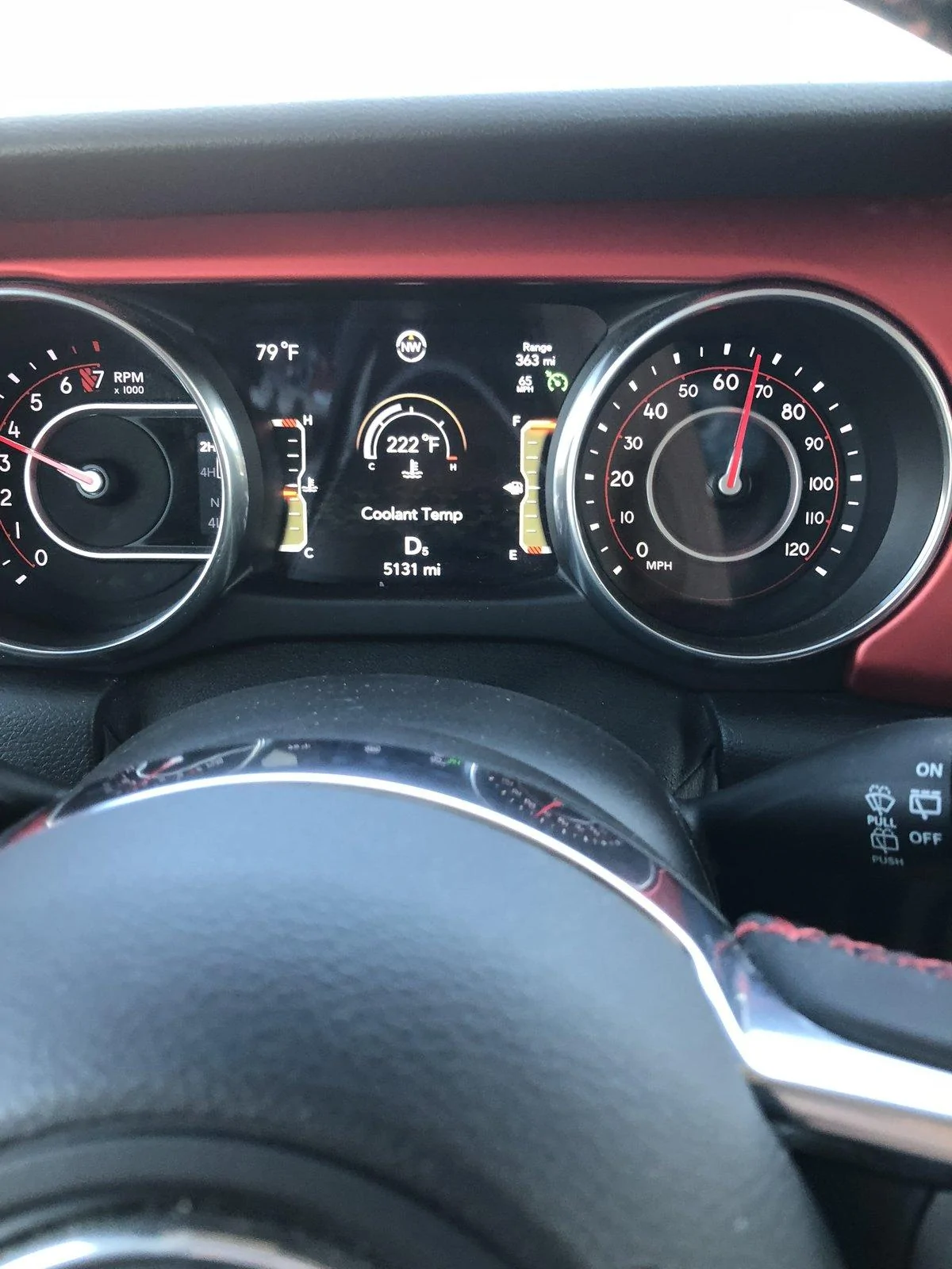

The temperature bar graph on the instrument cluster does not seem to match the reading on the Information Pages on the cluster. My bar graph will be just below the half way point when the information page is reading 194* degrees. After climbing a grade the pointer of the bar graph does not move, however the temp on the information page shows 222* degrees.
Has anybody else noticed this discrepancy between the bar graph and the Information page reading? Is 222* high when climbing grades?

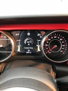

Here is a picture when the coolant temperature bar graph gauge was in the same position, however the coolant temperature was 30* cooler according to the Information Pages.

It's pretty typical for modern vehicles to have an unmoving coolant temp gauge as long as the vehicle is operating within an expected range of operation.The manufacturers do this to keep from getting "False Alarms" from people trying to judge whether their car is actually running a little hot when the gauge creeps slightly above the center line. In this day of J.D. Power Quality ratings, having someone think their Jeep is overheating when they climb a long grade can hurt their perceived quality. Not saying it's necessarily the right thing for them to do, but that's the reality of it.
220 degrees should fall within the normal operating range of most modern V6 engines.
Mine gets to 226 around town with the air on low. Its gotten to 232 climbing grades with the air off. I keep seeing posts talking about the "loud" engine fan but I have yet to hear mine, starting to wonder if my fan is even working. Does anyone know at what temp the "loud" fan kicks on? What temp is considered HOT enough to worry about overheating?

It will increase when you increase the A/C fan in the cab. A stupid way of doing it. Needs to be off coolant temp only. Sure someone will make a kit or add to the Tazer
Mine (2018 JLU Rubi 6sp) shows same behavior, first really noticed a couple weeks ago crossing the Mojave.
I see the analog displays (bar and arc) both move during transition from cold start to "normal". Then no analog display changes from ~ 190 to ~ 230.
Maybe this is a modern analog equivalent of an idiot light--I guess it will only rise into top half of range when the engine is REALLY HOT [?]. Disappointing since I'd hope an analog gage would display true even if some drivers fuss and worry.
