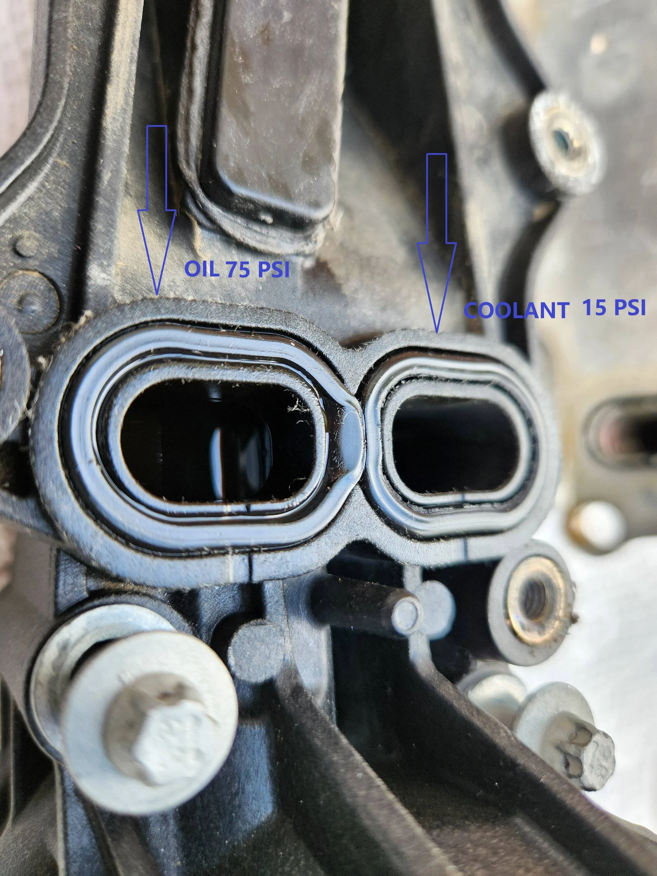

Mine was consuming coolant. Did an oil analysis and found coolant in the oil.
Took it apart and found the seals on the oil cooler were blown between the oil passages and the coolant passages.
More detail here OEM or Dorman Oil Filter Housing? | Jeep Wrangler Forums (JL / JLU) -- Rubicon, 4xe, 392, Sahara, Sport - JLwranglerforums.com

Regarding coolant pressure, I was just generalizing to give the concept of a low pressure vs the high oil pressure. Your pressure figure is more accurate.
Do an oil analysis to verify you have no coolant in your oil. If you continue to dilute the oil with coolant, it will do bad things to it. Rockers and cams are conceivably connected to this.
