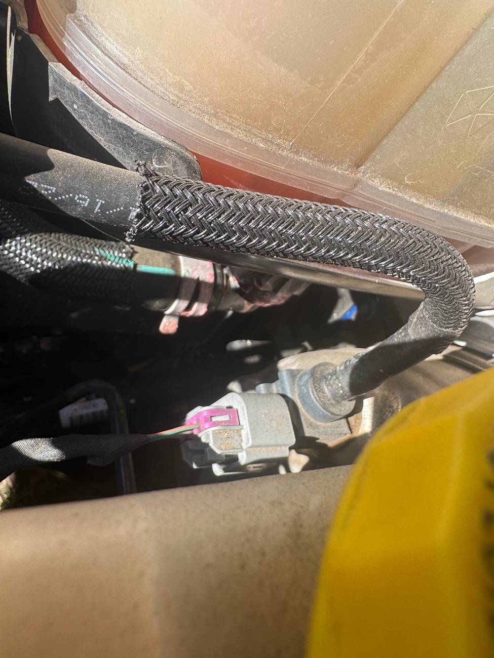

I'm taking it to the dealer Friday - I topped off the coolant back in Feb, and it is below the minimum again. I noticed what looks like coolant residue on the connector under the bottle and on the steering column direct under the bottle. If it is leaking I'm expecting it to be replaced under warranty

Dealer confirm coolant reservoir is bad and ordered a replacement. Bringing in next week for the swap out
I had to have mine replace also. Seems to be a problem with new Jeeps.

It's not just Jeeps, I had to do one on our Escape as well:)
I wonder if it's the same vendor or the same attachment method. The engineers (I apologize for being an engineer) may have tried to save weight or manufacturing costs.

Thankfully my leak is very minor. A few dried drips of coolant under the reservoir , visible on the hose clamp
It’s every manufacturer. These quick connect fittings are terrible. I blame the Europeans for starting this design.
