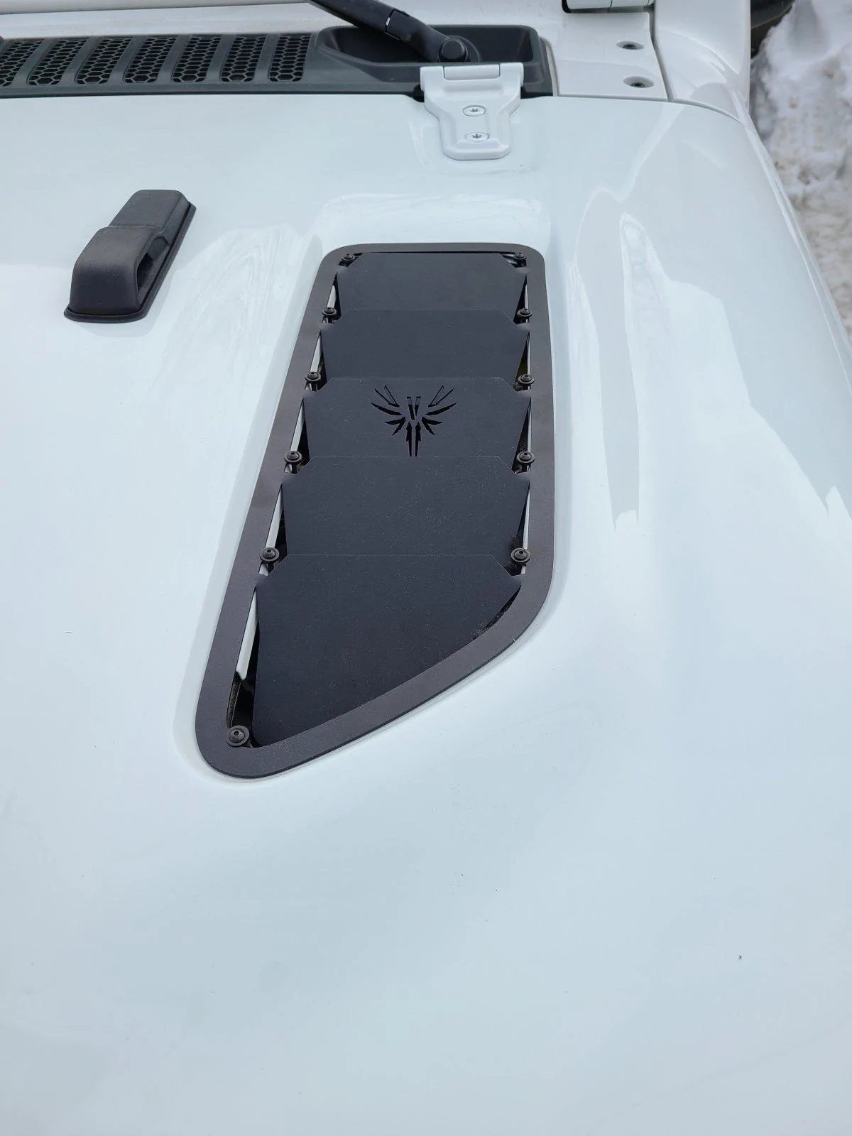

Here is another functional hood vent option from Valkyrie.....
Valkyrie Hood Vents
