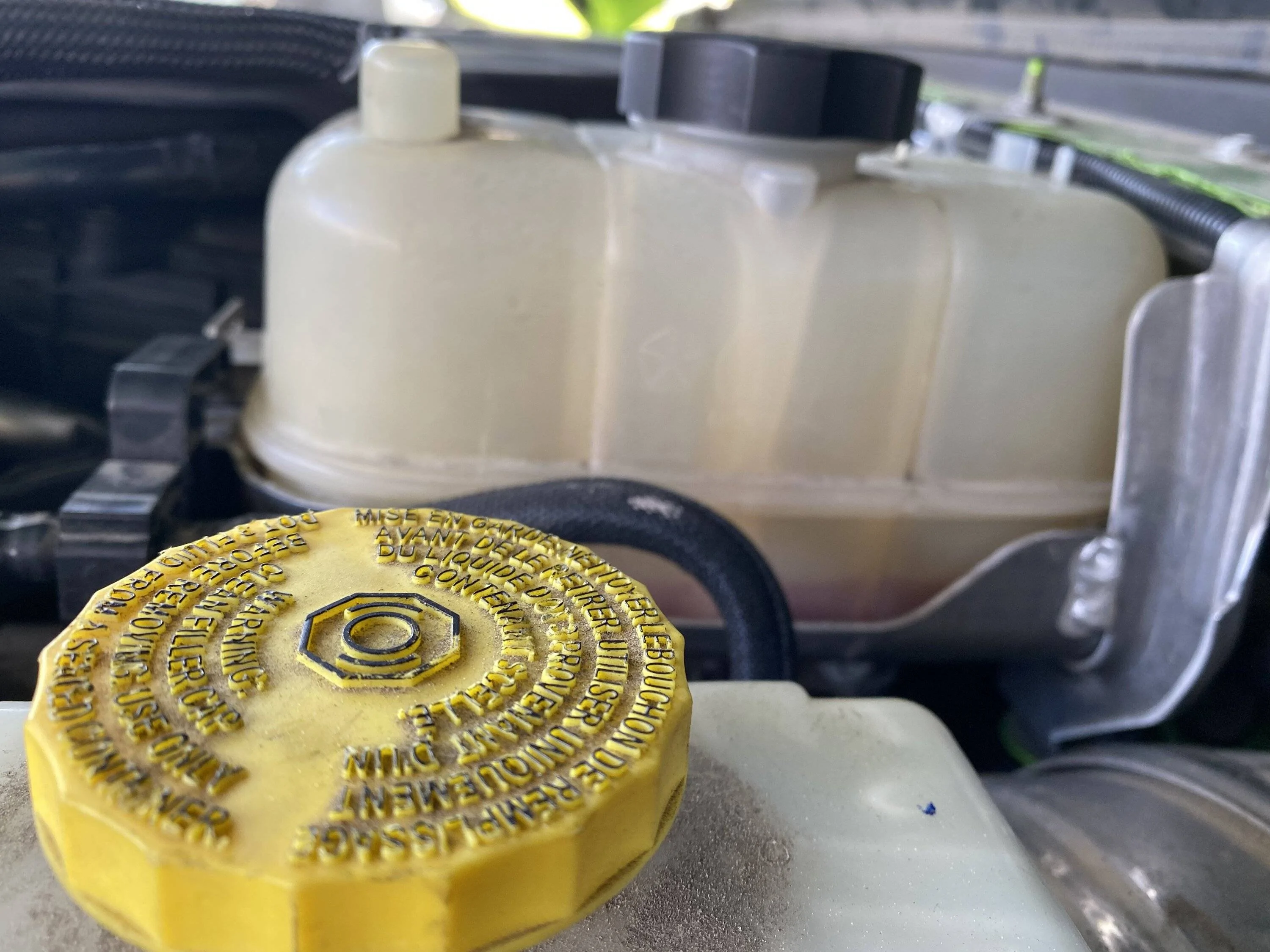

I'd hold off and buy the fluid say at Amazon. Local Jeep place will charge to much for the same fluid you can get in a couple of days from Amazon.
https://www.amazon.com/gp/product/B017DP43ZC/ref=ppx_yo_dt_b_search_asin_title?ie=UTF8&psc=1
IF, you have never added coolant that level is probably just a refection of such.... nothing wrong, you just haven't added fluid over the last 3 years. 8-)
Around the reservoir, look for pinkish dried mist.. look at seams and at connection points. In the pic all looks aok..
CURIOUS ..... what is the deal with the clack zip ties on the reservoir. They are not factory.

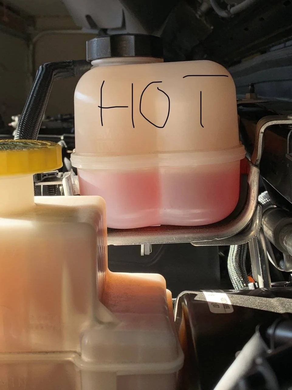

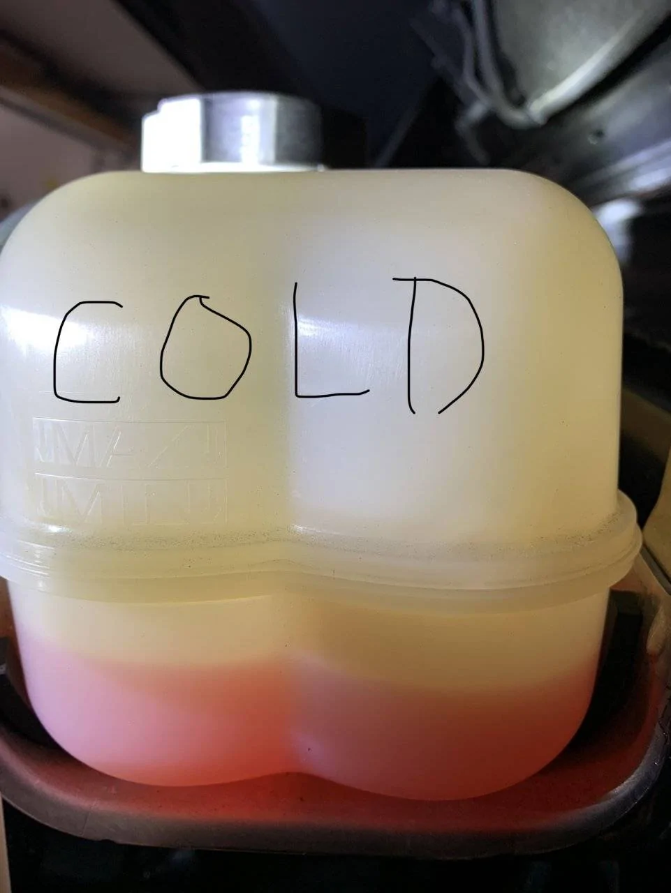

Just bought this using your link...thank you! ?? I just had an engine replacement (last week) with my jeep and popped the hood tonight to see that the coolant level is at minimum level while Jeep is hot ( coolant temp while in operation: 185F-221F). I’m assuming it will be lower in the morning after it has cooled.
Wondering if they topped it off within spec or if it’s low lol…

Just bought this using your link...thank you! ?? I just had an engine replacement (last week) with my jeep and popped the hood tonight to see that the coolant level is at minimum level while Jeep is hot ( collant temp while in operation: 185F-221F). I’m assuming it will be lower in the morning after it has cooled.
Great thread btw ?
@TaiMc
About that MIN level line you see on the reservoir itself ...... place a bright flashlight beam on that area and you will see an raised arrow on each side of the word MIN. One arrow points to the max line and the other to the min. line.
When the vehicle is cold, the fluid should be halfway between the min and max lines.

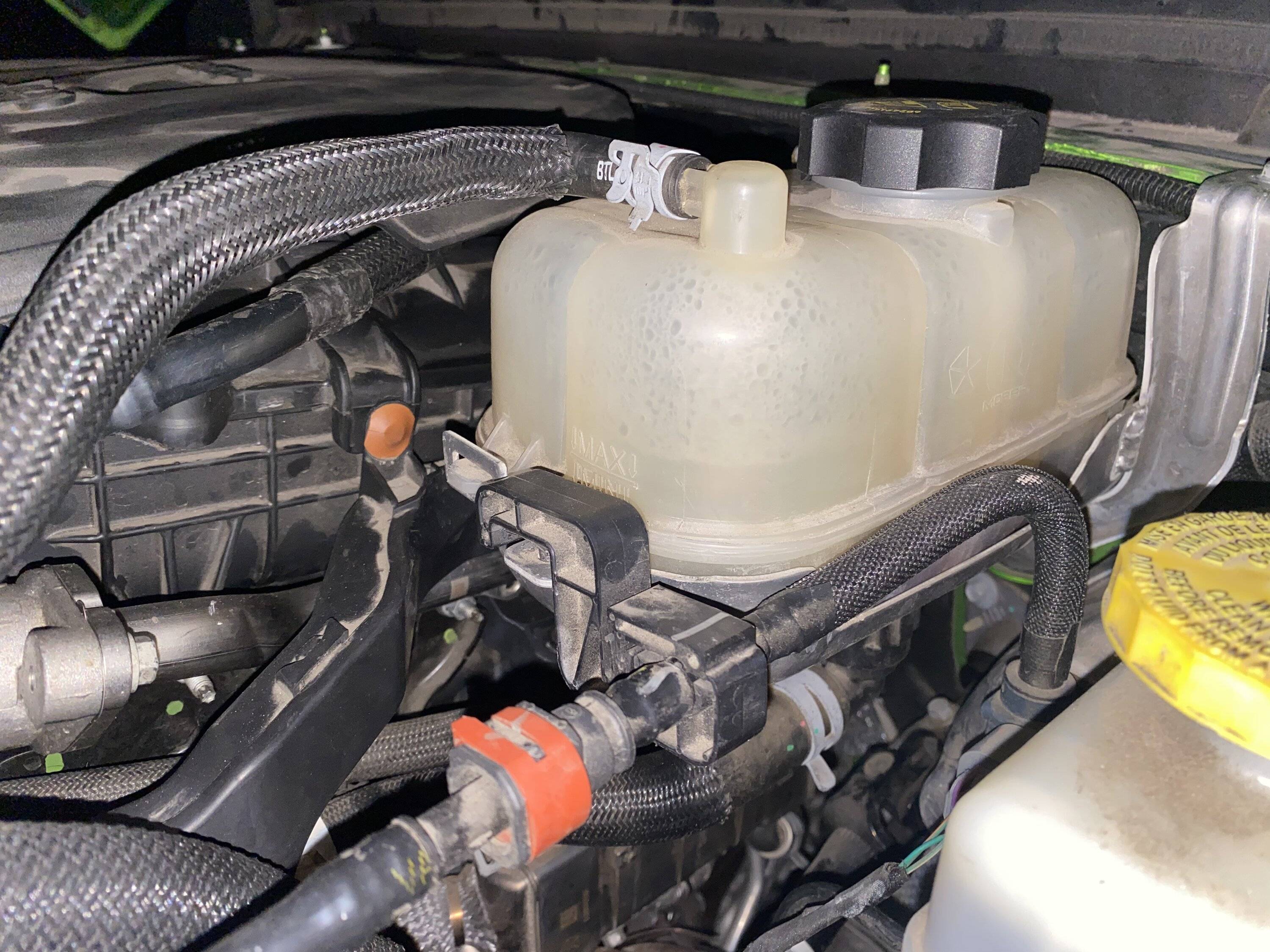

It was low when I checked today. I added some coolant to the minimum line (where the joint is on the reservoir).

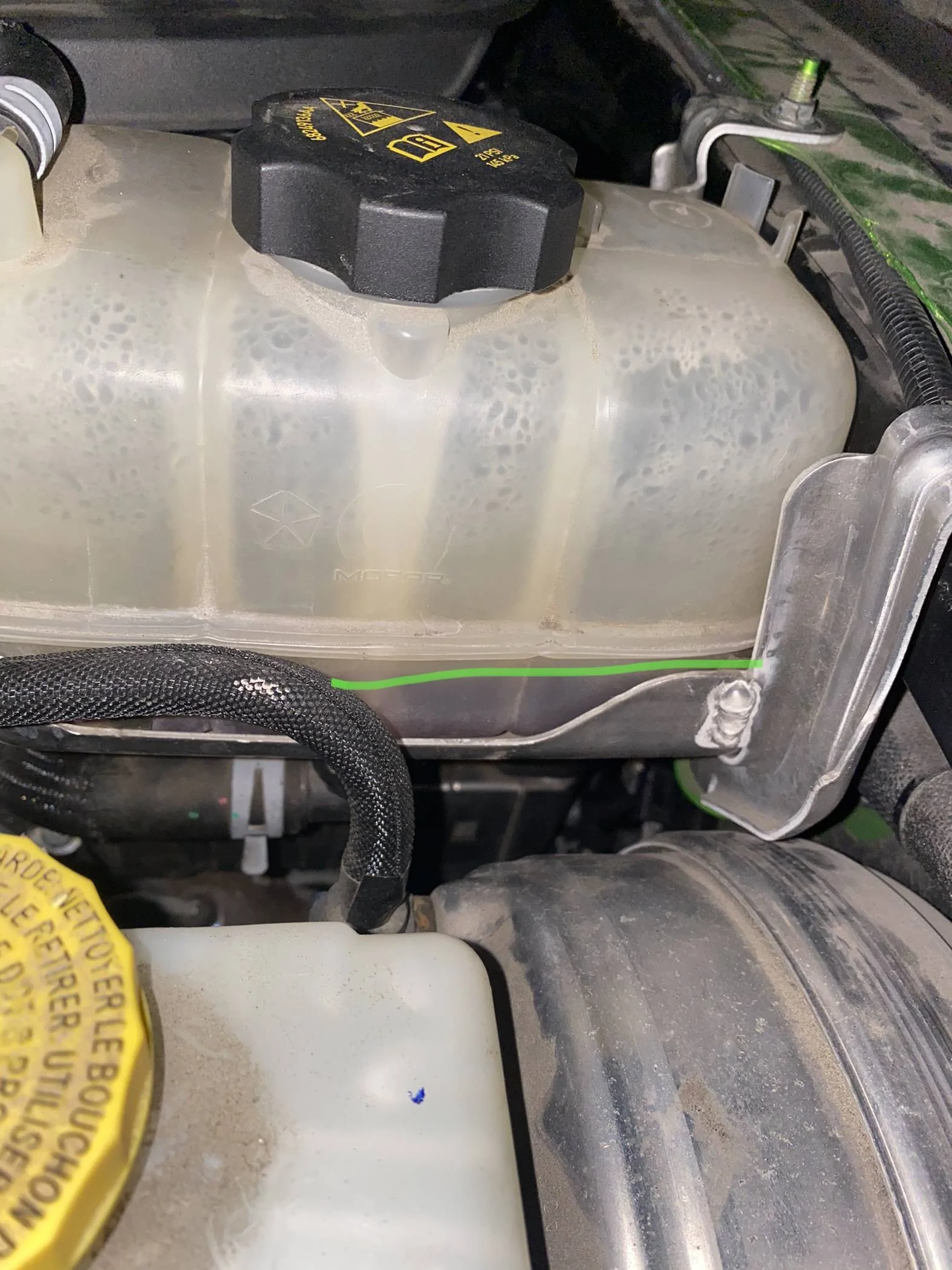

Checked mine at 8K miles. Do you guys think I should top off? To the joint line or right below the MAX down arrow?
Yes, you need to add coolant. Do that when the JL is cold.... Read earlier posts in this thread regarding proper fill level when vehicle is cold.

Thank you! I’ve gone through the thread and educated myself. Will top off to the seam line to MIN level since it’s cold here in PA. The level may go up when it’s warmer outside and I’ll also monitor before another top off. Will buy the 50/50 Prediluted from Amazon as you had suggested.

@Rhinebeck01 so I added the coolant when the engine was COLD yesterday, maybe slightly above the seam line but still right below the MIN down arrow tip (garage floor is not super flat). This morning after driving 15 miles I checked the level again right after shutting down the engine. And the level is over the MAX down arrow, almost to the upper edge. Do you think I should pump some out and keep the level right below the down arrow when engine HOT? There's still room for expansion if it gets hotter.
Either my OCD or I worry about too much...
@Fast-n-Furious
You said the engine was "COLD" and you filled it to at, or close to the Min level.
With that said, I'd just leave it be..
It's normal to see that coolant fluid level go up when the vehicle is warming up/warm/hot.
As the vehicle cools down the coolant level in the reservoir drops.
Do routinely check the fluid level in the reservoir when the vehicle is cold. Add fluid as necessary when the vehicle is cold..,

Yes, after my rig parked for 5 hours, the coolant level was 1/2" below the seam line. And that's when I added the coolant to the seam line maybe a bit higher, but still below the MIN down arrow tip.
The only reason I was thinking about pumping some out to keep the level right at the MAX down arrow tip when the engine is HOT is just to have a perfect level, my OCD at the same time. And I'm afraid the coolant may overflow since it's almost at the TOP of the MAX mark when I checked HOT. And possibly mess up the engine bay. I guess this won't happen? I tent to overthink many things...
I'd just leave it and only check the level after the Jeep has sat over night. I wouldn't consider checking it after the engine has stopped running for some hours. That might not be a "cold" status.
Let it sit over night, then pop the hood the next day and check your level. That level will be an authentic cold level which is what the reservoir levels are an indication for. If the cold level is over the max line after it has sat over night, then you have overfilled it.
Others can chime in about whether or not that's a major problem.
