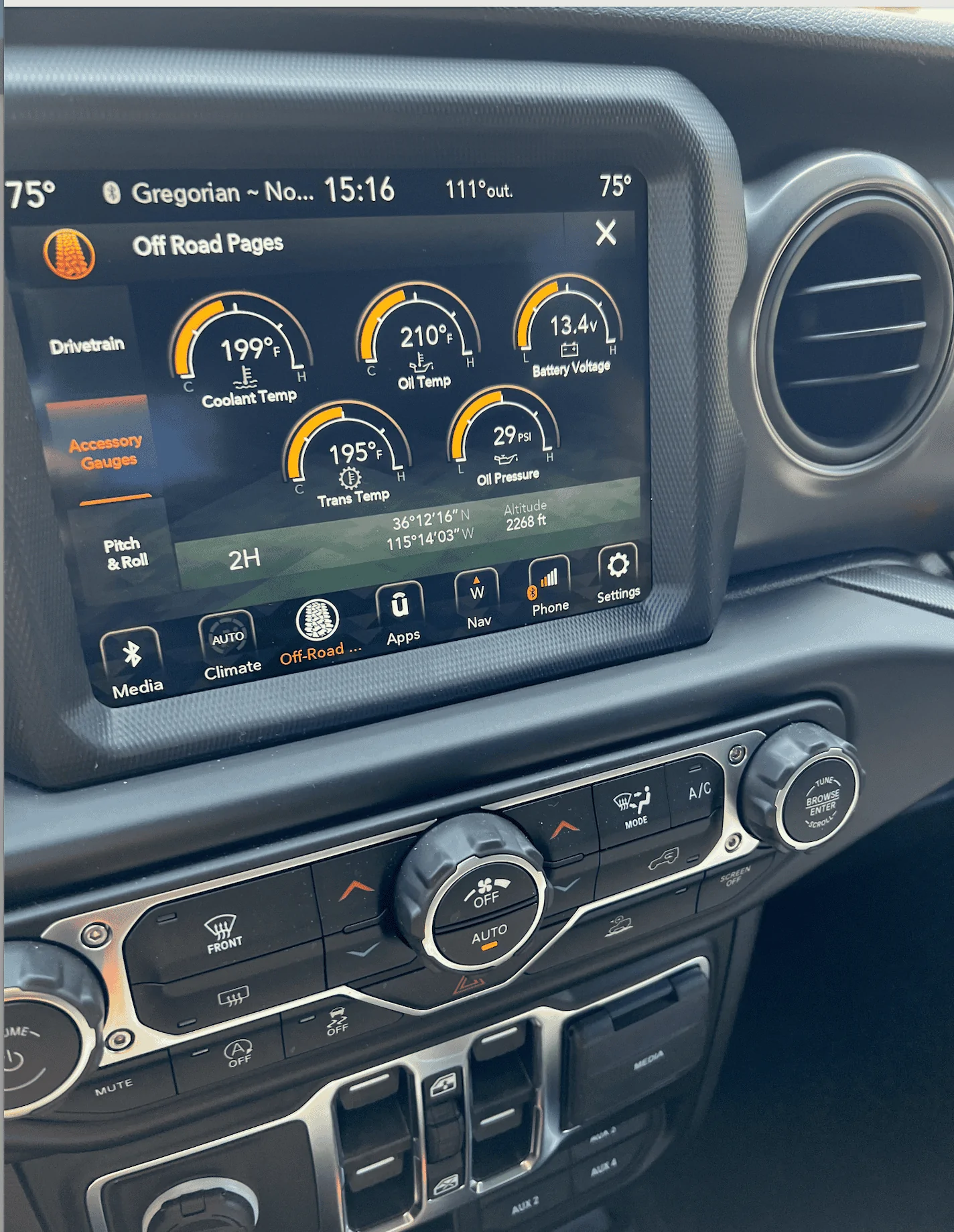

In 111F temps yesterday in Vegas coming back after a 15 mile drive on streets and hway:
In 75F outside temp, I see coolant and oil temps get to 230F+. On 111F outside temp, coolant temps struggle to exceed 200F. :)

Because you underuse the A/C. This is exactly what I keep saying.

Yep, the algorithm on when and how long the fan stays on + the speed of the fan is heavily weighted towards A/C usage.
