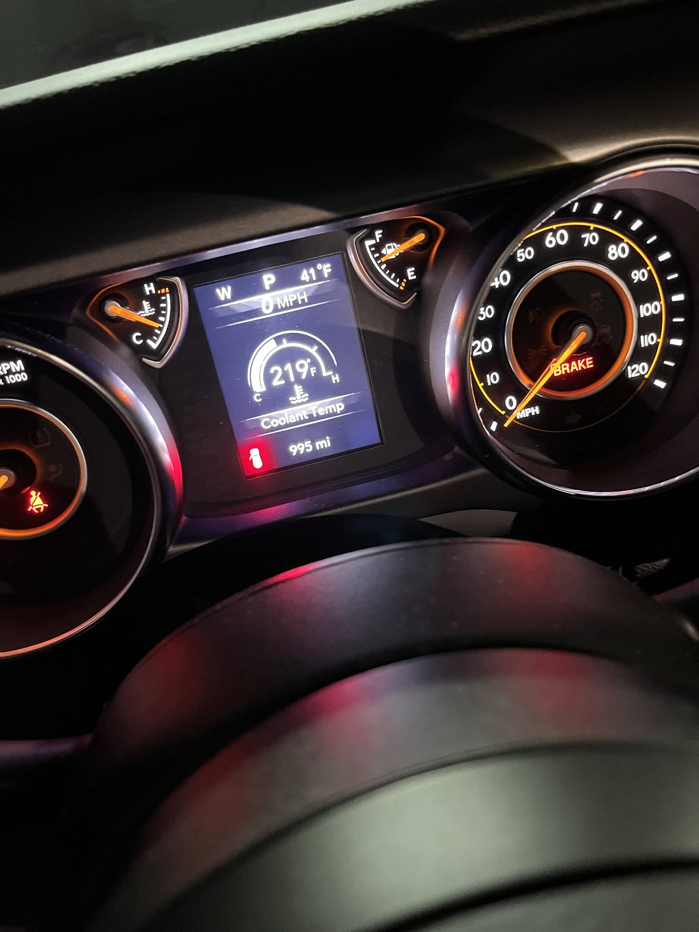

So this is normal temp idling in a driveway on a cool day?
Jeep Wrangler JL Extremely high oil & Coolant temp? IMG_1880

I don’t really hear a fan whether AC is on or off. AC blows cold, however.
It should turn on regardless of temperature. The fan will operate at slow speed, you can take a look under the hood to verify.
verified that fan is running on what appears to be low / quiet with AC on.
today was the first “warm” day at 45F, so I wonder if I’m just running the heat less and noticing higher engine temps as a result. Since buying the car a month and a half ago, never saw above 205F so I was surprised to see 219F in driveway.
no need to address with dealer?
thanks for your help!
